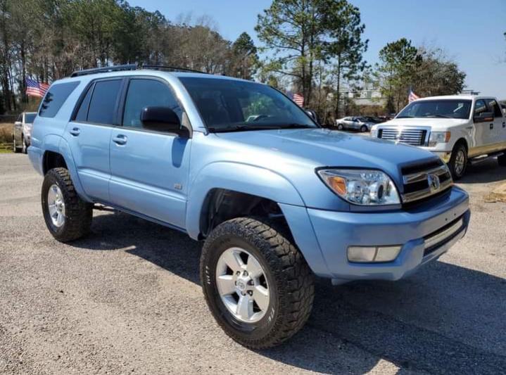

Not mine. He said it was a 3 inch lift on 285/75
it wont let me start a new thread so ill ask on here
Was wondering if this is a factory color.

I do believe this is a factory color. 'pacific blue metallic' i believe
Yes it's a "Toyota" factory color, but don't confuse it with Chevrolet/GMC who also has a "pacific blue metallic" which is much different, and much darker and a different shade of blue.
So if you're trying to find it or touch up paint be sure to specify "Toyota Pacific Blue Metallic"

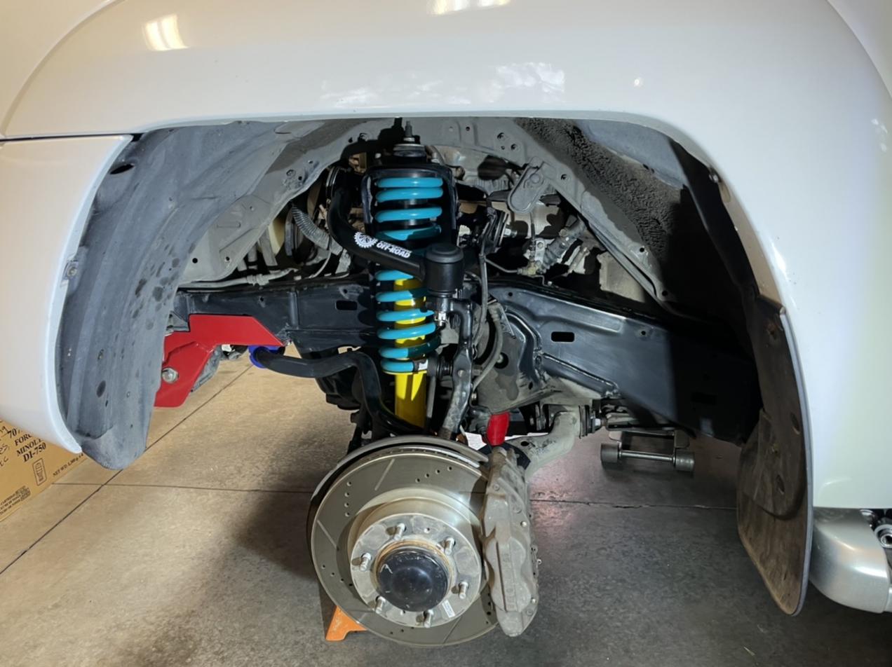

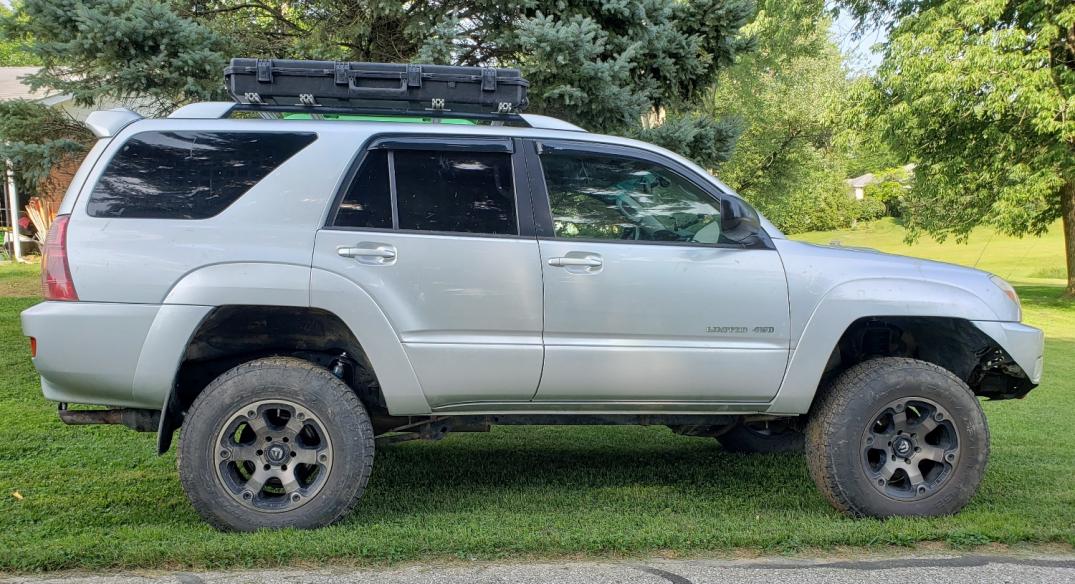

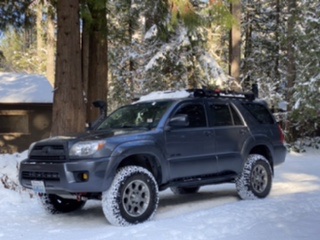

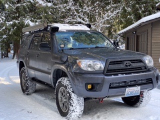

Ironman FCP’s, stock weight front springs, metal tech medium rear coils, .6” rear spacers (Dobinsons), Blackhawk(GXOR edition) UCA’s.

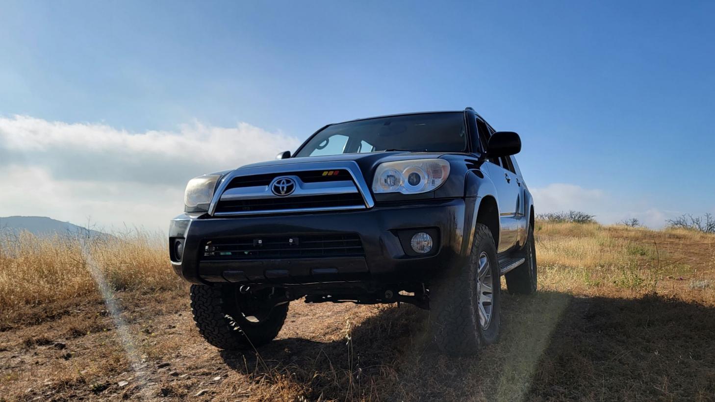

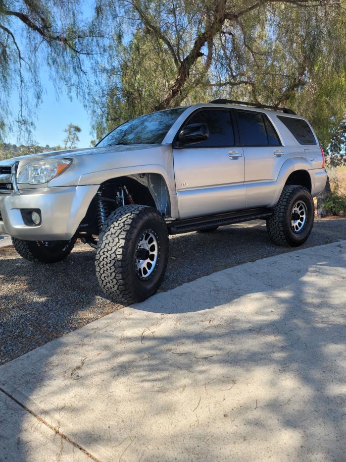

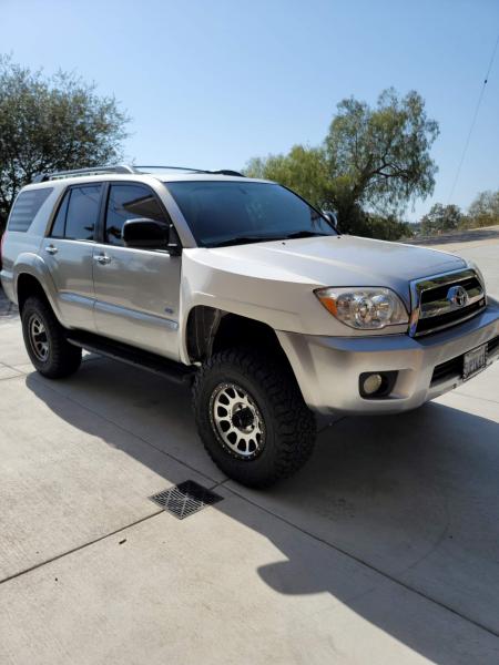

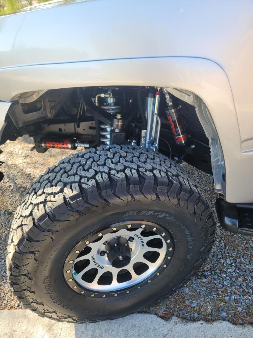

Tire: K02 285/70/17
Wheel: Black Rhino Chamber 17”x8.5 0 offset.
Front: Fox 2.0 Coilovers Adjusted to around 2.5-2.75” lift.
Rear: 2” Icon Rear Coils - Fox 2.0 Remote Res Rear Shocks w/ Icon Coil Conversion kit and MOOG Upper Isolators

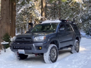

Bilstein 5100
OME 885/895
Bf Goodrich KO2 285/70R17

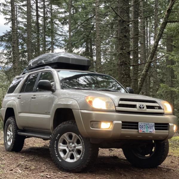

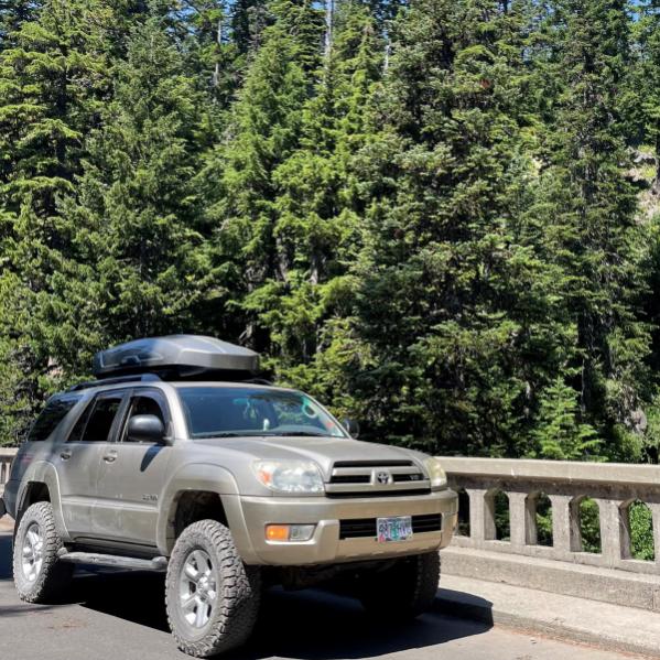

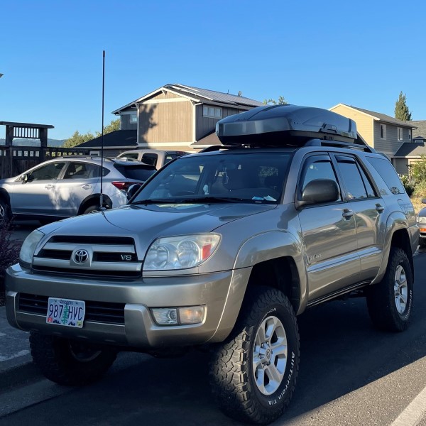

Bilstein 5100s OME 886/896 BFG KO2 285/70/17
03 sr5 v8 4wd
1. Bilstein 5100s with OME lift coils front/rear 886/896 roughly 3" front and 2.5" rear lift.
2. BFG all terrain KO2s 285/70/17 on 2018 4runner wheels
3. Absolutley love the results and would'nt do anything different besides put a bumper on the front with the 886 OME coils, for the cost this lift has been great. I have essentially no rubbing besides the stupid plastic bumper dust guard which I cut off.
