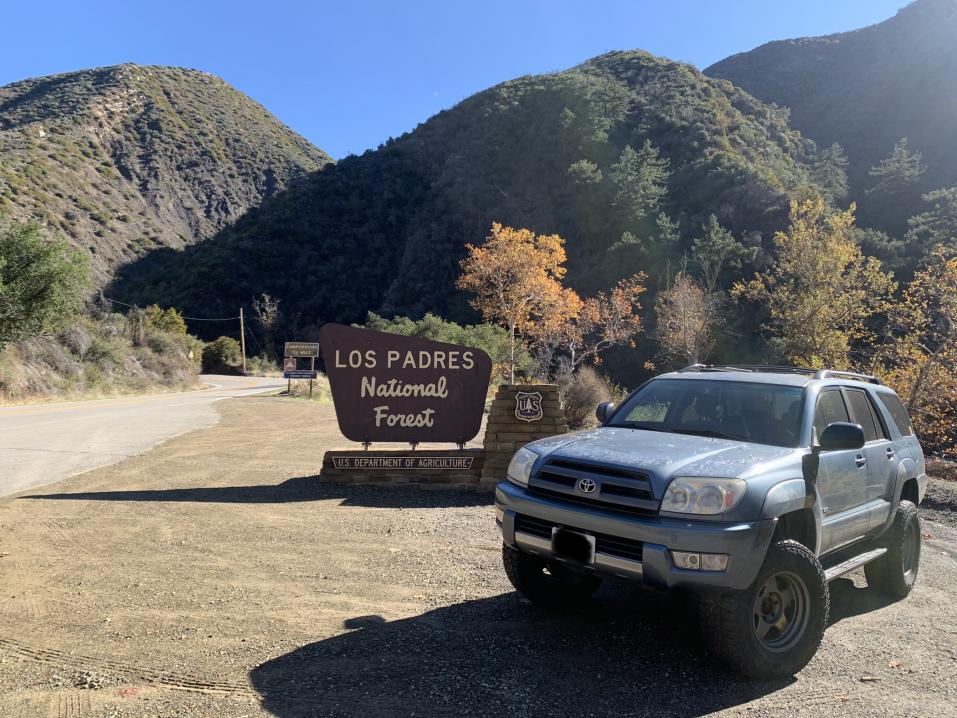

2003 4Runner Limited
--230k miles
--XREAS Delete
--RAS Delete
--Eibach Stage 1 Lift, front struts on the second position
--K02 265/70R17 on SR5 Sport Wheels
--Spidertrax

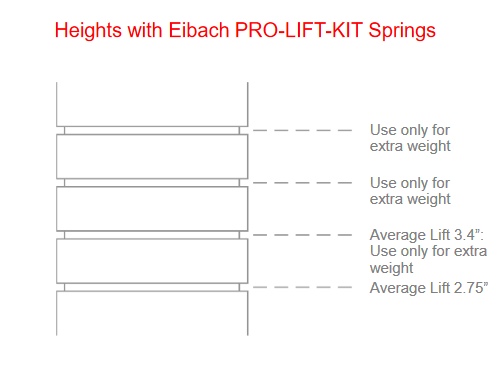

I was looking at the same lift today online. How much lift did you get front and rear? When you say "second position", do you mean the 3.4" slot (and do you have extra weight? I am looking at this for a V6 Limited, so I suppose I should do the 2.75" slot. This is from the install instructions:
I have the V8. I gained about 2.3" in front and a bit over an inch in the back. The V8 is only supposed to lift 1.8" in the first position, so at the second setting, my numbers conveyed almost exactly as advertised. I do not have any extra weight on the vehicle.

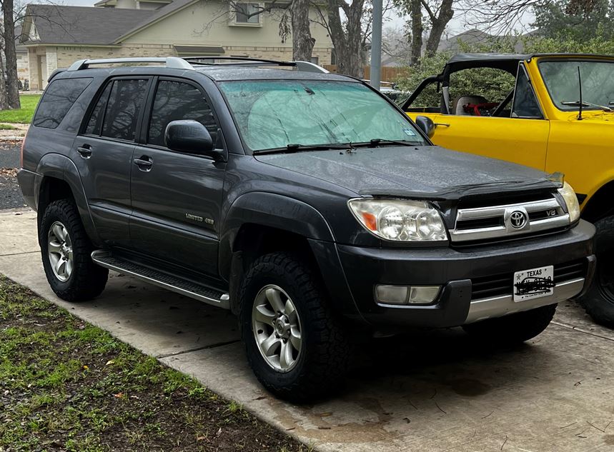

Hey guys, long time lurker, first time poster. I recently inherited my late uncle’s (RIP) 2004 4Runner SR5 2WD and have started mods very quickly with way more to come. Glad to be here.
-OME 2.5 lift kit 885/895
-SCS F5 17x8.5 -10
-Falken Wildpeak AT3 285/70/17
