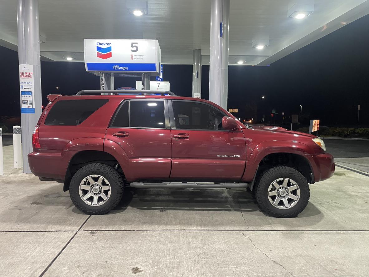

I probably owe this thread a post as I've gained a lot from T4R and this thread specifically.
New setup on an 07 V8 Sport with 265/65/17 Falken Wildpeaks
Bilstein 5100
Dobinson C59-505 Rear Coils (supposedly 1.25-1.5" lift)
Dobinson C59-314 Front V8 Coils (supposedly 2.5" lift)
My shop accidentally notched up the Bilstein's from 0" to the 2nd notch so think 1.5"?
Previously had Bilstein 5100 all around w/ stock coils and had front 5100's notched at 3rd notch (think 2.5"?) which was a nice leveling job (I'm a fan of a touch of the 4runner rake, can't stand reverse rake) and think the shop overdid it with the 1.5" here on the newest setup.
Questions for the forum:
How much settling should I expect out of the front end?
and is a notched @ 1.5" Bilstein + 2.5" coils too much lift for current control arms and diff/axles? Noticed some shudder on acceleration at highway speeds that seemed to moderate after a few drives.

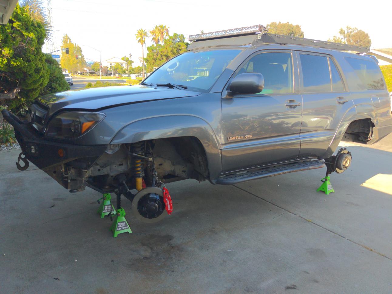

Just finished my lift
ICON Stage 2 Lift w/ SPC UCA's, Metaltech rear bump extensions, Metaltech rear LCAs and UCAs, and removal of front sway bar
There's so much info on how to fit 35s on here. I've already done my BMC and am going to do some pinch weld hammering and more trimming, but i'm still getting gun shy and thinking of going with 285/75 Yokohama G0003 MTs. I think I just need to go 35s straight off.
What do you all think?

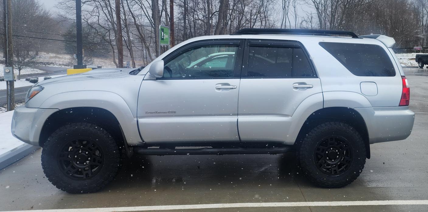

Here is my current combo.....
RC 2.5 lift kit front
Dobinson 1.5 lift rear springs with RC shocks
TRD Style 17x8 matte black wheels
Toyo Open Country RT Trail 275/70R17
OME 886/898 springs 1/4 front poly spacers, bilstein 5100's, rear sway connectors from 2nd gen, only rubs the front mud flaps which I'll take off soon. camber and toe aligned fine with stock uca, loss of caster, but at least tires won't wear unevenly.
If it's over 2.5" you need adjustable uca, to properly align the vehicle or uca that have the camber/caster build into them. I have seen way too many people come into my shop and say they don't need them until we show them why and the damage it is doing
