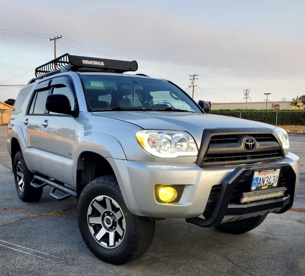

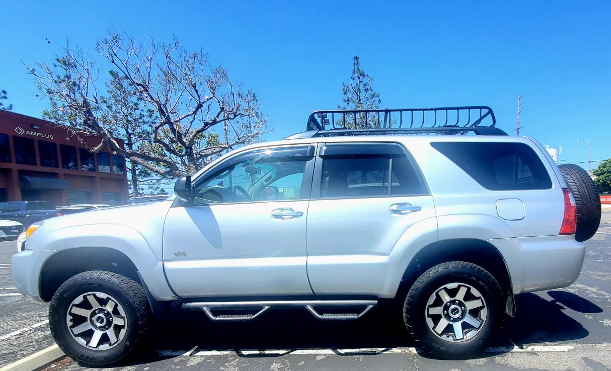

What's good guys , I am a new-b here from So Cal .. I own an 06 V6 4runner I put together with various parts for a budget build all bought off Offerup.. not kidding .. everything from the truck itself, to Toyota 2013 touch screen stereo mod, yakima roof rack , nerf steps, to led headlights and rigid armor swing down tire mount all sourced on offerup.

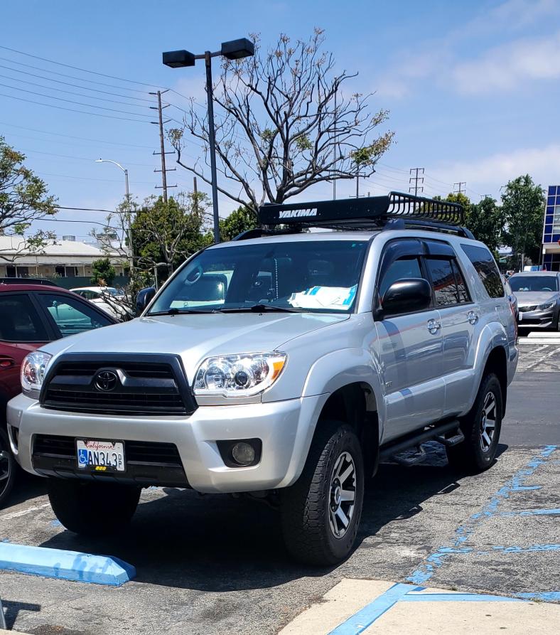

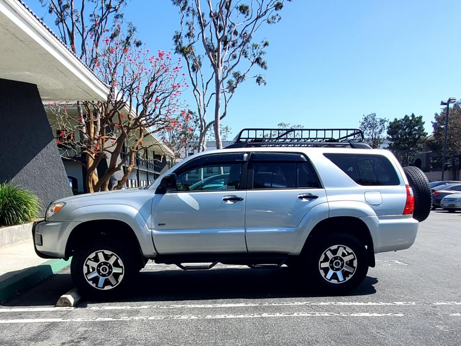

But back to topic... I really like the lift so far but it's bugging me a lil because it's not completely even/level. Here are my current parts and specs;
Front: 4x4 2022 Taco TRD shocks with KSP 1" Leveling kit/spacer
Rear: 4600 bilstein with shock spacer and unknown springs from an 07 FJ "not stock". I think the springs are 1.5" or 2" springs.
After install:
front L/R, 24" from hub to fender.
Rear L/R, 23" from hub to feder
I really want to level the rear to match the front and go bigger on the tires. Anyone have suggestions? I just picked up daystar comfortride 1.5 rear spacer and buddy gave me a set of used 40k miles bilstein 5100 rears with a set of 5100 fronts with arb springs .. fronts need new top hat and top bushings. The rear 5100 shocks are in better shape. I'm thinking of removing 4600 and replacing them with 5100 rears adding the 1.5 daystar rear spacers. Also looking to go bigger tires without cutting or major mods....Any advice/suggestions?? I'm new here so any advise would be helpful

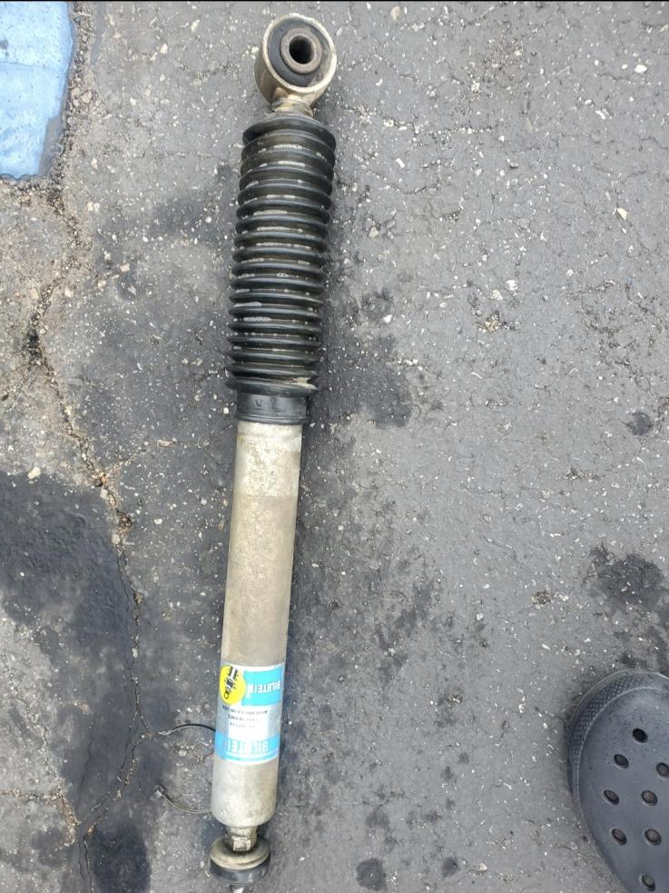

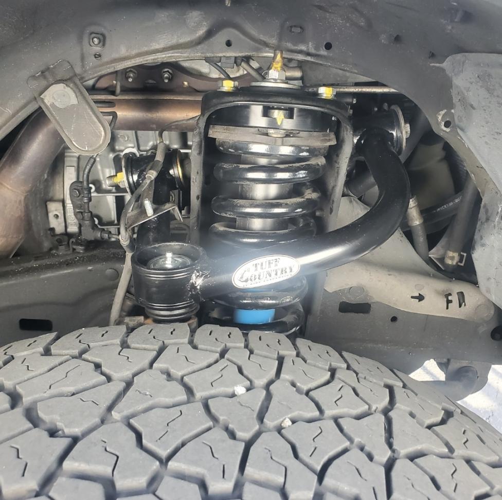

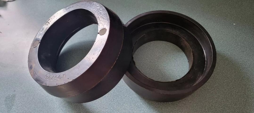

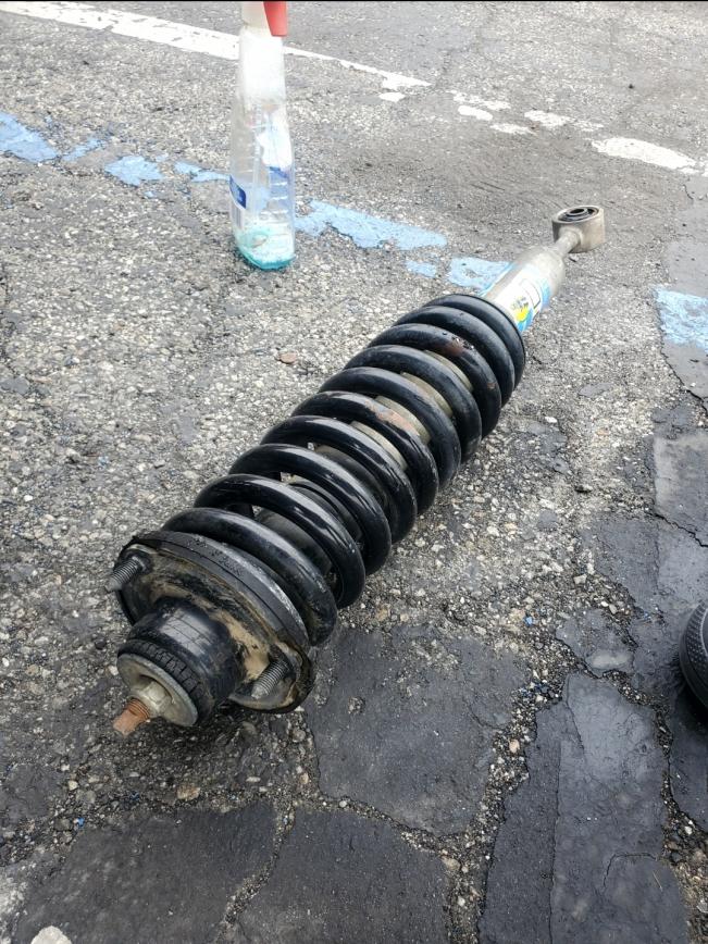

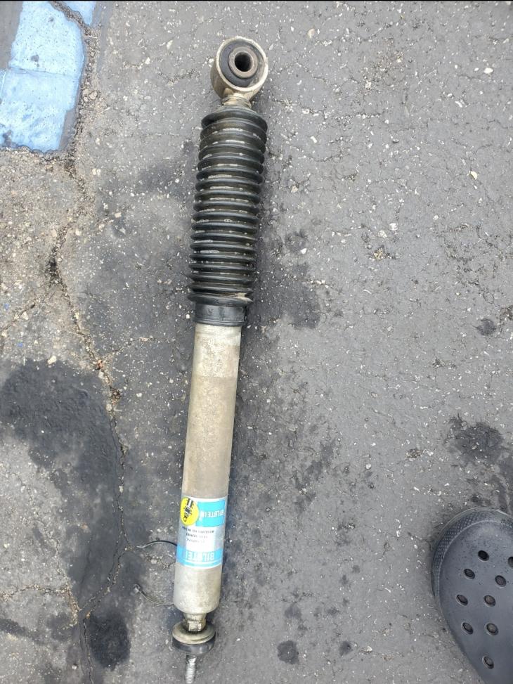

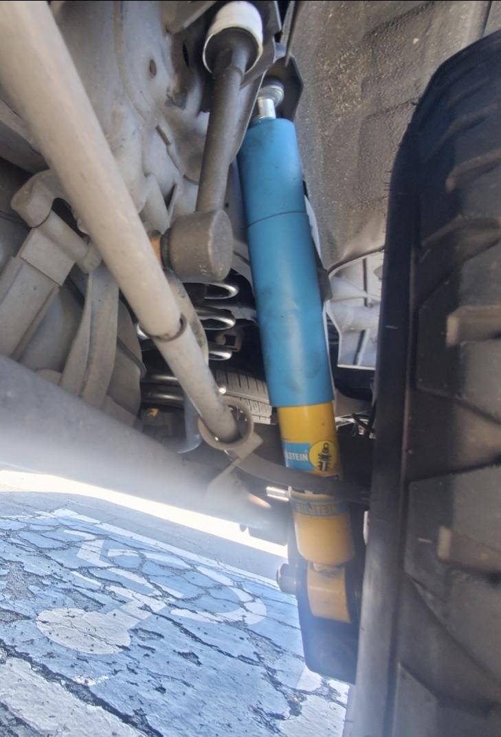

Here are a few pics of my taco fronts with 1" spacer and rear 4600 with shock spacer.. also pics of the front 5100 w/arb coils, rear 5100 and daystar 1.5 spacers i just picked up.. im thinking g of swapping the 5100 rears and adding the daystar spacer to lift the rear .. also last pics are the coils im running .. wasn't sure what brand or lift they had since fam member gave them to me pulled them from his fj he bought.. shop said looked like 2" ..I know it's low budge build but working with what i got till i can get a good setup.. new here so any advice would help

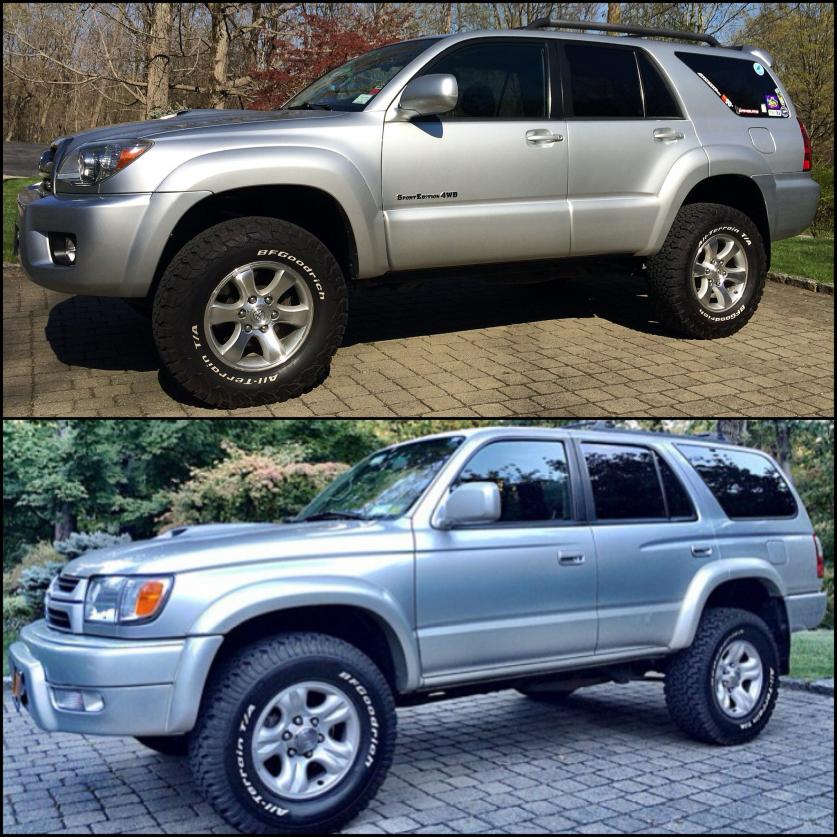

2006 Sport Edition 4.7L V8 4x4 - Old Man Emu - Front: 885/NC Sport Shocks, Rear: 895/NC Sport Shocks - Diff Drop - KO2 275/70r17
2001 Sport Edition 3.4L 4x4 - Old Man Emu 3" Lift w/ Diff Drop - BFG A/T KO 265/75r16

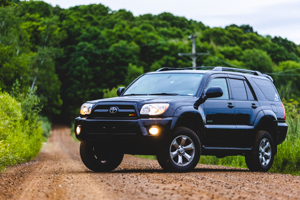

Love the look of yours. My 2007 has 2.3"/2" suspension lift with Bilstein 1500s. I still have the stock tires on as I had to buy tires immediately when I got it 4 years ago and couldn't do a lift yet. Need new tires soon and looking to get 265/70/R17 like you have with replica TRD wheels. I don't want big tires I just want to fill in the lift a little. Those tires ar eonly 1" bigger but hopefully the bigger sidewall going from 18"to 17" helps them look bigger.
