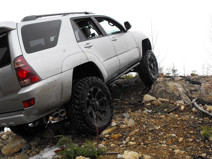

ReadyLift® 69-5060 SST Hybrid Lift Kit
Goodyear DuraTracs 285/70/17
XD Series Endro Matte Black 17"
Amazing set up for Colorado weather and terrain!

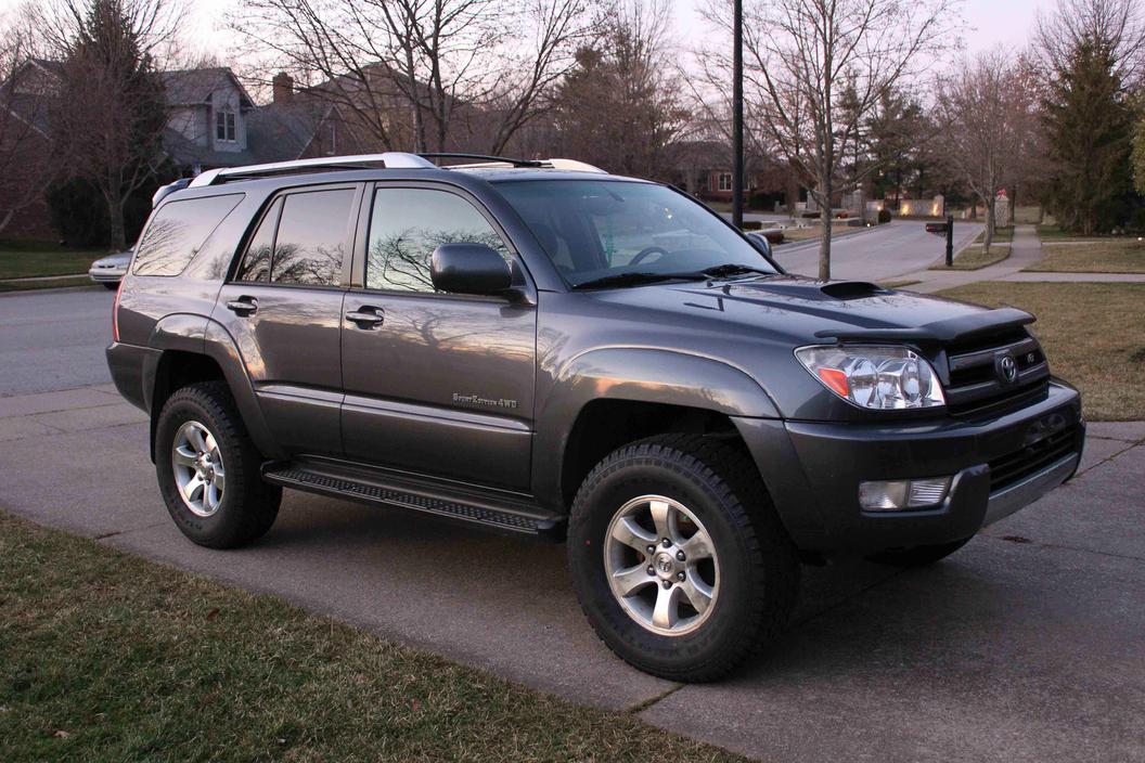

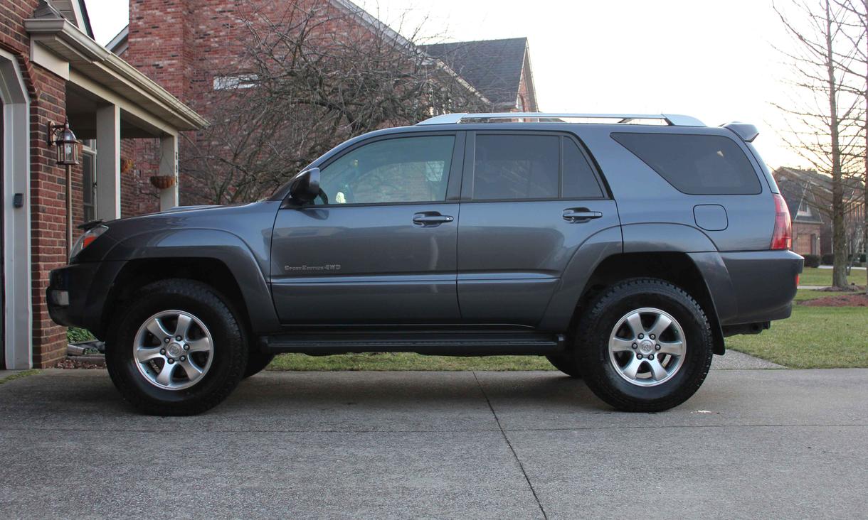

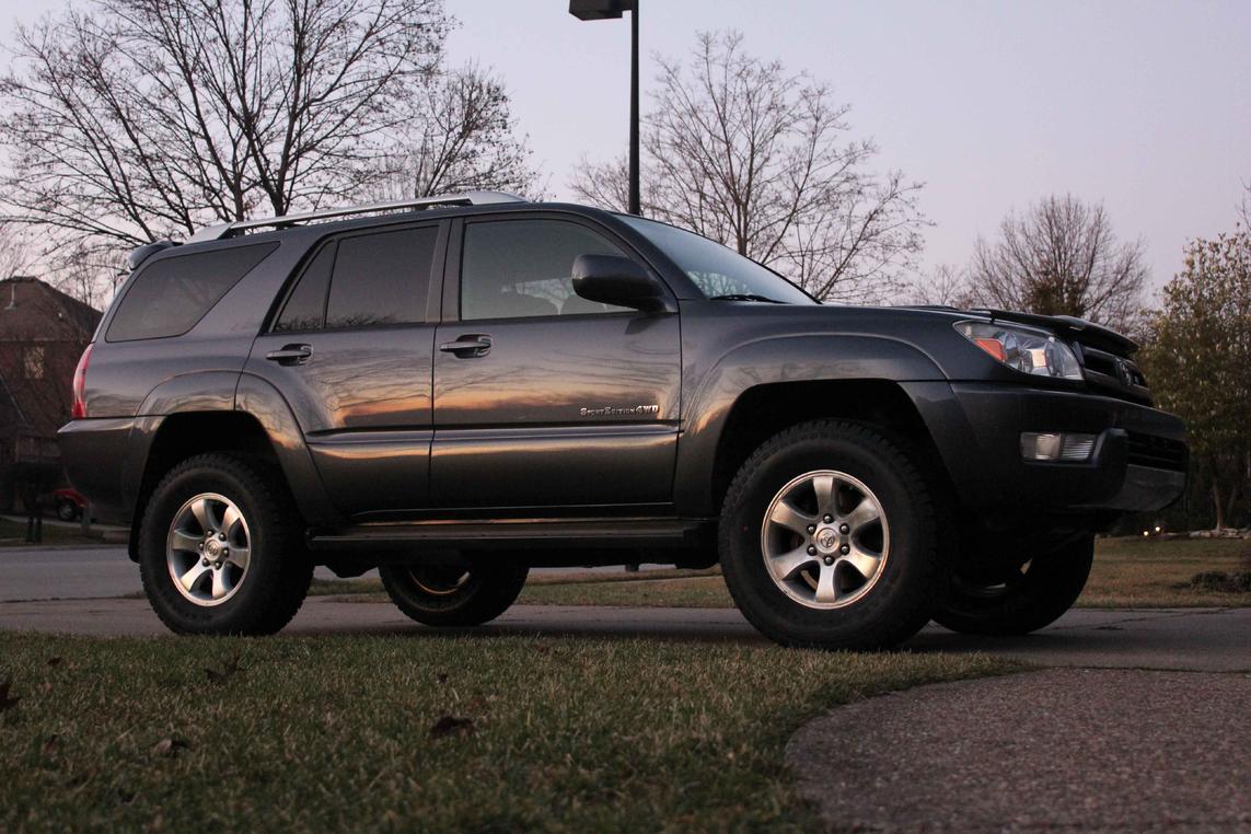

XREAS, Daystar 2.5/1.5, 1" Diff Drop, Spidertraxx 1.25" spacer, Kumho Road Venture AT KL78 285/70R17 117S SL (44lbs). Removed front mud flaps, trimmed some plastic behind mud flap area, ground 1/4" off front right body mount support, and moved front left wheel well plastic forward 1.5". No more rubbing!! Could have just installed 1" body lift to stop rubbing though. Maybe later. Rides great, road noise is minimal.

Looks really nice. If you want to keep your front mud flaps on, you can trime the inside of them. I still have mine on with about the inside 1/3 of them trimmed off. Still keeps all the crud off my running boards.
