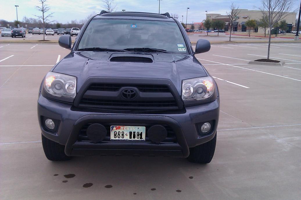

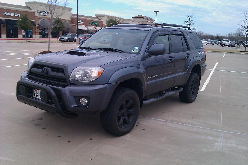

Cornfed 3/2...Finally!
Finally got the Cornfed 3/2 installed and plasti-dipped the wheels. Still running stock tires and searching for good upgrade.

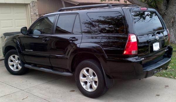

This is my 2007 Sport Edition as purchased this past December

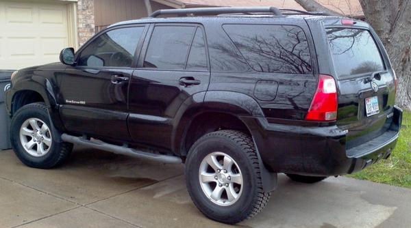

And here she sits after the leaking Xreas was removed and a new OME/Toytec suspension installed. I measured a lift of 3.25" in front and 2.18" in back

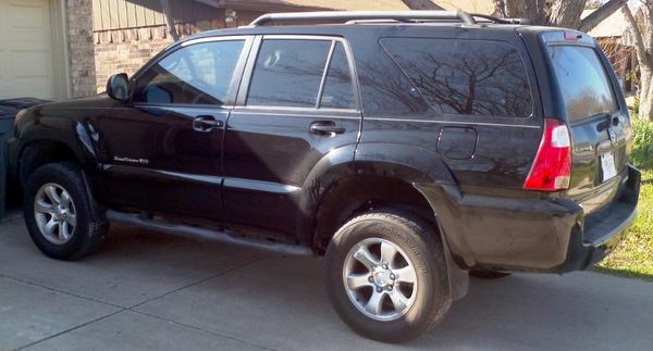

This is her new stance with new GY WSA 275/70 R17. I love the tires very quiet on the highway. (I run them at 45psi)

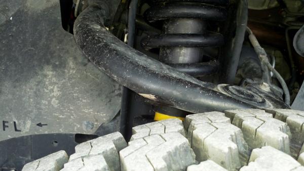

The new tires rub the UCAs only when making hard turns

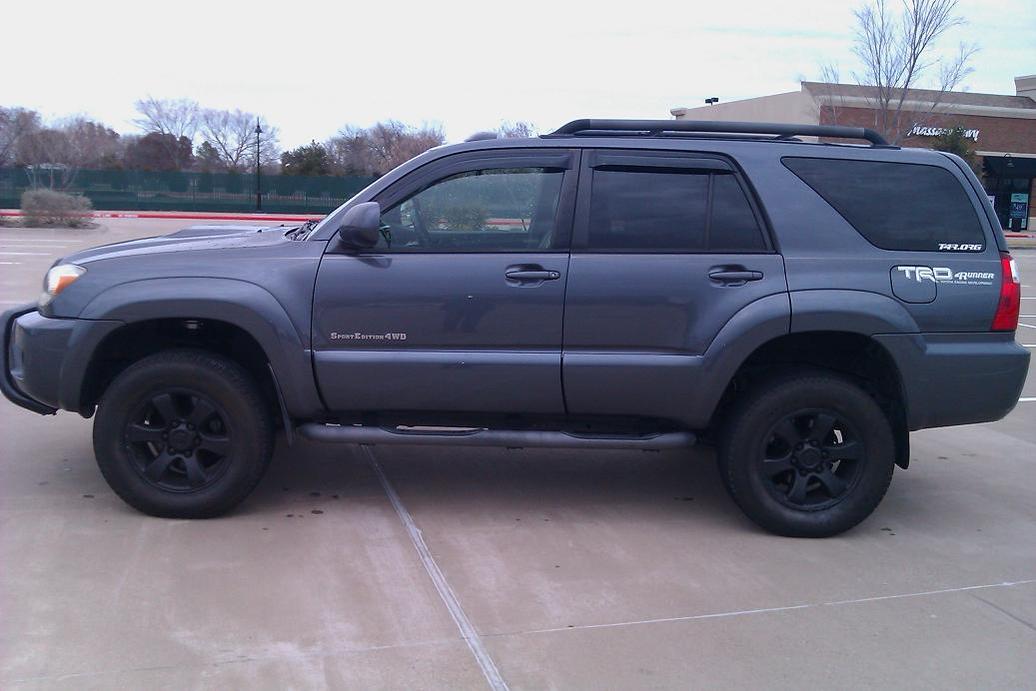

Got the new fj cruiser wheels mounted today. No more rubbing on the UCA and the color accents the Gray paint in an awesome way.

100% improvement from stock rims. If those coil overs will bump up one more notch, IMO it'd look even better, still seems too raked in the front... Just me thinking out loud tho, great job:guitar3:
