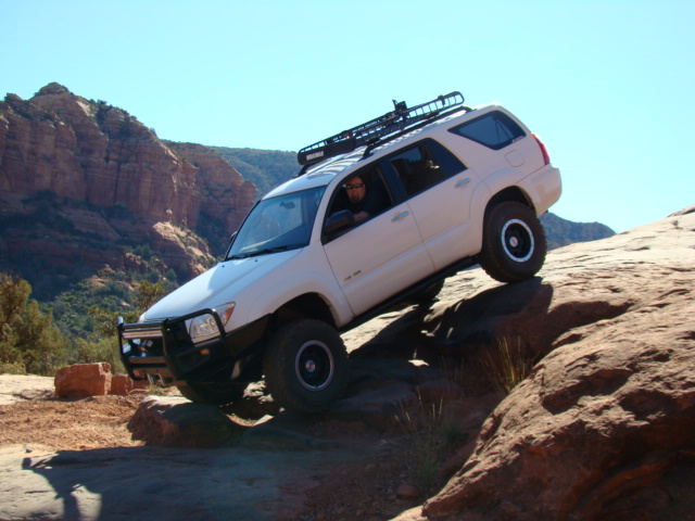

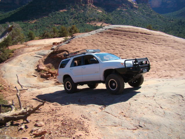

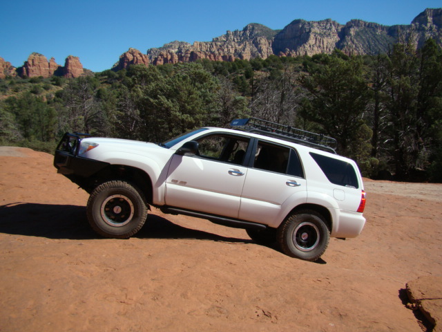

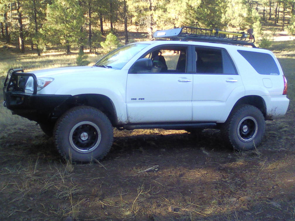

new mods
Well it's been a while since ive been on this site. I have done many mods since.
The list includes:
TRD TX Pro wheels
285/75/16 BFG AT's
ARB bumper
Warn M8000 winch
Custom sliders
30" Rigid Industries light bar
Rigid industries Dually reverse lights (mounted under the rear bumper)
Full Asfir aluminum skids
Optima red top
Here are some pics some action some posers

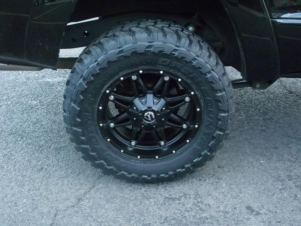

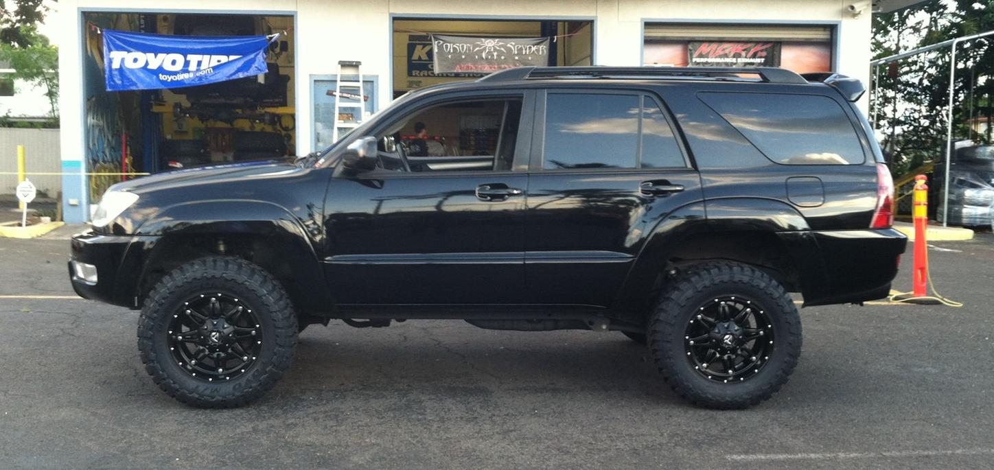

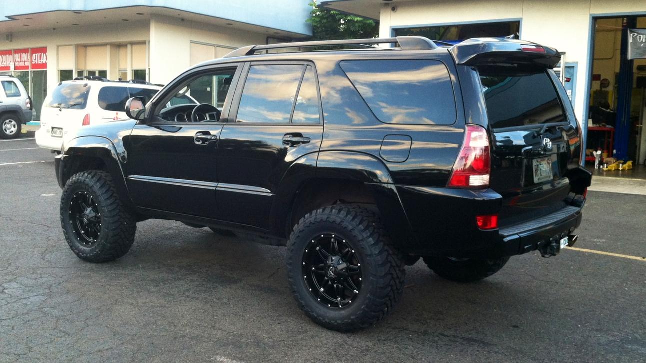

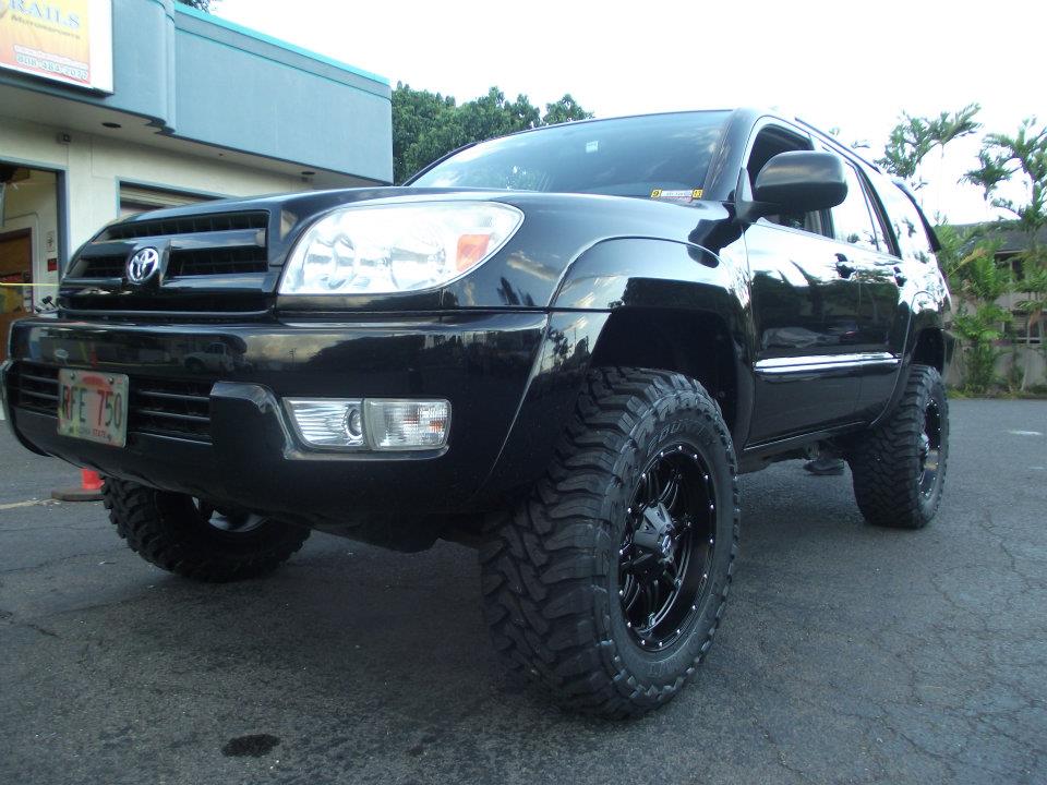

What's up fellas! Here are some pics of my 05 Runner. Been lurking on here for a while, and finally decided to post some pics. Runner has been lifted since 2006. Thinking of switching to an Icon lift. No problems with the Donahoe setup. I have no complaints. Just want to switch things up. Only problem I am experiencing now is my tires rubbing the front body mount right behind the front tire. Previously had on 285/70/17 and never rubbed. I can adjust my lift to go up another .5-1", just need to put the time aside. Pics are from when I first had the new wheel sets put on.
Debating a 1" body lift. Can anyone with a body lift on your Runner tell me some pro's and con's?
Donahoe Racing adjustable front coilovers
Donahoe Racing rear coil springs and shocks
18x9 MHT Fuel Hostage wheels
33x12.5/18 Toyo MT Open Country

Welcome dezhoncho! Your stance looks perfect. If you're happy with your Donahoe Racing setup then there's no need to change to Icon Vehicle Dynamics since they are essentially one in the same. They restructured the company and changed the name a few years ago.
As far as the rubbing goes, you're rubbing now most likely because of the change in offset in the new wheels. The aggressive sidewall tread on the Toyo MT's might also be contributing. Unless you're rubbing on the body parts (fender, wheel well), a body lift won't benefit you. The body mount will always be at the same point regardless of how high the body is. You're gonna have to chop the body mount. It's a relatively simple process with a little welding involved. You can read about it here on 120: Body mount chop - Toyota 120 Platforms Forum
