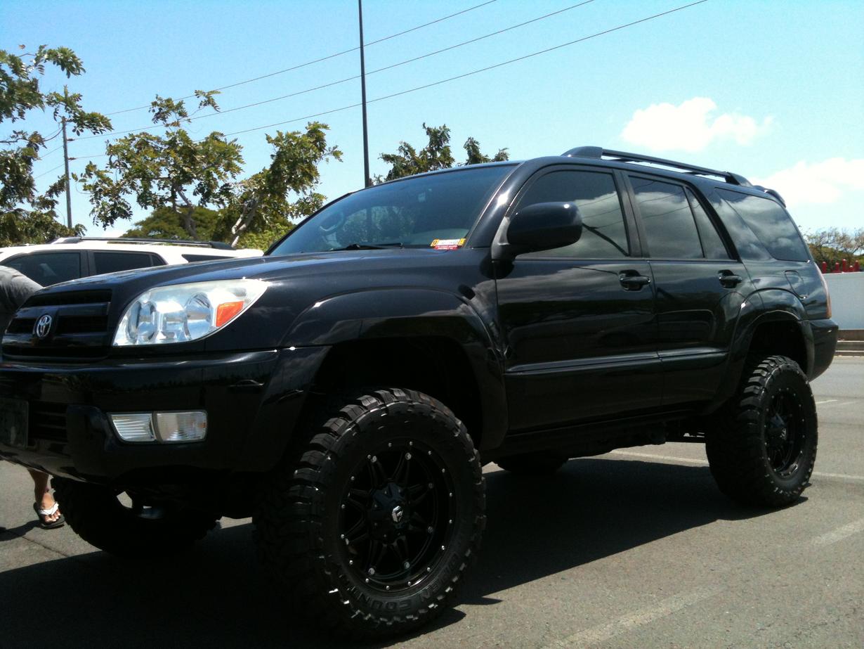

What's up fellas! Here are some pics of my 05 Runner. Been lurking on here for a while, and finally decided to post some pics. Runner has been lifted since 2006. Thinking of switching to an Icon lift. No problems with the Donahoe setup. I have no complaints. Just want to switch things up. Only problem I am experiencing now is my tires rubbing the front body mount right behind the front tire. Previously had on 285/70/17 and never rubbed. I can adjust my lift to go up another .5-1", just need to put the time aside. Pics are from when I first had the new wheel sets put on.
Debating a 1" body lift. Can anyone with a body lift on your Runner tell me some pro's and con's?
Donahoe Racing adjustable front coilovers
Donahoe Racing rear coil springs and shocks
18x9 MHT Fuel Hostage wheels
33x12.5/18 Toyo MT Open Country

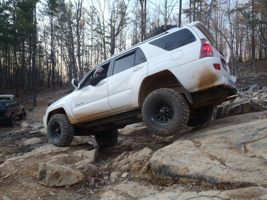

2003 4runner Limited V8 4wd, 3" OME heavy duty Lift, SPC performance UCA's, 305/70R16 Mud tires, Front Sway Bar Removed, Tundra CV boots, K&N Air filter.

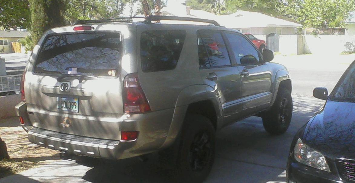

Just installed Supreme Suspensions 2.5" Front, Daystar 1.5" Back
photo2.jpg~original
Let me say that the Strut Spacer in the front (rather than a coil spacer) was a royal pain in the a$$. Had to disconnect the lower control arm and still struggling to get the third (rear) bolt into the top of the strut.
I will definitely be looking into Bilsteins and Toytec/OME Coils
