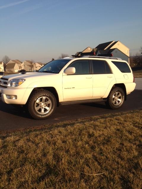

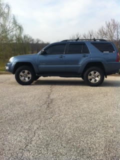

New Tires
Went with a General Grabber At2 265 70 r17.. very little rub up front on hard turns.

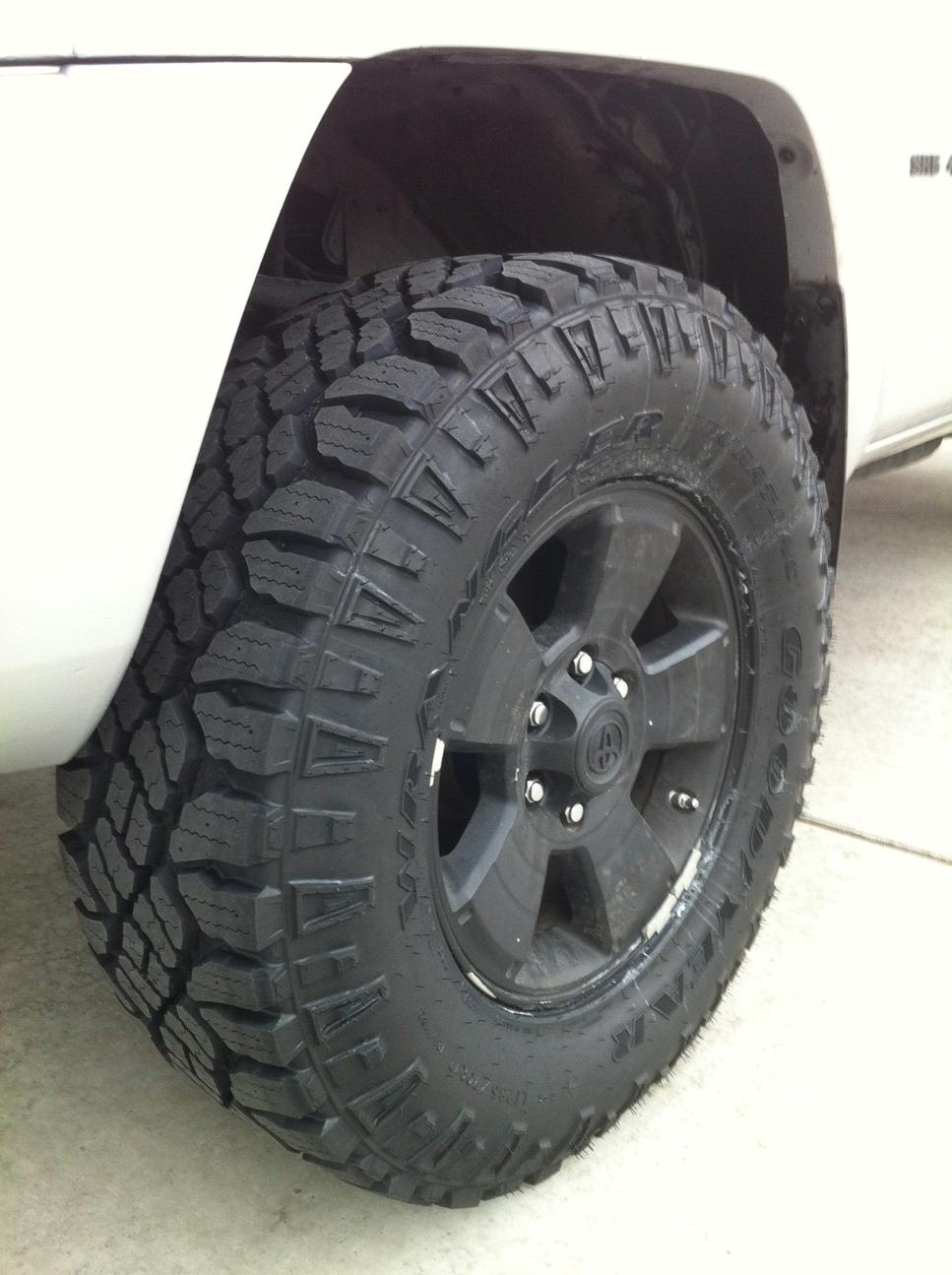

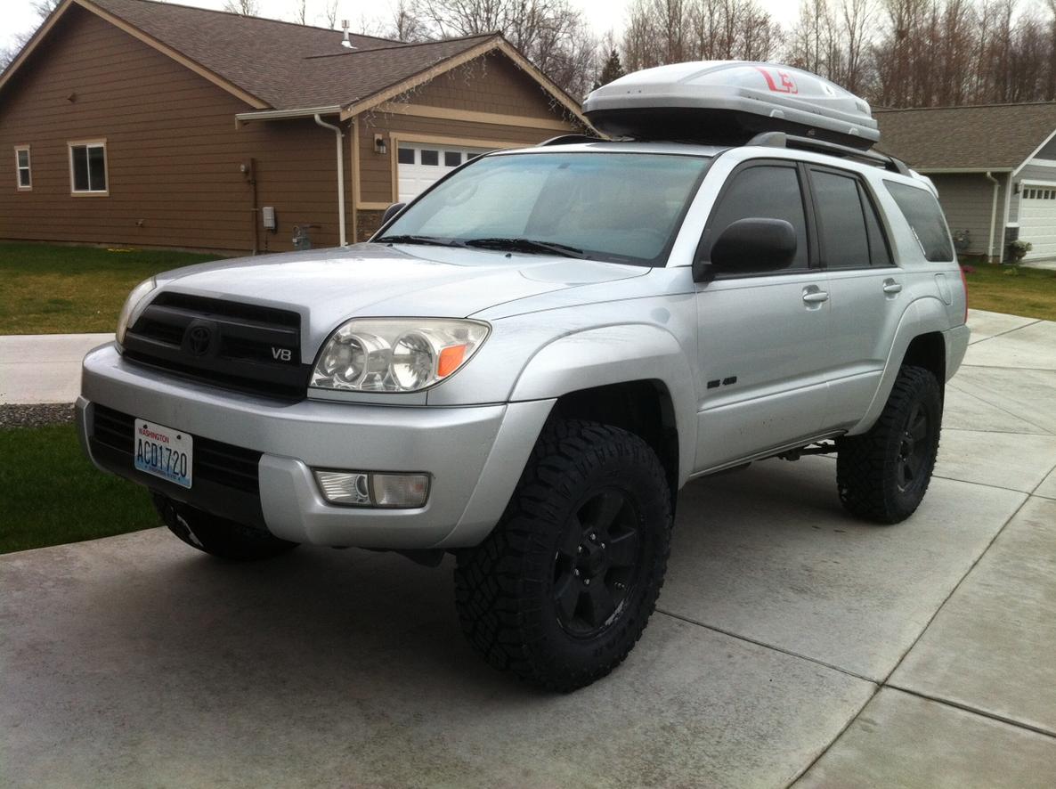

new shoes and rear lift
Installed my Toytec Superflex rear coils and moved my 5100's to the top setting. Then got my 285/70-17 Goodyear Duratrac's on. Super stoked on the new stance and love these tires.

That looks awesome with the new lift and stance! Any rubbing?
I did all the modding on Saturday and havent had a chance to trim yet but there's definitely rubbing. I think most of it is on the mud flaps. I'm getting an alignment tomorrow so more trimming is in my future :sniper:

Your ride looks awesome! So you are running FJC shocks in front but superflex in rear you just have the bilsteins adjusted higher in front correct? dont the superflex rear give like 2 inch lift in back?
Yup, FJC coils up front with the 5100's at top setting. I haven't had a chance to measure but it's about 2.5" lift in front with 2" lift in rear with Superflex coils. I love it, has about a 1" rake to it. I'm seriously considering going with the Toytec coil over for my billies. Would allow me to go up to 3" in front, but I'll rock this for a while. I have a little more trimming to do up front and if the weather ever gets better ill post some more pics.

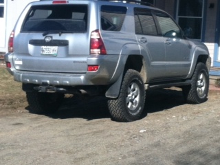

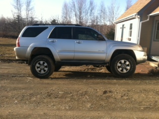

Here are a couple pics of my recently lifted 4runner. I ended up going with 3" toytec spacers in the front, 2" OME coils/shocks in the rear and a 1" toytec BL. For tires I chose General Grabber At2's, size 285/75/16. I have all-pro 1.5" spacers sitting on my desk that I haven't installed yet.

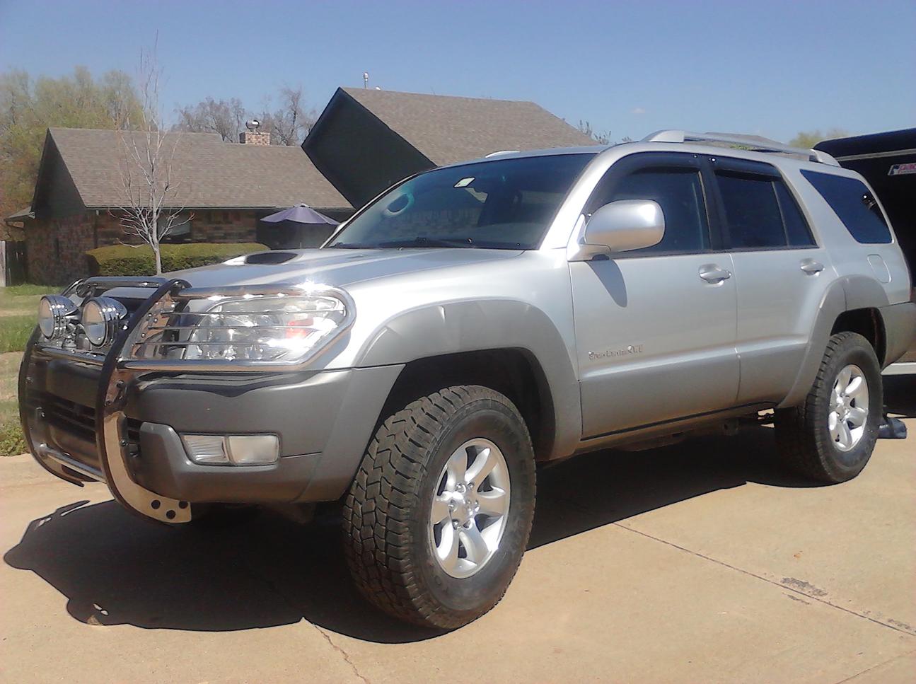

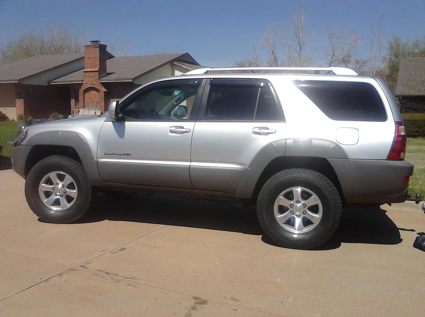

My 03' Sport Edition 2.5" lift 285's
I am running a billet 2.5 spacer lift in front only with the mud guards and running boards removed.
Tires are Toyo 285/70/17 Open Country A/T's. There is only slight rubbing on the upper control arm @ full lock, and it is only contacting the tire @ the edge of the tread block.
