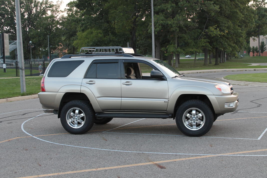

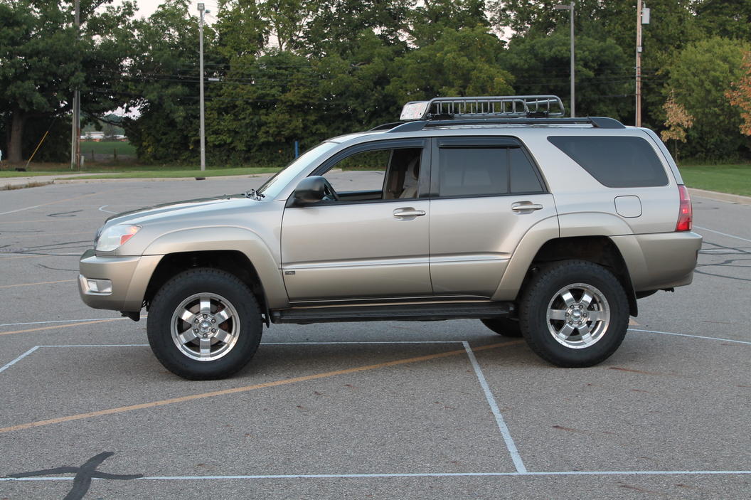

ToyTec Coilovers in front
Bilstein 5100 shocks/ToyTec Superflex Coils in rear
Light Racing Upper Control Arms
Spydertrax Wheel Spacers
Swaybar Relocate
Diff Drop Kit
17' OEM FJ Cruiser Rims painted black
Goodyear Wrangler Silent Armors 275/70R17 Load C
Minor rubbing, had to remove the mud flaps and push forward the wheel well about 3/4-1 inch, didn't need to cut bumper at all.

I tried running with the 1.25 spidertrax and the -6 offset at first with bad body mount rubbing. Without the spacers, they clear the body mounts fine.
After removing front mud flaps, I have no rubbing up front. At full stuff in the back it may just begin to contact the rear mud flaps... Waiting for a real trail run to assess the rubbing at full compression.

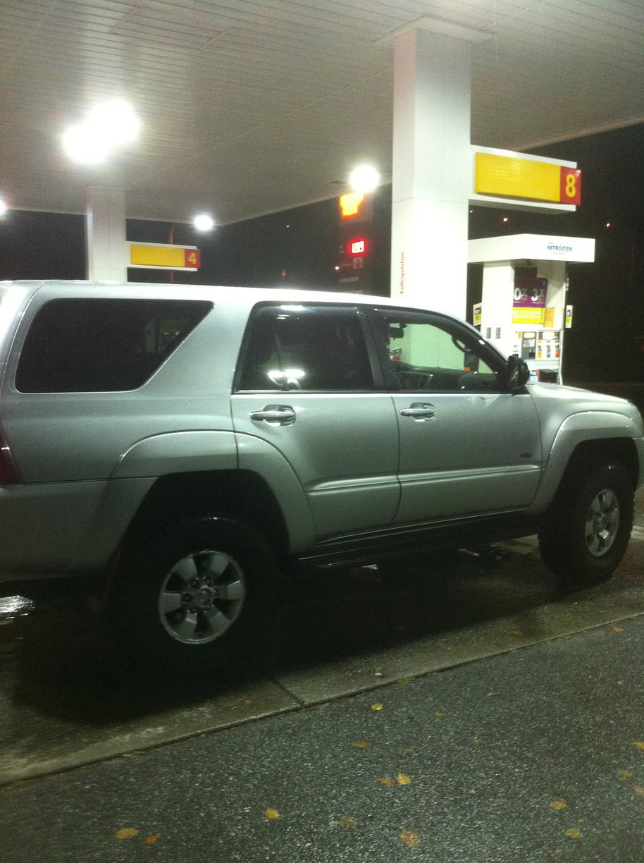

finally got the ol girl up in the air, as well as new tires and rims. 265/70R18 terra grapplers for rubber and a mix of ome/bilstein/fj on the lift. wheels are port installed fj cruiser enkei's. sliders and skids in the works.

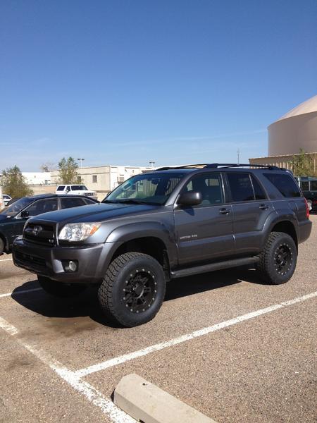

Finally!! Installed new Cooper ST MAXX 265 70 17s E Rated with Bilstein 5100s all the way around. Front set at 1.75" and added a daystar 1.5 in the rear. Still has rake and should have moved it to the 2.5 setting but ill live with it till i get some OME coils. Ride is definitely changed from XREAS car feel, but it is still very smooth and takes the bumps well! Tires are PSI 47F and 45R. Still playing around with pressure. Alignment today was able to get everything within spec so pretty happy there. Overall, pretty satisfied w the way it came out.
Had to trim the mud flaps a little and moved the front liner forward...these tires run BIG!
