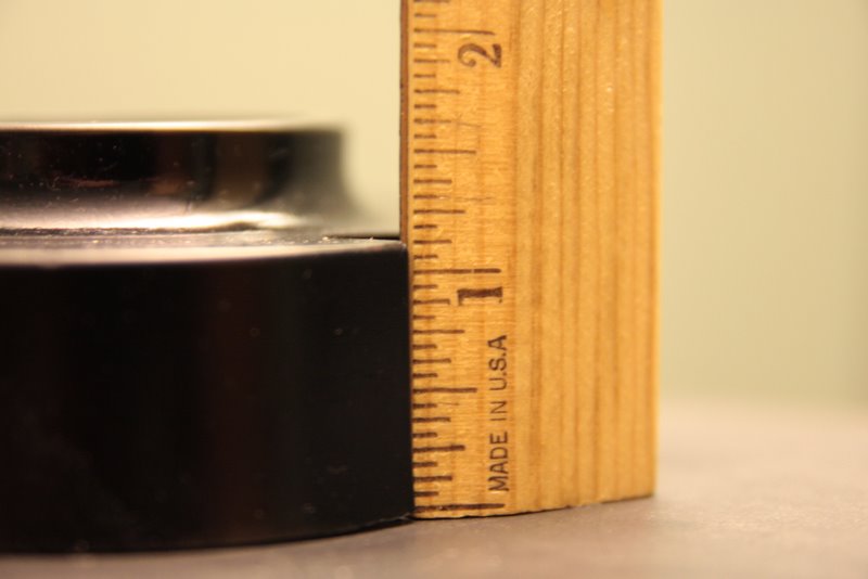

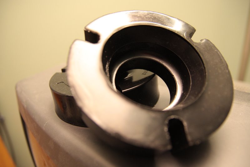

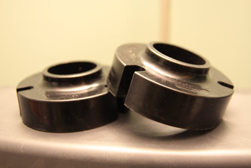

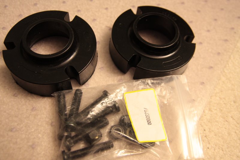

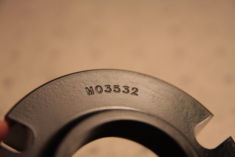

The spacers I ordered from Wheeler's Offroad Monday night arrived today (Thursday). Those guys are on the ball, two days shipping from Oregon to Virginia!! I can't speak more highly of Wheeler's. I found their professionalism, attention to detail, and timeliness to be top notch. I recommend them to anyone who is looking for a Daystar spacer kit. They sell both the 1" Budget Boost and 2.5" lift kit, and cheaper than anyone I found online.
Ok, now for the important info. After 2 weeks research, reading every post on Daystar leveling kits on this web board (at least two or three times), and now seeing and holding them in my hands, here are my observations:
- The Daystar 1" Budget Boost = 1.25" Wheeler's Offroad kit sold here (http://www.wheelersoffroad.com/03up4rundstrlift.htm). It's the same exact kit.
- Stamped on the spacer is part# M03532, meaning this is Daystar KT09117BK. The picture on Daystar's website for the 1" Budget Boost IS CORRECT.
- It is black; though Wheeler's said they can order it in other colors.
- It is exactly 1 1/8" of material as seen in the picture below (and is probably why Wheeler's calls it a 1.25" spacer, recognizing that they're a 1/8" off).

Well the spacer cam in just as expected. How much lift are you expecting 2.0" - 2.25"? Remember Wheelers quoted you to expect 1.25" of lift???
I'm not sure what to expect. I'd be happy wth anything between 1.25" and 2". I doubt it will be over 2"...we will see!!
Interesting. So they would be the first distributor I've seen to list the thickness of their spacer instead of resulting lift amount. Good to know - so according to everyone on this site, this 1 1/8" spacer should result in about 2 1/4 inches of front lift, correct?

the total lift gained is twice that of the spacer thickness, so 1/2 = 1 , 1 & 1/8 = double that so it will be at least 2 in. in lift gained. daystar has been wrong, send burtman an email he ll tell ya the same thing. also remember that each side of the vec. has a different measurment - left vs right. good luck
