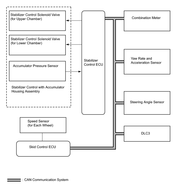

K.D.S.S.: from Harper7 via the service manual.
In the KDSS (Kinetic Dynamic Suspension System), a cylinder is installed to each of the front and rear stabilizer bars. The front and rear cylinder upper chambers and the front and rear lower chambers are each connected by a pipe. The hydraulic circuit is filled with high-pressure suspension fluid. The stabilizer control ECU controls the stabilizer control solenoid valves according to input signals from sensor.More info and links here: Kinetic Dynamic Suspension System - Wikipedia, the free encyclopedia and see post #2 from Harper7
You can have a combination of K.D.S.S. with either “regular” or XREAS, or you can have XREAS or K.D.S.S. separately. If you have XREAS and want to keep it you are limited to the spacer lifts.
