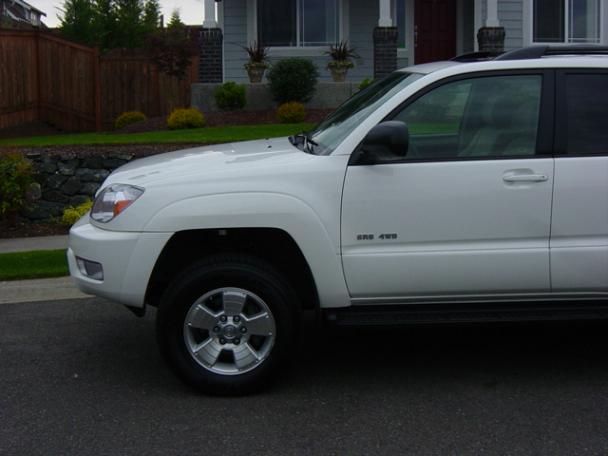

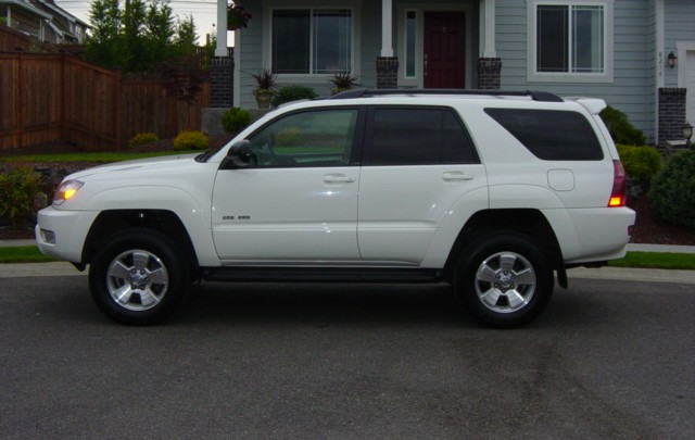

Do you have any bigger and better pictures then your sig pic? It's kinda dark and hard to see. My runner is also white so I would get the perfect idea from yours. It would be nice to see full side shots of the runner, up close of the wheel wells, up close showing the full tires and the spacing, also it would be great to see what kind of ground clearance you have. More pictures the better!! thanks! I know it's a lot to ask.

Here is some pictures of MAC4Runner vehicle with Cornfed 2"Rear+3"Front Lift Kit:
#1:

MAC4Runner, do you have any more detail images of front and rear lifts? You can send them to me and I'll post them as I did previous ones.
Let me know what you're looking for and I'll snap some more pics and take measurements.
I'm interesting in close look of your front and rear lift kit elements, gaps between top of the wheel and fenders. Also some vehicle images like front, 3/4, back will be great.
