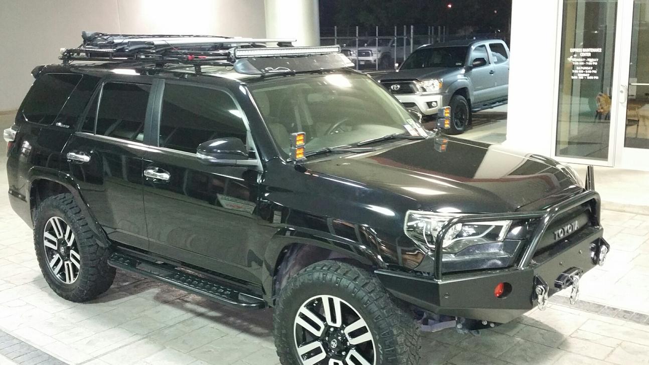

Spacer lift for less than $400

hey man i noticed i have a very similar setup as your car. im thinking about getting 285/70/17 tires next. Do you have any rubbing problem with 33" wheels? or had to get a body chop?
