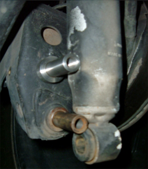

anyone have a pictue of the kit installed? or even not installed. Curious to see what the relocated look like?
The stock location for the bottom of the shock is on the bottom. The NE relocation bolt is on the top.
BTW: This is a photo I collected, it's not my 4Runner.

It's an existing hole, but by looking at that picture, you can already see that the angle of the reloc is different than the original mount.
Good photos that really tend to point the finger to the problem.
How many people are running around with this setup and don't know the damage that might be being caused to their expensive XREAS system:awais:
To have such an advance system on the truck made by Yamaha and it's slowly being destroyed:(
