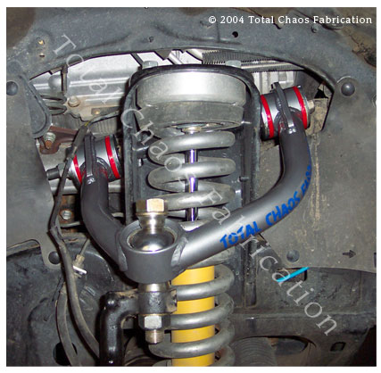

Here is a photo of the new A arm installed on Good Times' 4Runner.
I asked the guys at Donahoe if there were going to be any other part conflicts with the installation of their 2.5" coil over. I was assured that only the A arm might be replaced. They said they were confident that I didn't have to replace it, but in off-roading I would be better off with an aftermarket A arm. Donahoe plans on offering a replacement A arm of their own this summer. I'm not going to wait. Besides, they offered that the Chaos A arm was exceptional.
I am counting on this A arm to be stronger as well.

Today the Donahoe struts and Total Chaos upper A arms are being installed. I have already taken photos of the uninstalled parts.
The Total Chaos upper A arm installation required the drilling of a 3/4" hole in the top of the factory arm that connects the upper and lower arm - I don't know the name of this part. This makes the change-over permanent.
The TC kit has urethane bushings with a Zerk fitting. Their instructions call for Teflon grease for installation. None was included. The installer says they always use anti-seize.

The spindle connect the upper and lower A-Arms. I thought they only had to press the ball joint out to fit the TC A-arms. HHmmmm, also see where they route your ABS wire as it runs along the top a-arms. Want to see the zirks on the TC arms.
