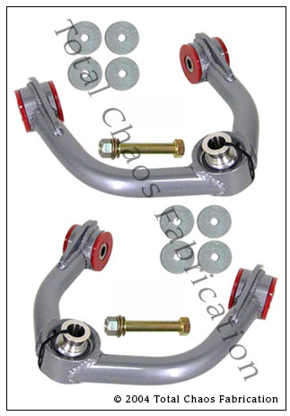

Here is updated information for my planned coil over install.
After consultation with Good Times and Donahoe Racing, I have decided to replace the upper A arms. The longer travel of the coil over struts, and the increased width, allow the top A arm to contact the coil spring on full extension. Aftermarket A arms fix this and allow for the full extension. I am going with the same replacement Good Times has used - http://www.chaosfab.com/uca4runner.html
