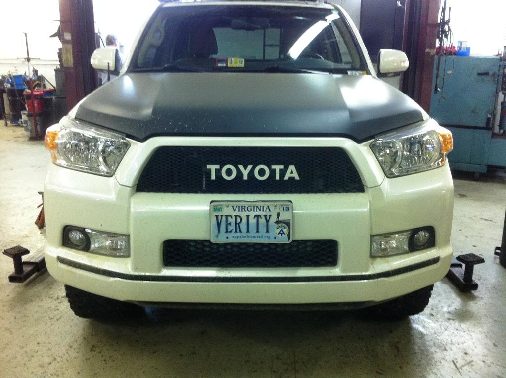

Anyway, here's Lima's truck before for reference...

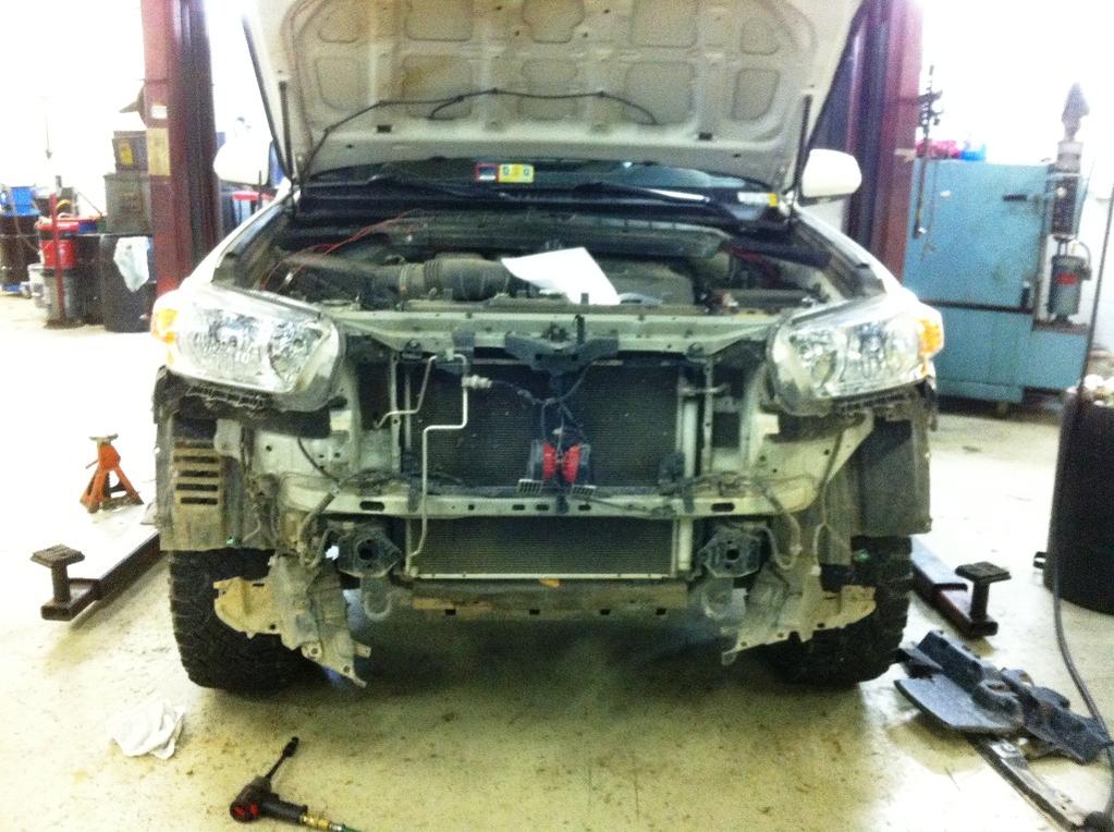

And this is what she looks like without a face!

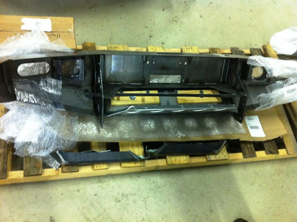

And how the bumper arrived...
We ordered the bumper with no hoops and bare steel. So you can see the quality of welding and craftsmanship up close and personal. Those with a keen eye will see something slightly different.

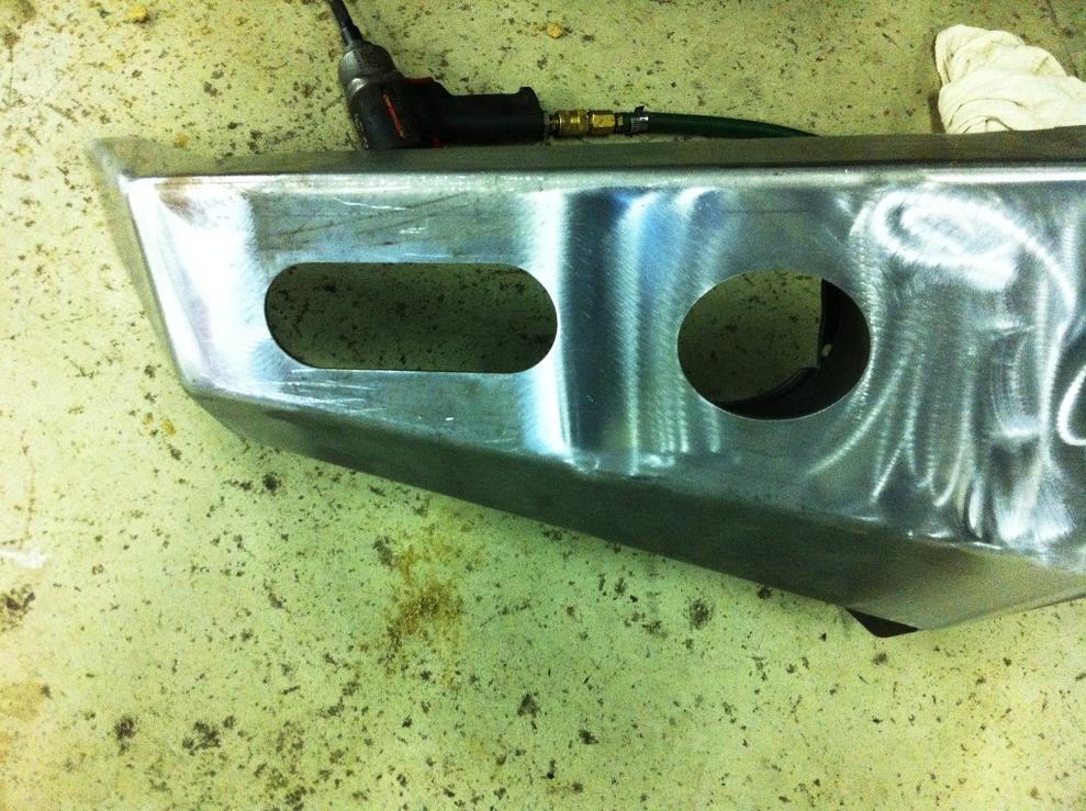

Noticing some holes in the top at different spacing on each end of the winch location and the light holes are "oval" instead of the standard round. also looks like there is an opening over the fairlead hole.
Alright what else? haven't seen the back to often of these bumpers..

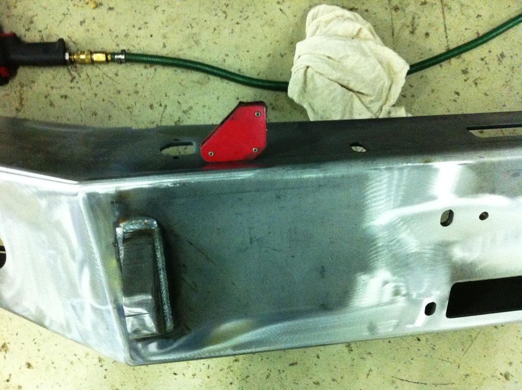

Here's a decent pic that shows how detailed Shrockworks is with their welds. The shackle mounts go through the bumper and then welded. Sorry, I didn't take a pic of the backside.

Those that have noticed, the hole for the turn signal is no longer for the crap Hella light that never seems to be sealed (ask Joneseyyy!). Knowing this from experience with the ARB bumpers with Jeeps and other Yota's, I wanted to get ahead of the game.

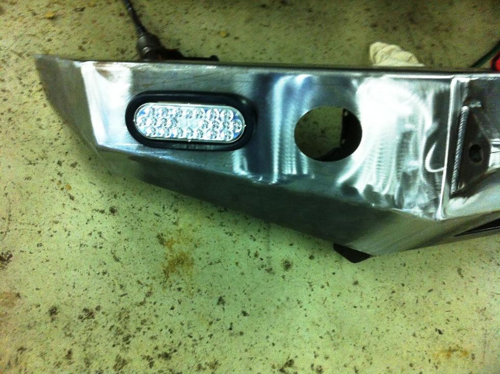

So, I spoke with Mark about a custom trailer light mount. Pretty simple really.
It's a sealed unit you can get in different colors, lenses, leds or not.
Now Lima can get replacement lights anywhere in the US (or Arizona).

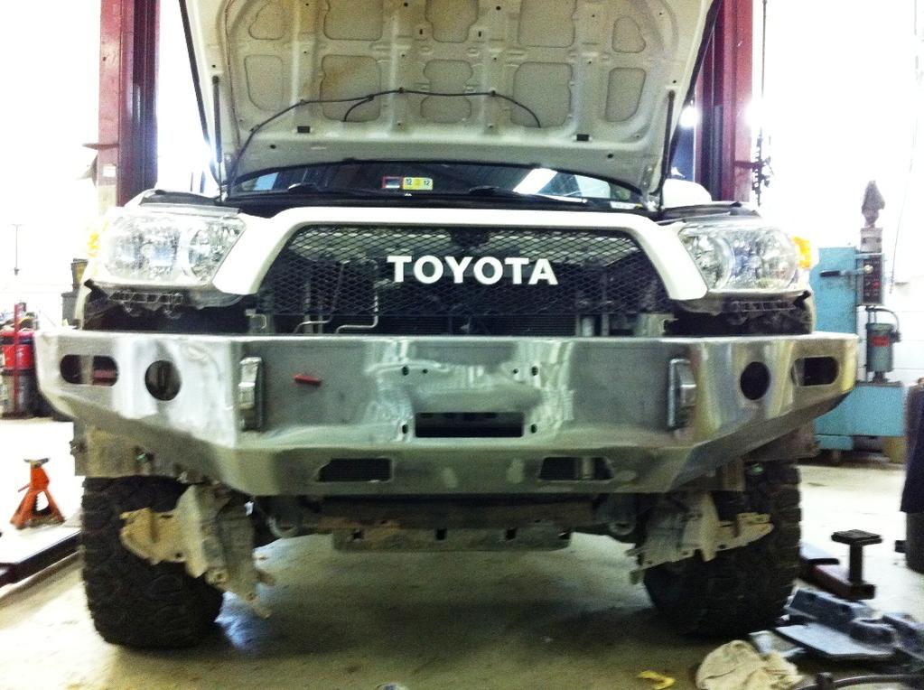

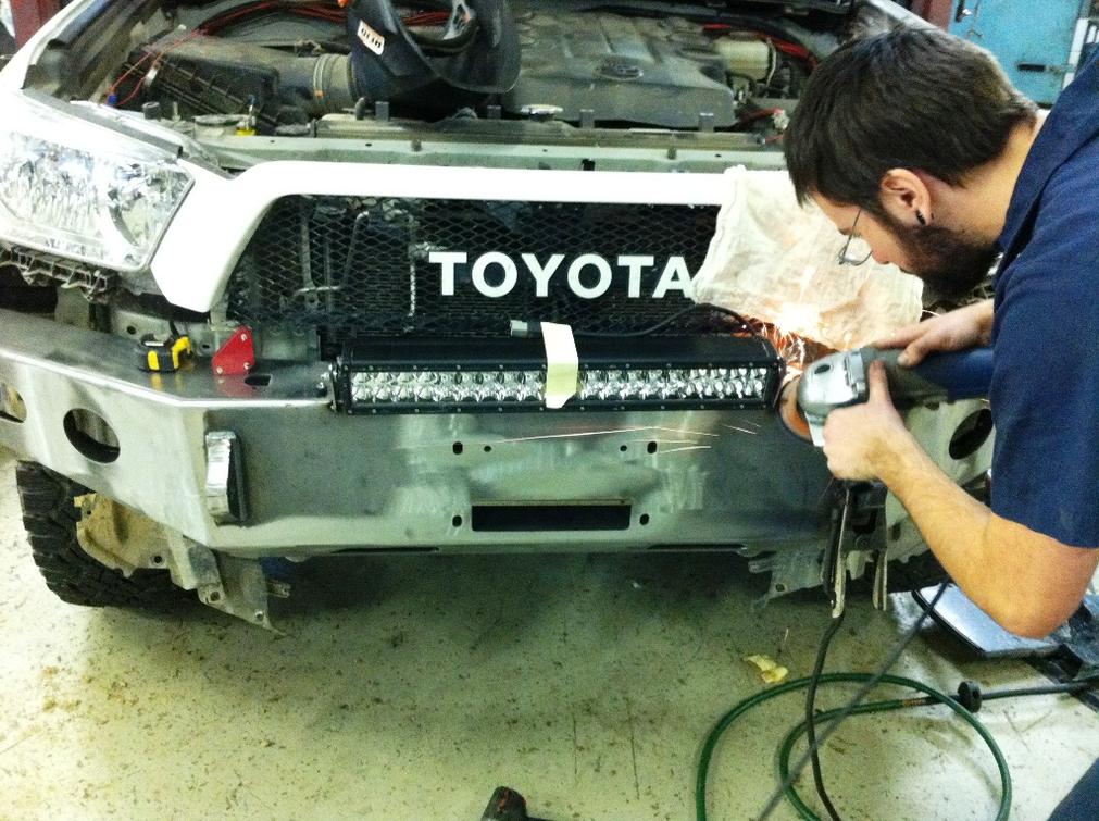

I've already done the joneseyyy installation thread so I won't bore you with those details. But here she is mocked up.
Now comes some of the fun stuff!

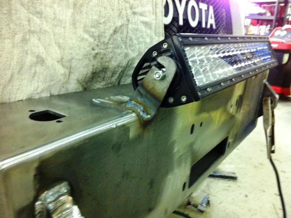

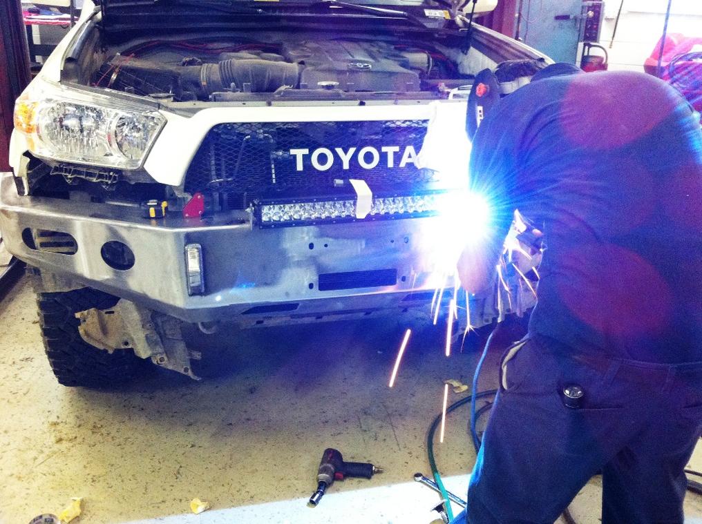

Lima had a 20" Rigid E Series behind the lower grill. I recommended that we do something a little special for the light mount since he won't have the lower grill anymore.
Luckily, Lima let me go to work on his bumper. This is the exact same way I would want my bumper to turn out. So here we are welding the brackets for the light.
Got both ends welded on and doing some clean up.
And part of the finished product.
And don't worry, I know it sticks out a little. That's the next step.

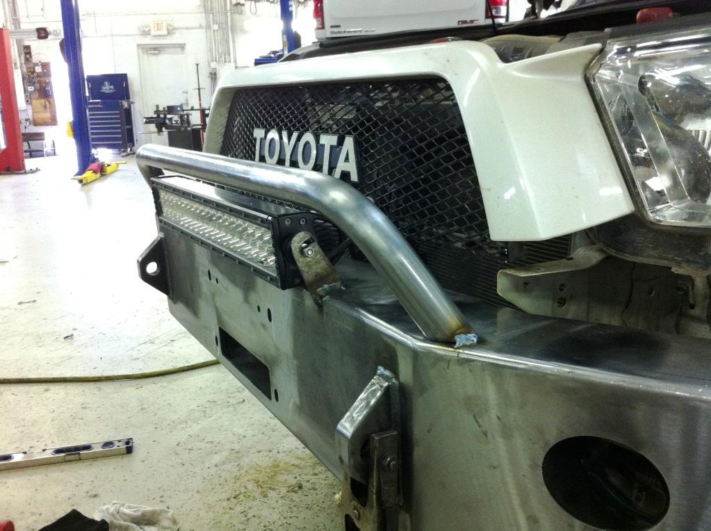

Light bar protective loops...
PM me for addy...:wink2:
Why the bare steel..gonna send it out for PCing?
Yes
No...haha
and Yes. We will be matching the powder coat from Lima's BudBuilt sliders.
Shrockworks does a nice semi gloss black but I wanted the bumper to match the sliders. It's also a common textured powder coat that gets very well used in the industry. So when Lima decides on other things that he'll want coated (rear bumper), it will be very easy to match.
I/we (High Tech) try to think ahead when it comes to some of the aftermarket installs. I believe this will prevent some of the mismatching products in the long run. It also brings the whole truck together nicely. I've had too many experiences with the Heep world. There is just too much junk out there and too many people adding too many things!!! (and people that use 'too' too much!).

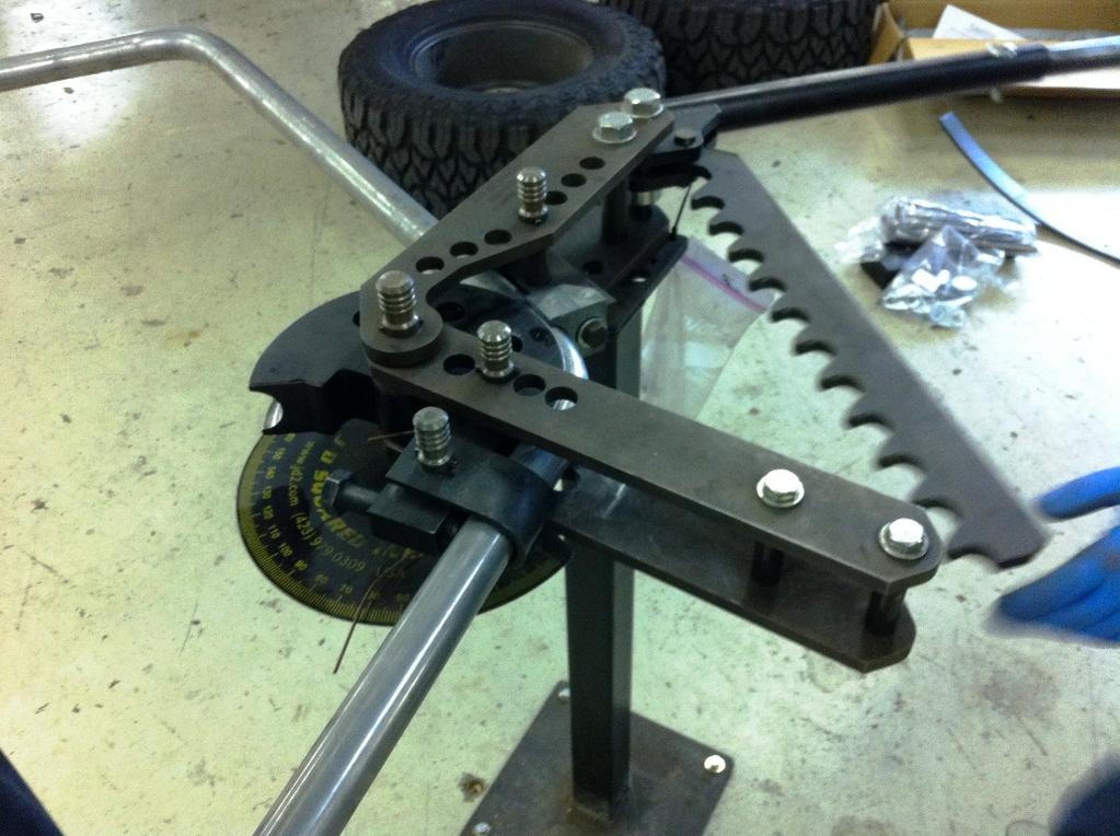

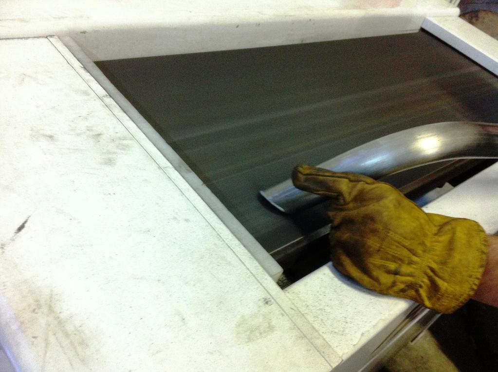

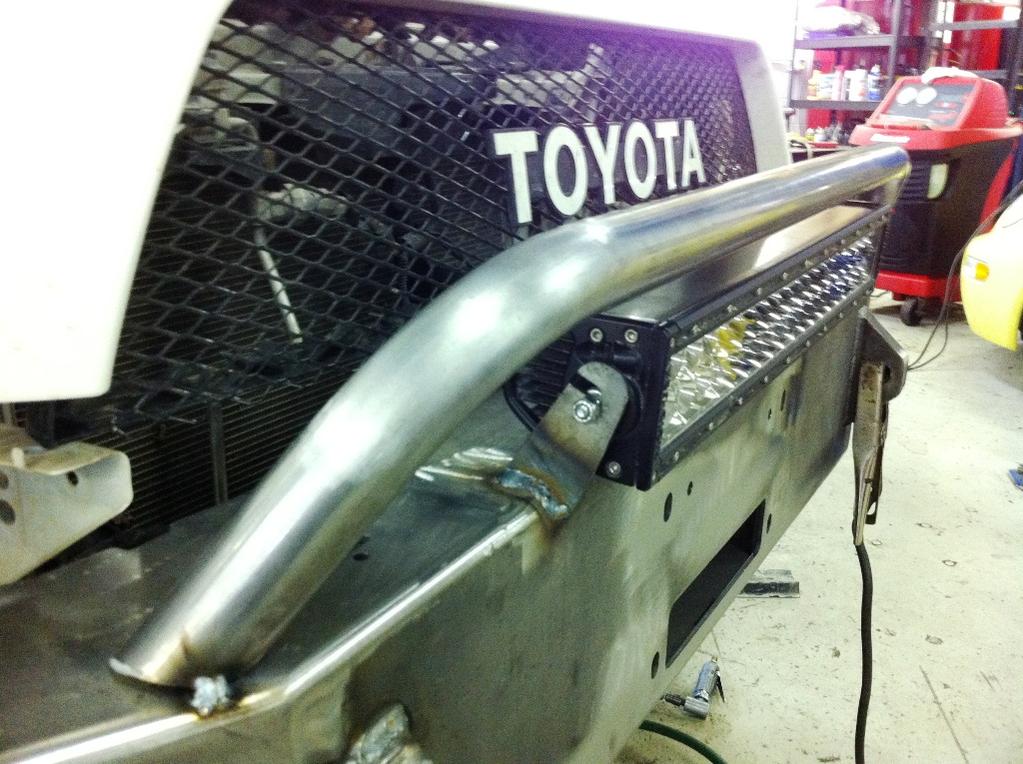

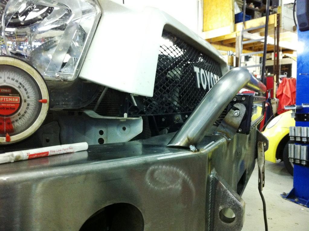

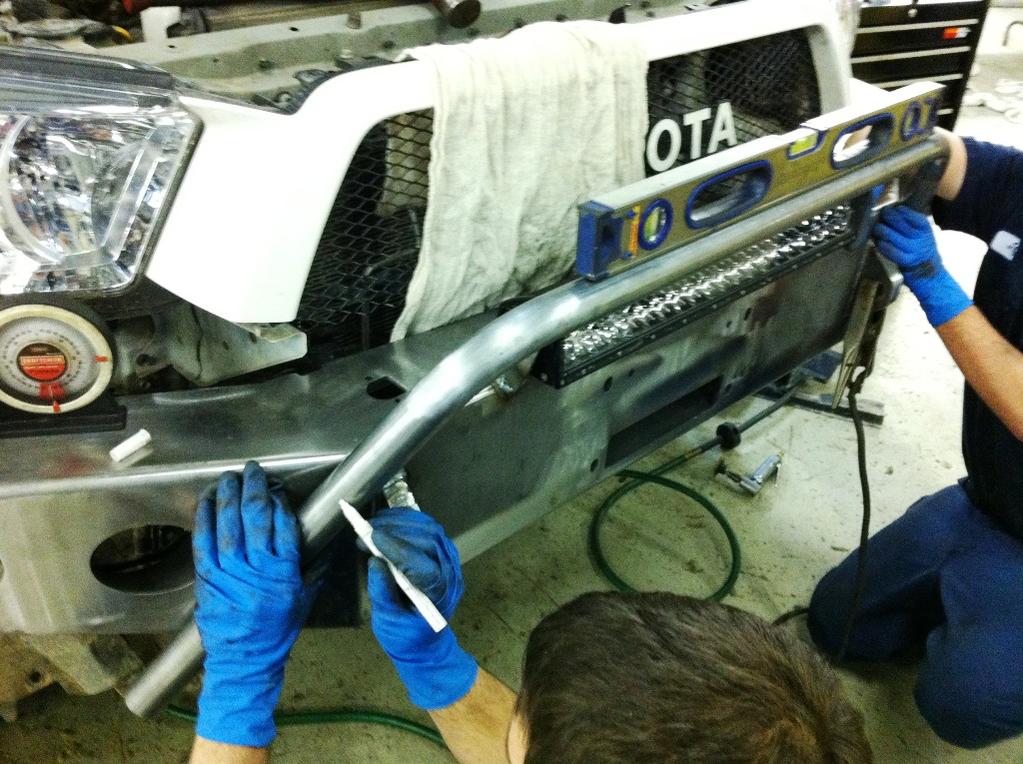

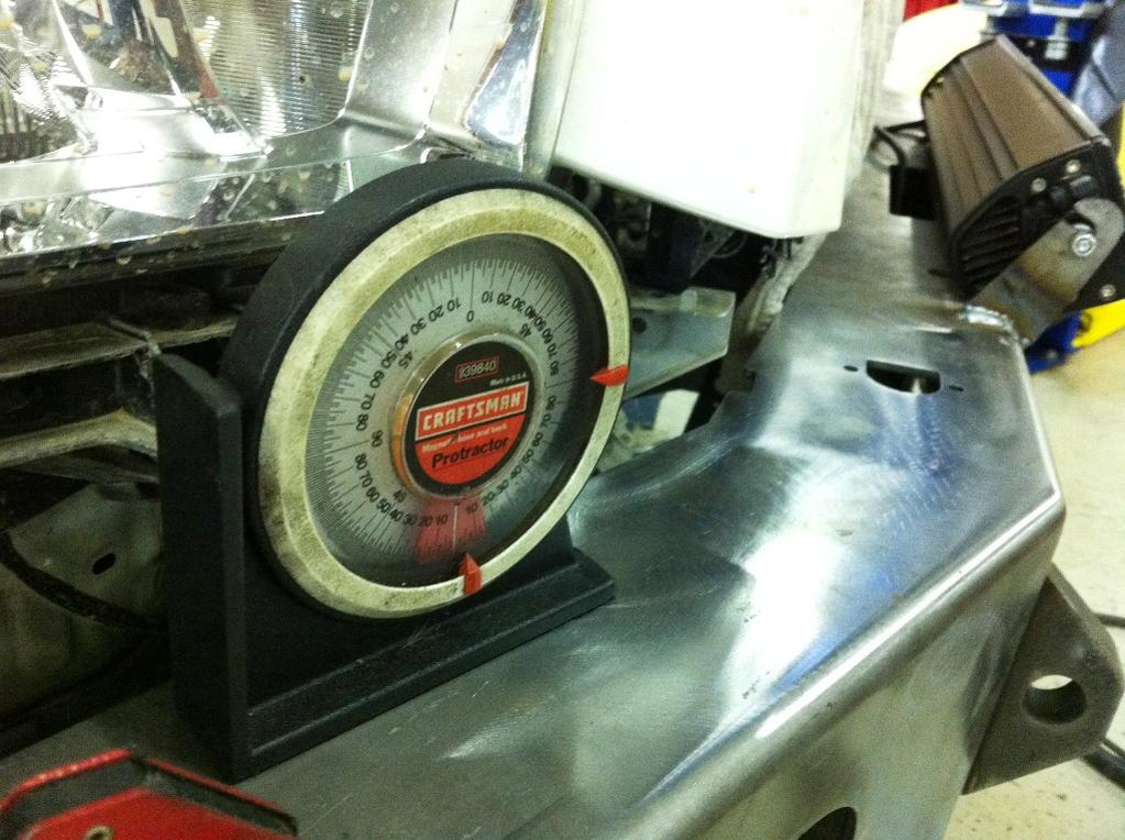

Yes, it's for a small hoop. The angle finder is so that we can closely match the upper grill bends. Similar to what Shrockworks does.
I told my tech, Jeff (which some of you have met at the Antman Camp), that I wanted the hoop to "hug" the light as close as possible. And he did that with perfection. It's so close that you'll have to tilt the light down in order to remove it.
Here's some of that process.
And on our planer to flatten out the edges.

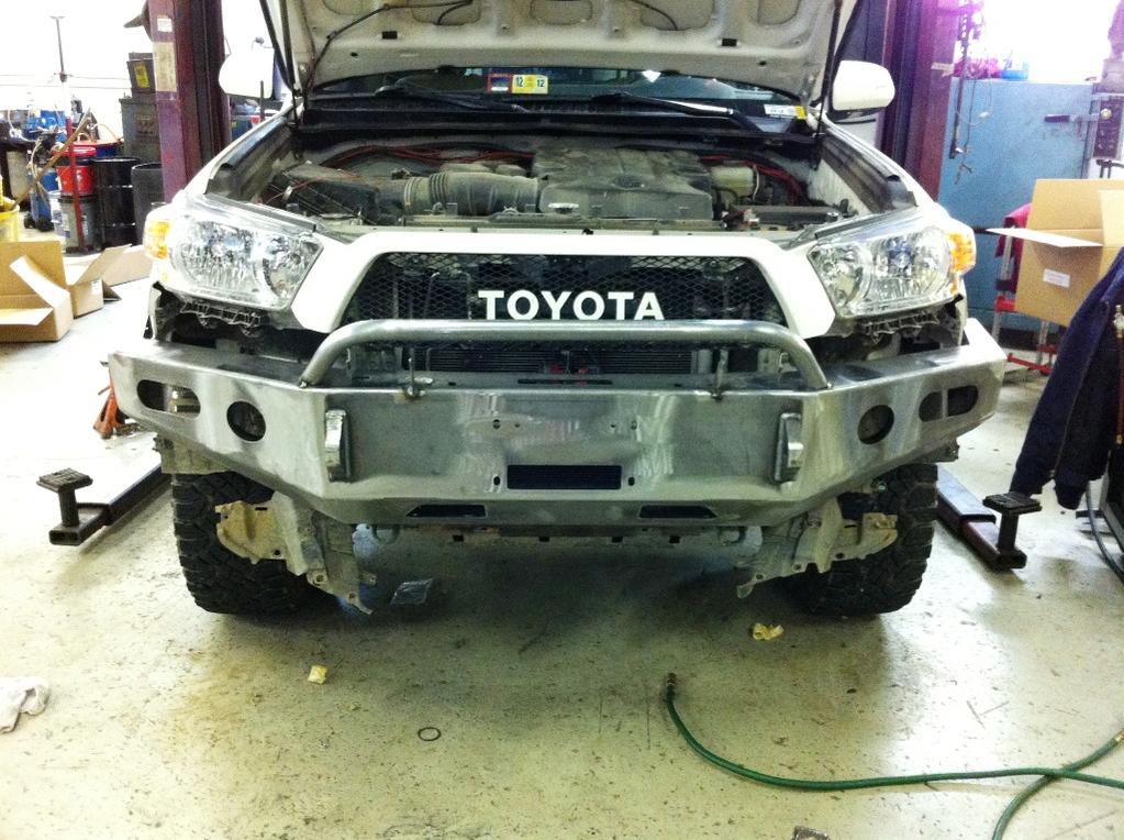

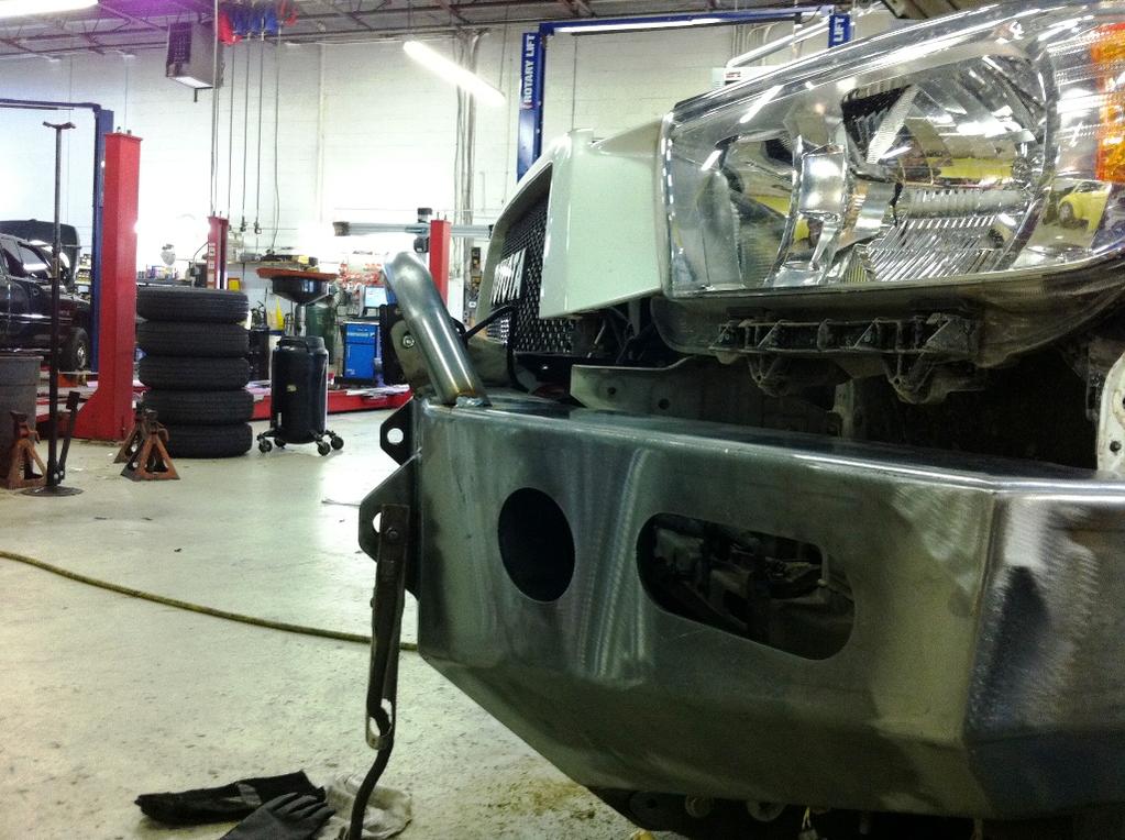

And some profile shots to give you guys (and Lima) and idea of how she's turning out.
LIMA- I hope you don't mind some of these guys seeing your bumper before you do!
It's really turning out well. Very happy with the outcome.
Here's a pic showing how closely we matched the grill bends.
