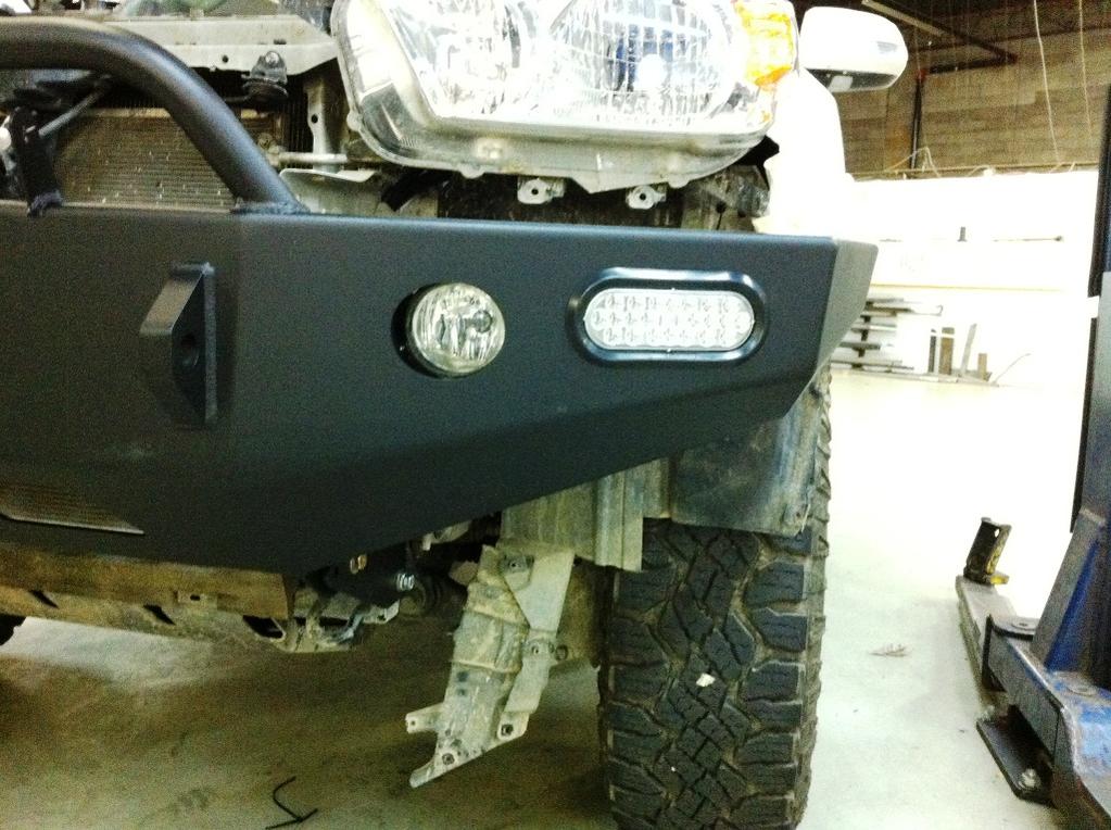

Sorry guys, I was out with the good ole streptococcus yesterday. I did, however, talk my guys into taking some progress pics.
This is exactly why these pics are "antman"ish. But, never the less, my guys did as they were asked.
So for your sneak peek....
I promise to get the rest loaded up tomorrow. But, seriously, my team is much better at working on stuff than taking photos of them.
