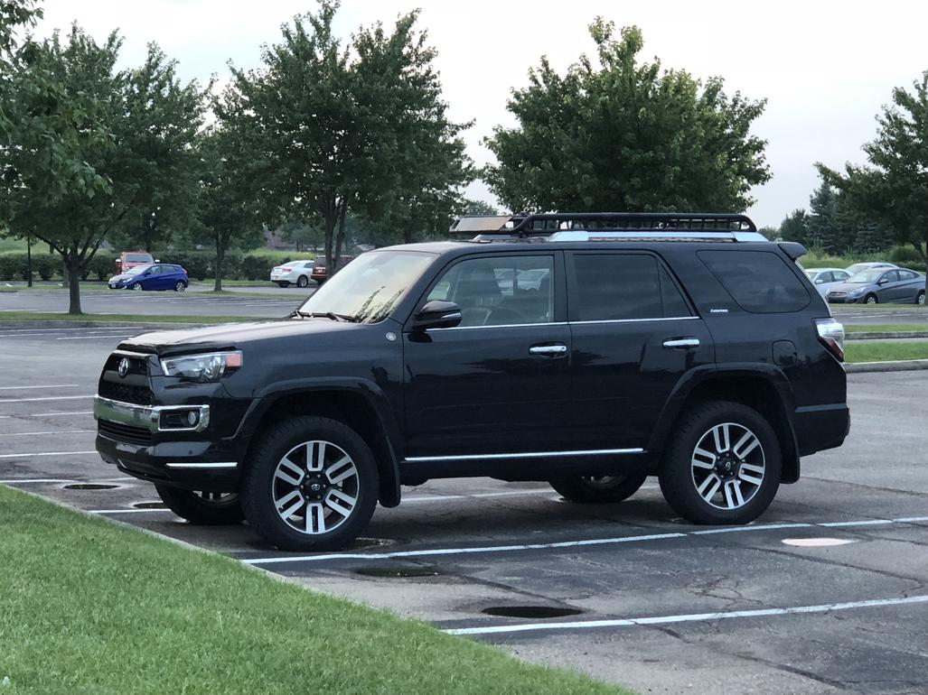

2014 Toyota 4Runner LE
- Mastercraft Courser A/T 275/55/20 on stock rims
- DayStar 2.5"F/1.5”R level/lift
- Husky F/R mud guards
- NiLight 31" single row 150W light bar (hidden)
- 4 Alpena Amber Position Podz Fr, 2 rear
- Cougar Motor LED headlights/foglights
- Precision Interior/exterior LED swap
- Rola V-Tex Rooftop Cargo Basket (with extension) mounted on 4xInnovations brackets
- Quick Fist axe/shovel mounts
- Rhino Shackle Hitch Receiver
- Auto Ventshade Bug Deflector
- Toyota OEM chrome exhaust tip
- Carbon Fiber chrome grille wrap
Coming soon: Shrockworks rock sliders w/ trim kit, Gobi rear ladder

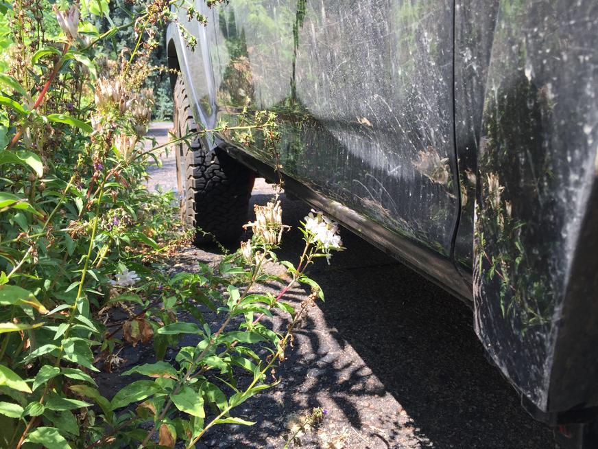

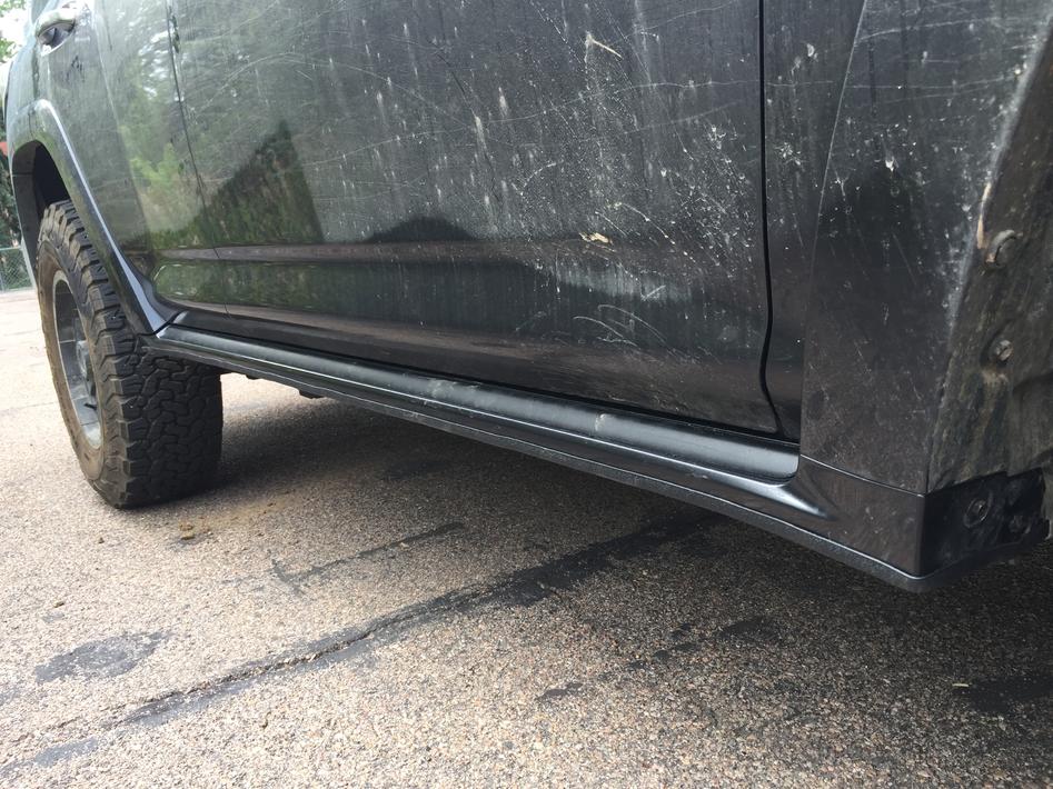

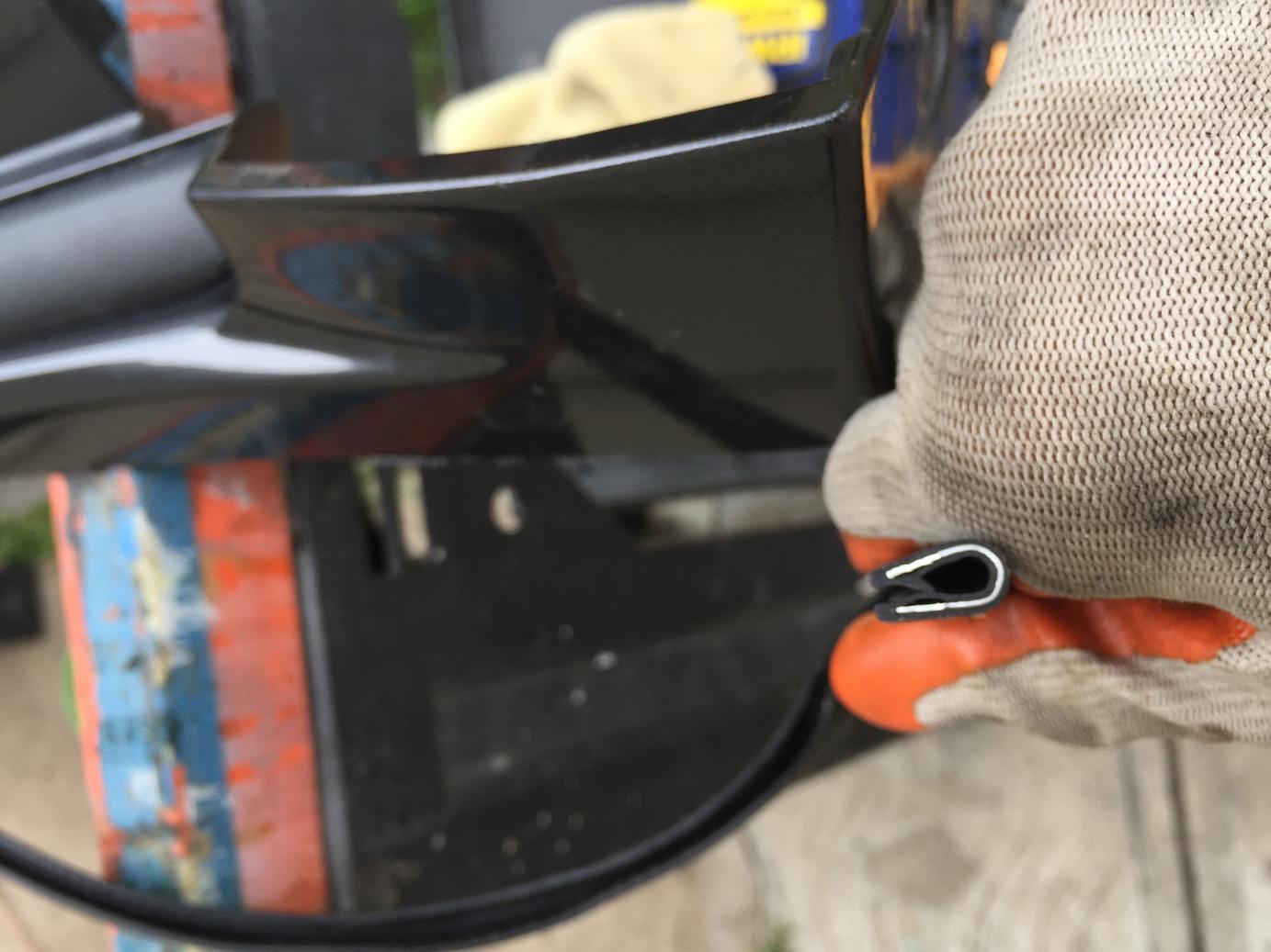

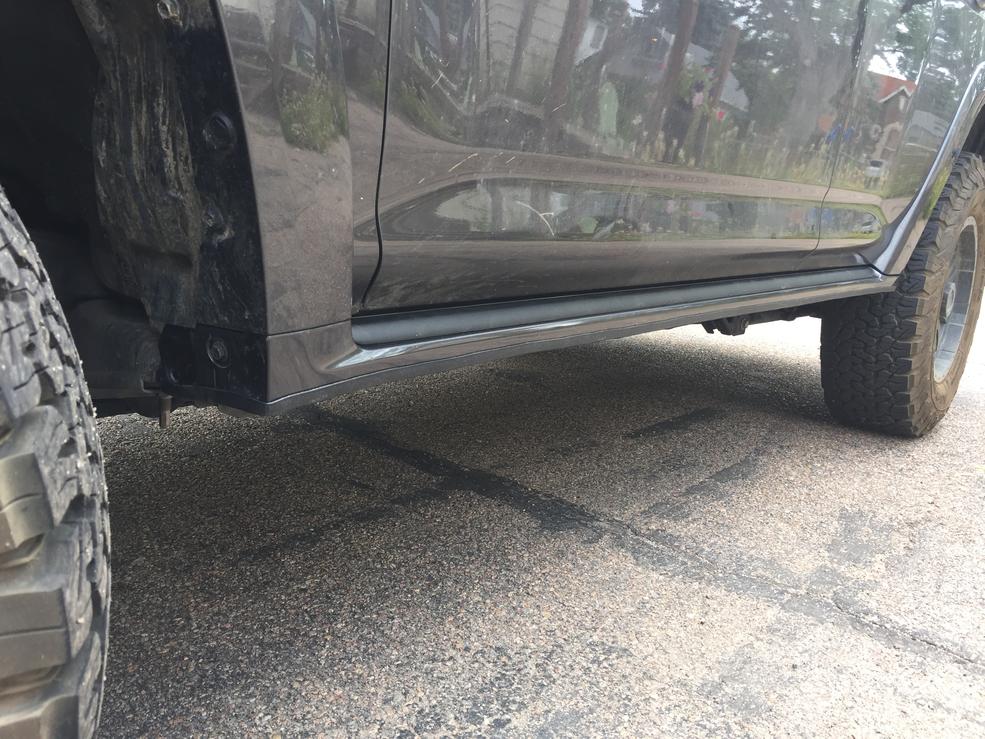

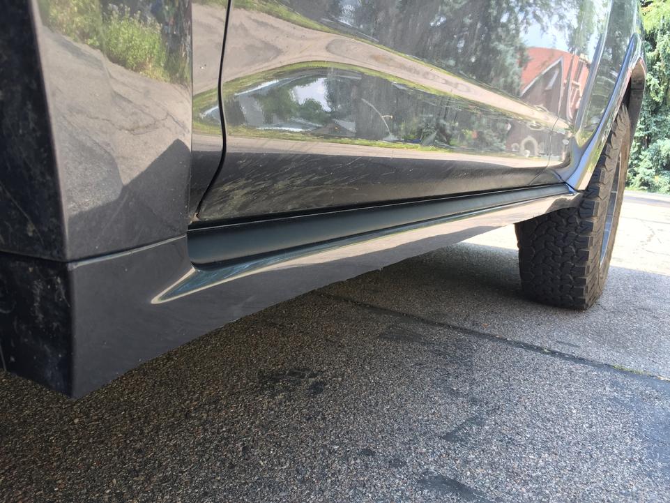

Trimmed rockers
Removed the rocker panels and trimmed them to accommodate my Bud Built bump out sliders.
This is the 2nd time I’ve done this on 2 different trucks. Learned a couple things the second time around.
I used a large square to draw a relatively straight line. Another member suggested a product called trim lock that I used to finish the edge.
While I had them off I used plasti-dip to cover the chrome trim.
All in all it turned out well!
