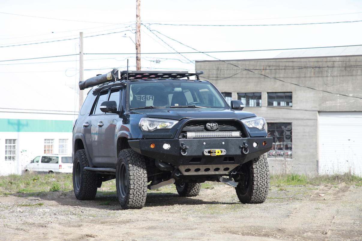

Here's my 2011 Limited. More pics in my build thread below or my Instagram.
Depending on brand There is only .03 in difference in height and width From 265-275s usually. I would go 285s there just not enough difference in height going to the 275 to justify the 275s weight of a 10 ply tire there usually about 10lbs heavier than a 6ply 265s
Not worried about gas mileage at all? Isn't that like a 1-2mpg drop?
