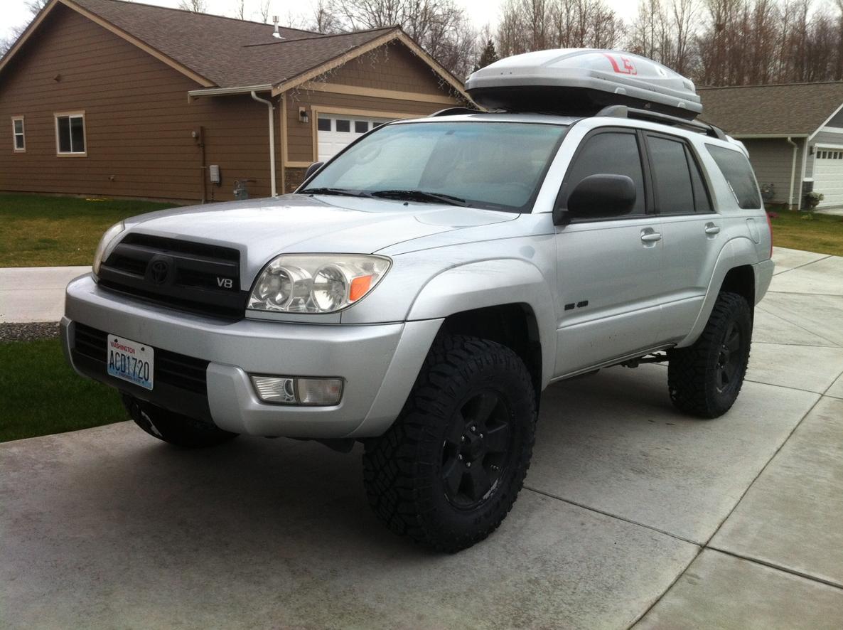

Well, it took a little longer than I had anticipated due to my traveling for work, being sick for a week, and then spending a week up in Whistler, but my "updated" lift is done and my new shoes are on!

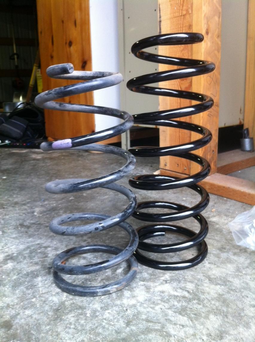

The longer coils were a bear to get on the rear but it's my fault because I was trying to get everthing done quickly and didn't take apart the rear sway bar. We just used the coil compressors and squished them as much as possible to make them fit. The fronts were easy enough, just moved the 5100's to the top setting.

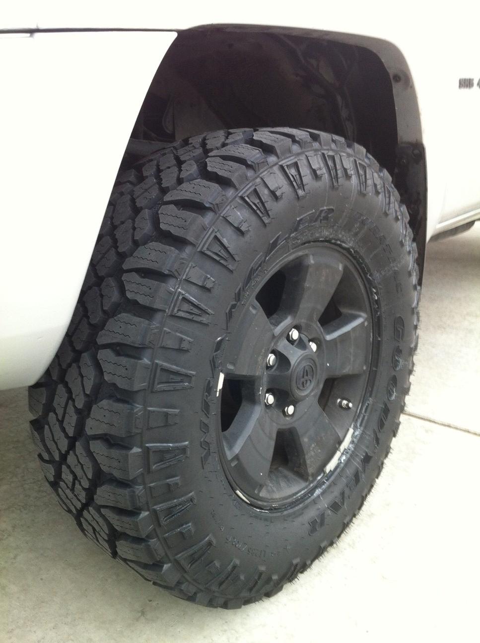

And I love my Duratrac's! I ended up going with D load range as that's what they had in stock at Discount. I've only driven about 30 miles on them as I have some trimming to do today and removal of my mud flaps. Teaser pics but will get some better pictures up when the weather improves. :guitar3:

I had more trimming with my dremmel than I thought on the plastic piece in front- had to do it 3 times before I got it right! It sucked to cut my baby.
So far I have not done body mount chop nor hammered the pinch weld (May do it when it gets warmer)but the rubbing has stopped when onroad driving. Offroad I haven't noticed anything.

So you had to trim 285/70/17 Duratracs with a 3" lift in the front and 2" in the back?
