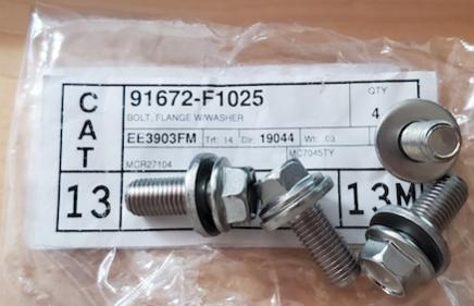

The matching bolt is an M9 x 1.25, 25mm. I had a hard time finding M9 bolts so I ordered them from Toyota for about $2 each. The Part # is 91672-F1025 and they come in a set of 4 bolts with washers.

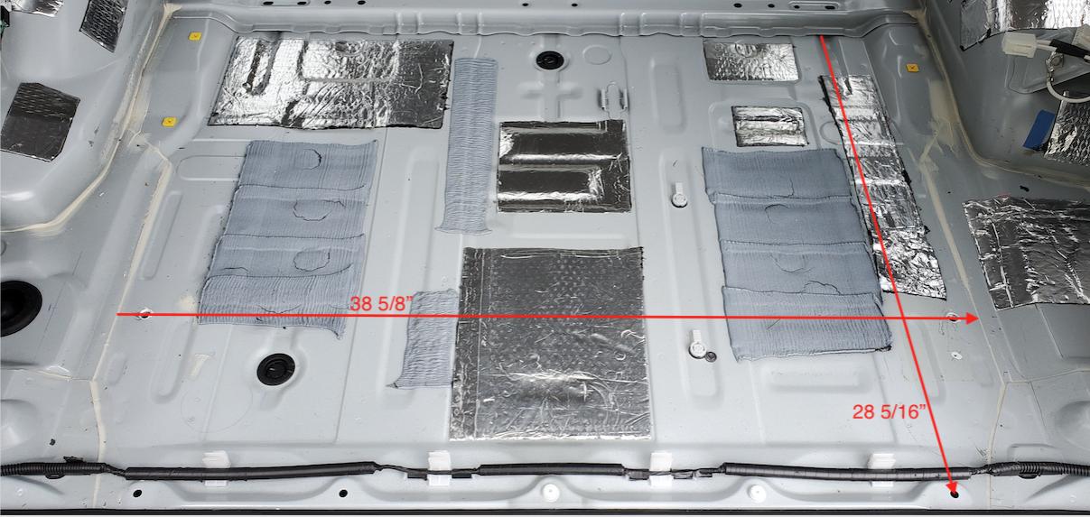

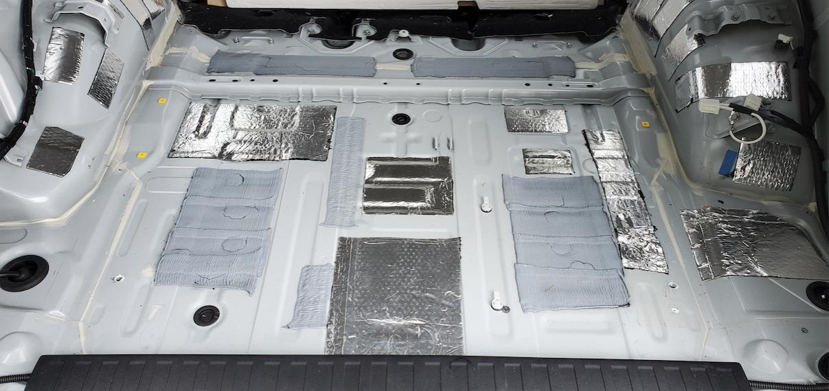

Did you happen to take any photos of the bare trunk floor? If so, I'd love to see them. I want to install an amplifier under the sliding cargo deck and will need to trim some carpet to mount it to the floor so as to allow clearance for the deck to slide over the amp. The layout of the trunk floor would be very helpful. Thanks!
Here are a couple pictures of the cargo area floor with the carpeting and Styrofoam pad removed, taken while standing behind the rear bumper.
The side-to-side dimension of 38 5/8" is between the white lines where one piece of sheet metal overlays another (the short red arrows in Post #1 above).
The front-to-back dimension of 28 5/16" is approximate, within about 1/16". On my vehicle, the flange at the base of the crossbar near the center of the wheel wells and the row of 5 holes near the rear hatch are almost parallel, but not quite.
I took out the OEM inverter mounted on the passenger side wheel well. I also started putting in a few patches of (aluminized) soundproofing material; I won't be blanketing the whole floor with soundproofing.

Thank you! That helps massively! I think with a cutout in the carpet, I can get the amp low enough so the cargo tray will clear in when sliding.

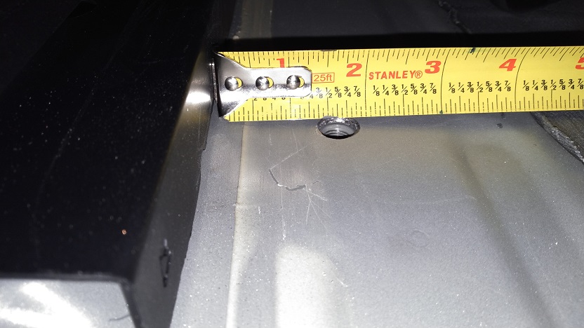

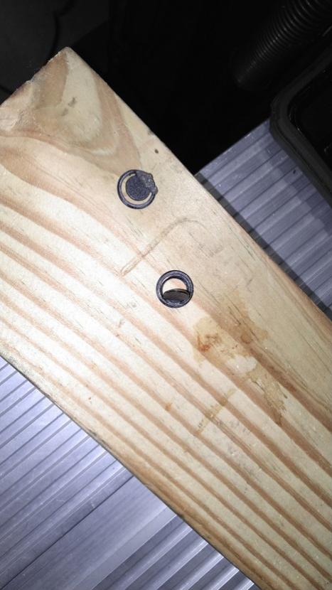

Was gonna start a thread but since this one is the same, here's some extra info that might help since they can get rendered unusable if not lined up correctly...

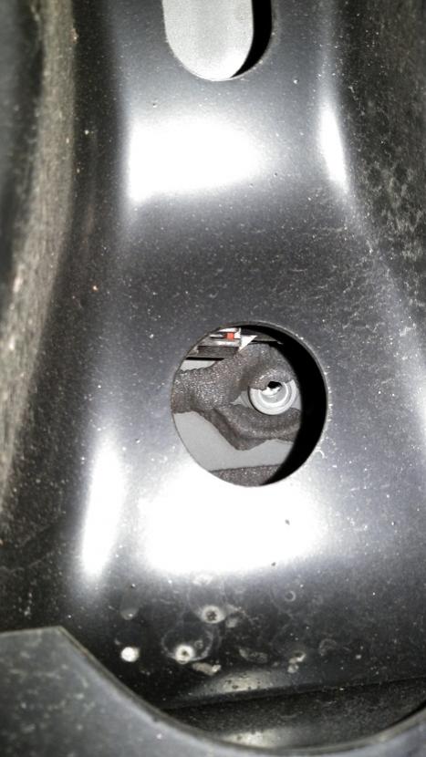

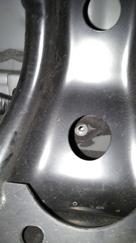

Here is what you'll see from the bottom. Look at the far L and R side of the beam, through the hole in the pic of the next post, drop the spare to get access. There will be a cover of sorts like this. Just sort of stuck on there, easy enough to pull off with a pair of needle nose so not in the way.

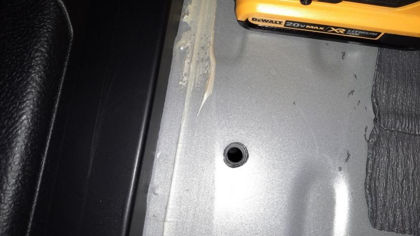

Bolt hole bottoms from underneath.... Only easy access is through the hole in the pic. I used a 9" punch from the bottom through the hole to put an indention in the floor to get an idea where to drill. As has been mentioned in other threads, start with small bit. You'll be at an angle and can somewhat center it but don't bet on it being centered when drilling from the top.

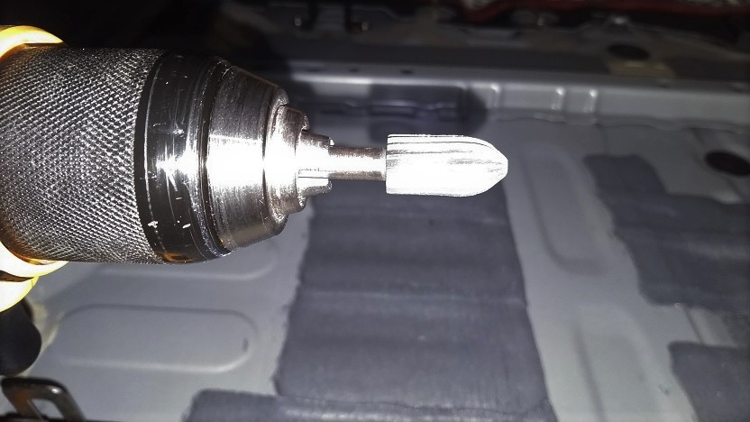

I did try larger bits to make the hole bigger but was still off from center. What worked good was having a rotary file bit for my drill. It is a pointy rounded end of sorts that lets you make the hole larger but can manage it around the edges so as not to damage the threads. The is maybe a 1/8" or so from the top of the threads to the floor so have a little room. Finished the edges with a pointed grinding attachement on the dremel.

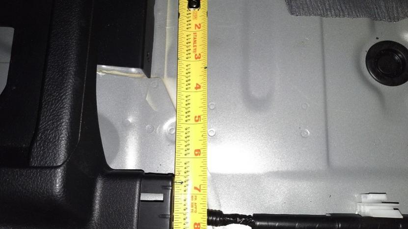

Able get it done clean and a few more measurements to give an idea where they are trying to locate from the top before drilling. Didn't notice til posting the pics, the top of the indention is right about the same height as the hole so may be a good reference.
The center of the hole is 6.5" ish from the front of the plastic you'd see after removing the rear trim piece. Bolt thread pitch is 1.25. Can pull one of the rear seat mount bolts for reference to get new ones for the holes. Same size. Another thread I saw mentioned guys just putting 1/4 x 20 rivnuts in the holes you see exposed once the carpet/trim is removed. If you have the hardware for that, is easier but if not or prefer to use these, hope this helps.
