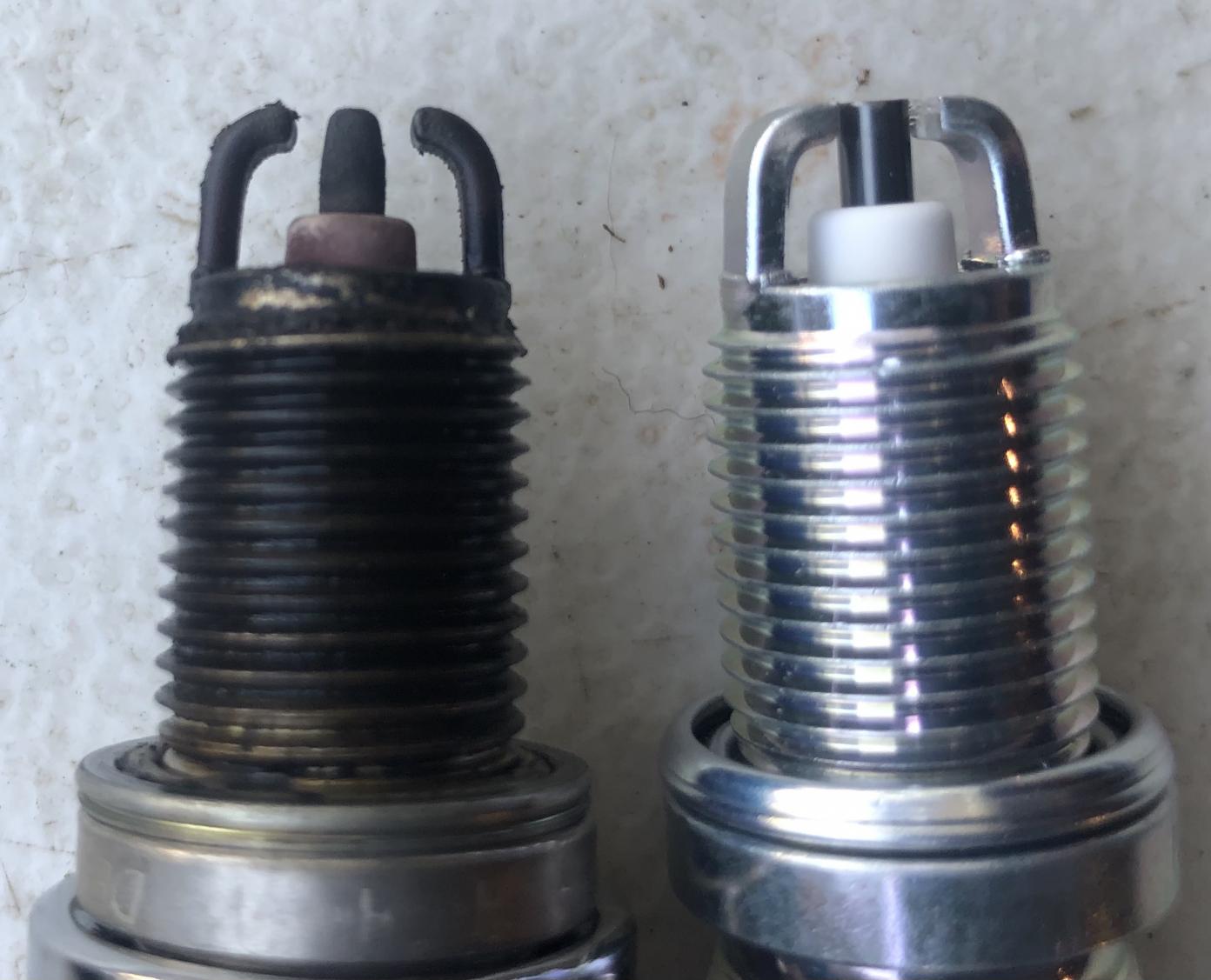

Injector leak can also be a cause of long cranks. Wouldn't hurt to inspect the spark plugs for black suit.
That’s an interesting point. Here’s a pic of one of the plugs I changed last month. Does this look like a sign of an injector leak?
Any tips on diagnosing the leaking injector?
The only way for me was to OHM the injector, one of them was lower than the rest so I could only assume that was the problem one. I had replaced the fuel pump before trying to solve the issue, among checking for vacuum leaks, etc. I ended up just buying injectors off ebay and sending them off to Witchunter. I was having issues getting it smogged too because of it.
It'seems to be. Check injectors to' see if they are with in spec specially number one cylinder.
