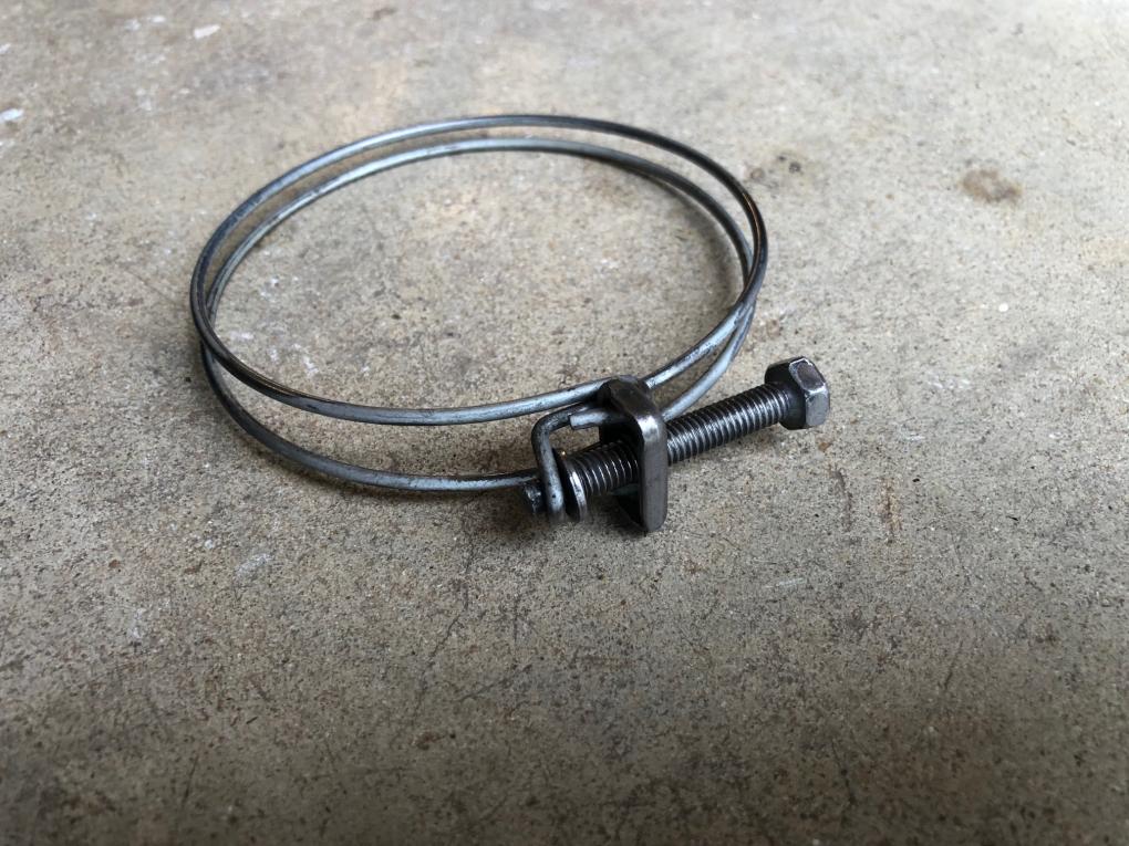

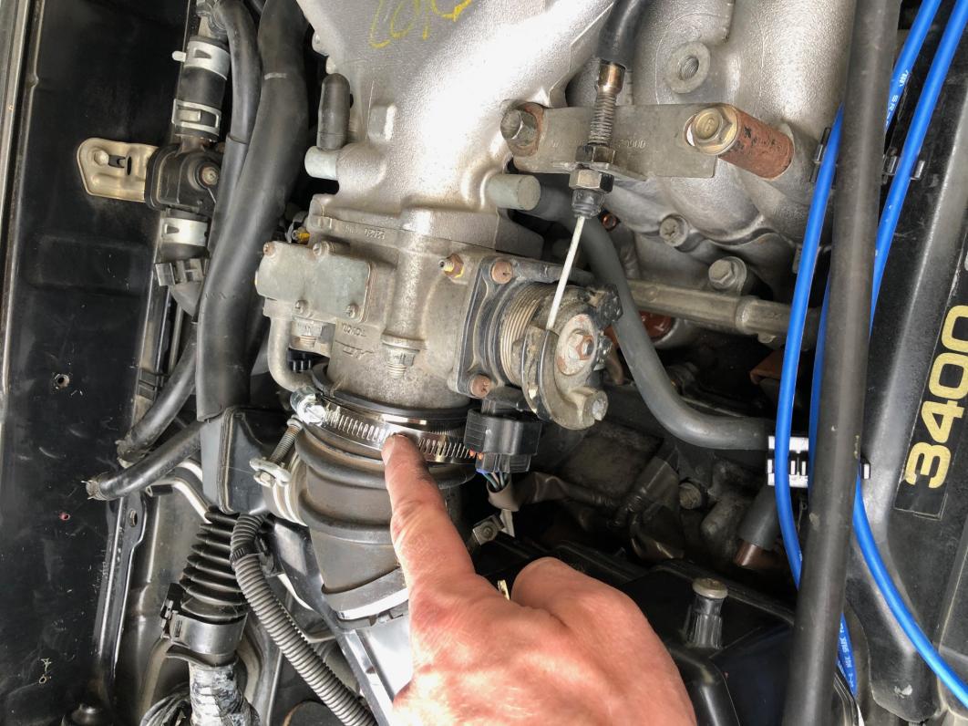

The problem is solved. And I'm not real proud of myself for throwing so many parts at it. I'm good at taking things apart and putting them together. Not so good at diagnostics.

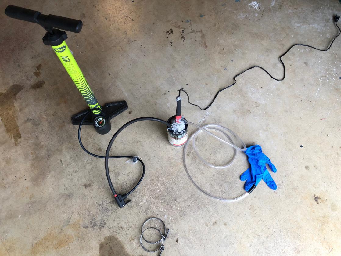

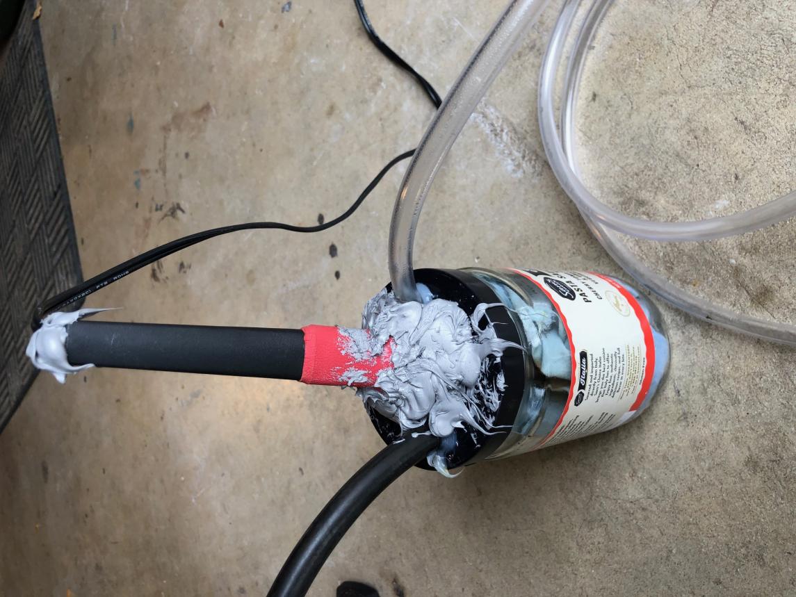

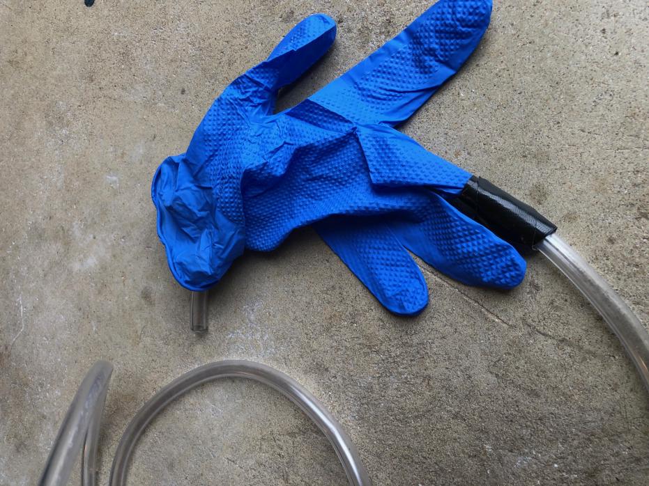

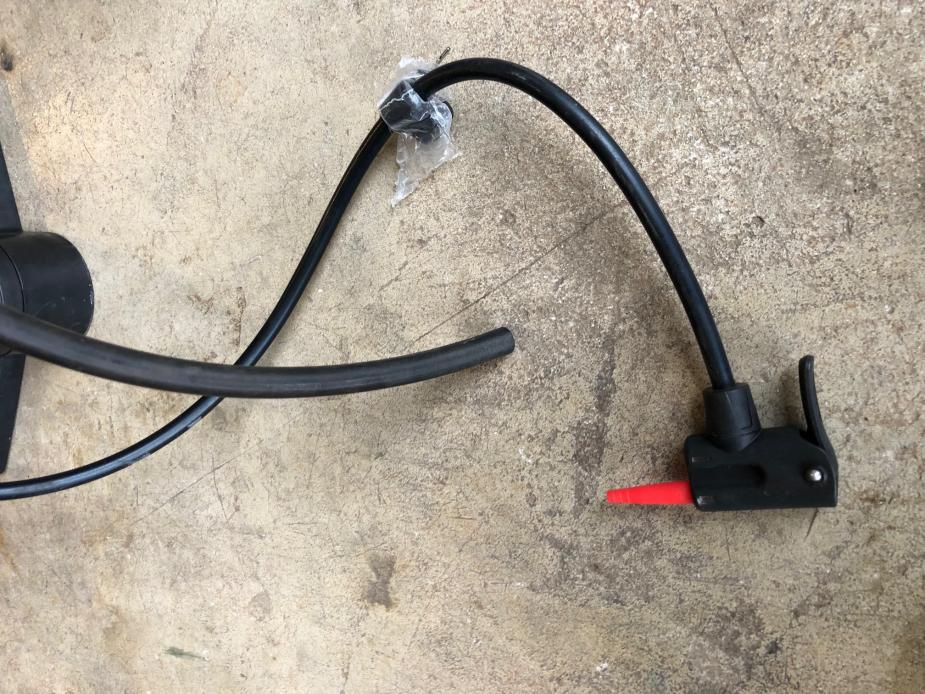

The problem turned out to be a vacuum leak from a worn out hose clamp that secures the air intake hose to the throttle body. I found it with a homemade smoke tester that I mostly copied from this guy
https://www.youtube.com/watch?v=L9CDZ9lu6Rs
Pics attached. Here is a link to a video of my tester in action with the smoke escaping.
IMG_1928.MOV - Google Drive
The vehicle also had a slightly rough idle when warm. More of low grade rumble. That appears to be fixed as well.
If anybody has a long crank or rough start, for the love of all that's good, please start by changing the stupid hose clamps :-)

Yes the ECU does not like air bypassing the MAF.
Somewhere on here I posted the normal idle air flow reading of the MAF. Anything less is a vacuum leak.
I don’t recall you posting it, but it’s in the manual and the value was within spec prior to finding the leak. Spec is 3.3-4.7 gm/sec at idle. Prior to repair it measured 3.64. Now it’s 4.07.
