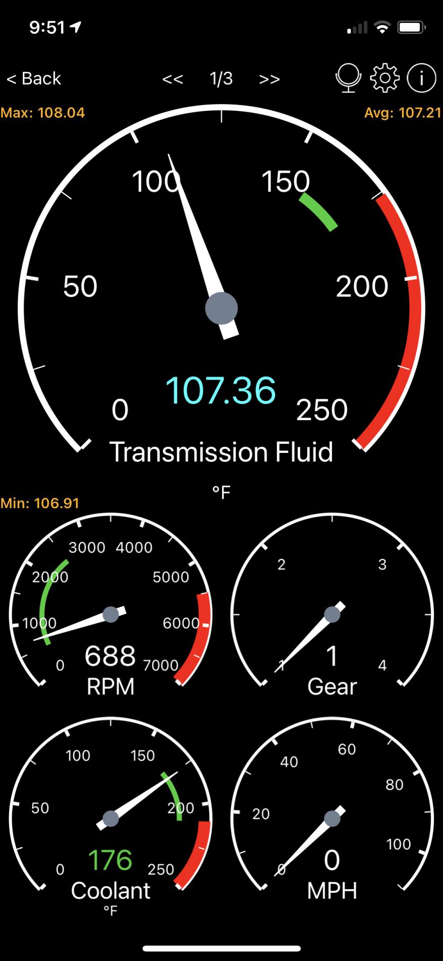

I have an iPhone and I use Car Scanner Pro. It’s freemium:
Car Scanner ELM OBD2 on the App Store
The app has some really good features and you can customize dashboards. See the photo, that’s the dashboard I leave up every time I drive. Keep my phone up in a dash holder.
And I use this Bluetooth OBD2 unit:
LELink Bluetooth Low Energy BLE OBD-II OBD2 Car Diagnostic Tool for iPhone/iPod/iPad and Android. New: Configurable Auto On/Off Amazon.com: LELink Bluetooth Low Energy BLE OBD-II OBD2 Car Diagnostic Tool for iPhone/iPod/iPad and Android. New: Configurable Auto On/Off: Automotive
Wow! That’s awesome. I’ll check it out. Thanks
