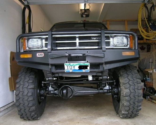

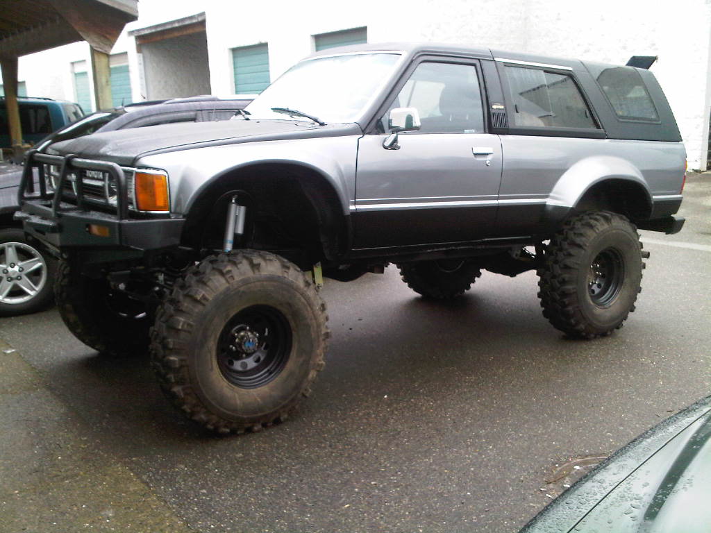

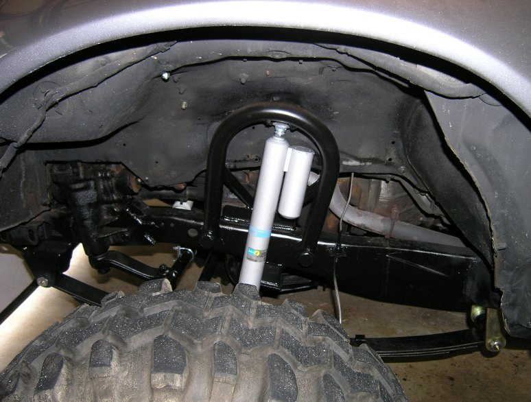

I got my SAS done last week. 3" HD TG springs, sterring box and axle moved forward 2", Bilstein 5150 shocks, TG Creeper Gussets, axle truss, knuckle wipers, etc.
Sitting a bit low in the back here as all the IFS stuff is in the back and the front springs have no miles on them:
In the garage, barely:

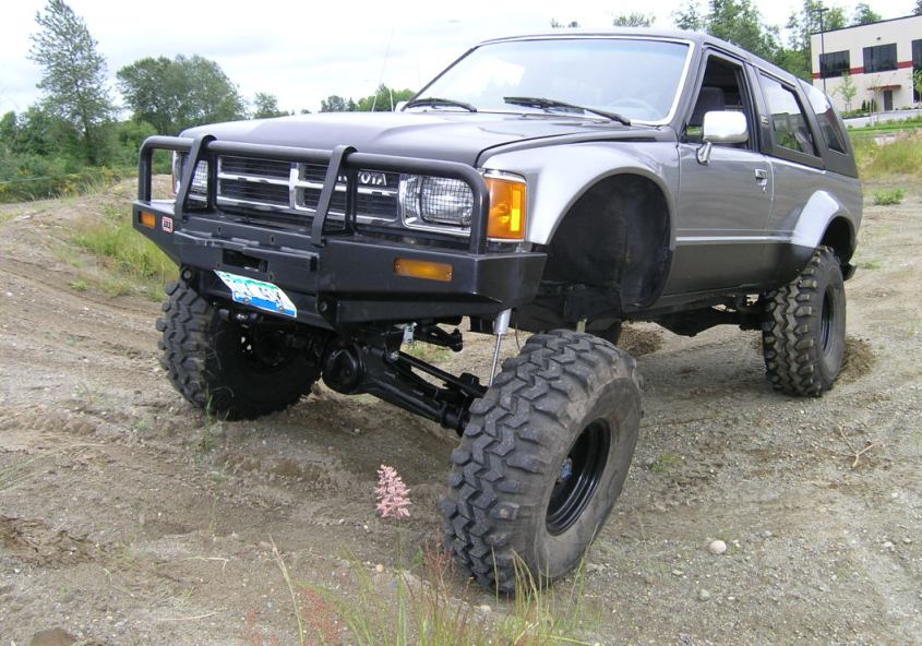

Out flexing a bit in some sand. Still waiting for my front driveshaft since they put the 'early' CV flange on it with 8 mm bolts and all my other flanges have the 10 mm ones. Locker kept it going, though.
Some details. Nice work by Custom 4x4 bumpers, Toyota solid axle swap, Rock sliders, 4x4 parts - Big Country Customs

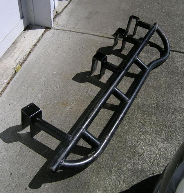

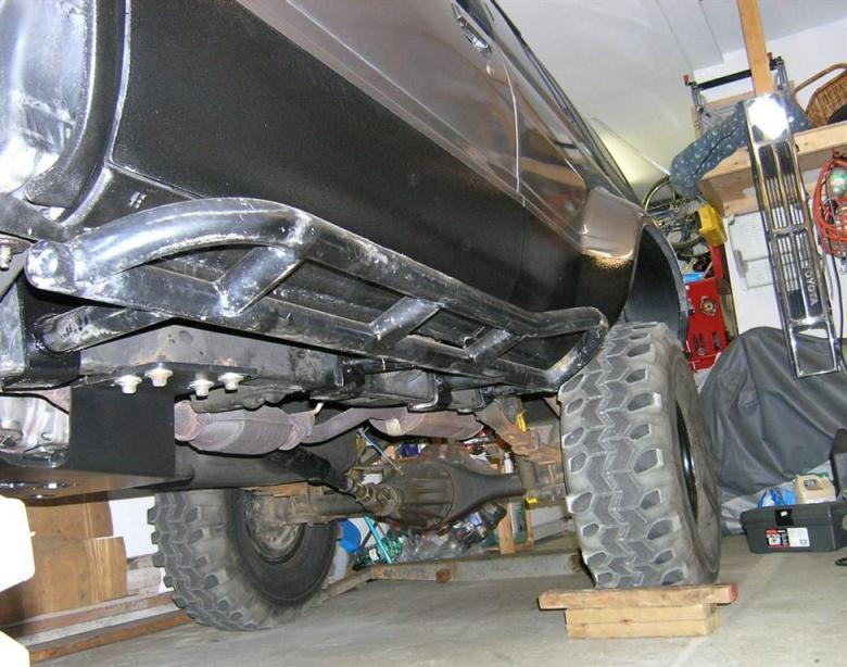

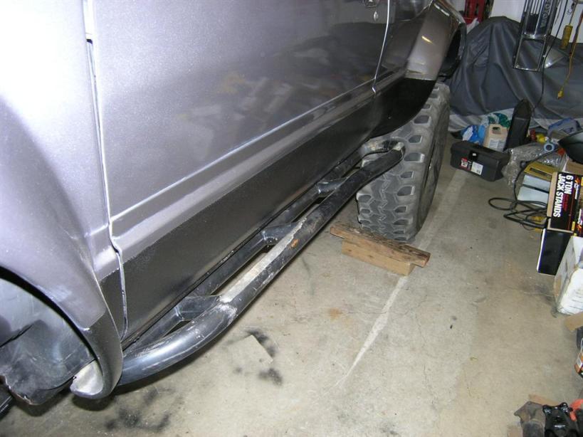

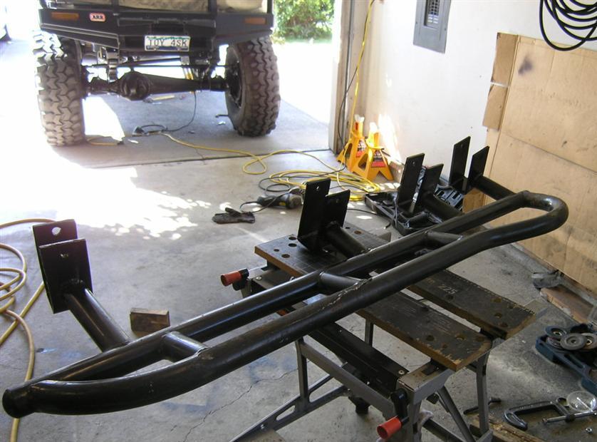

Got my slider 'bolt-on' brackets done today:
and installed
Next project is the bumper install.
Should get it done tomorrow

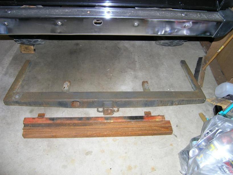

Old stuff removed.
P6160504.jpg~original
Ready to start assembling.
P6160508.jpg~original
New stuff installed. Had to install new spring hagers as the springs are 9" longer than the originals and the OMEs. I rotated the rear diff about 6 degrees to use a double cardan rear shaft.
