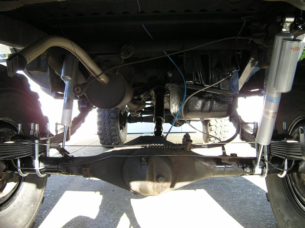

The back end is working alright but the 12" 5150 shocks are too long in the stock location with the 4" TG springs. I will eventually put in a new cross member but, for now, a change to 10" shocks will do. I also still have the stock exhaust. It was a 'lifetime parts and labour' replacement from Toyota in 1989. I think I've had 4 free ones since then. They don't offer that option anymore. :)

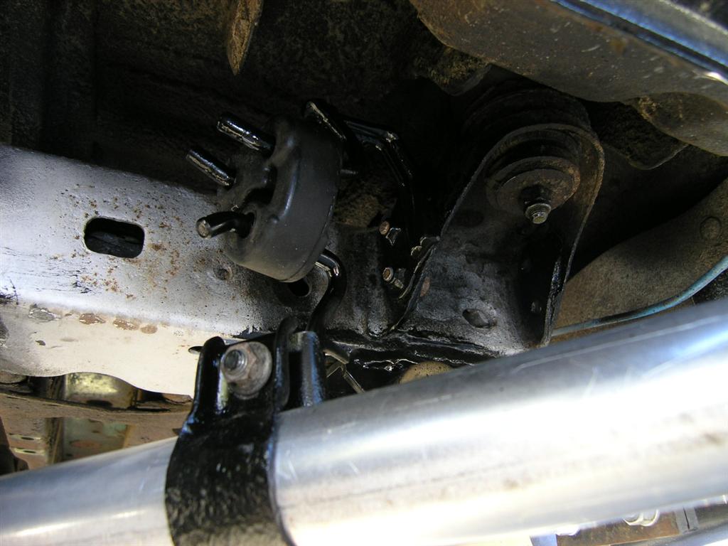

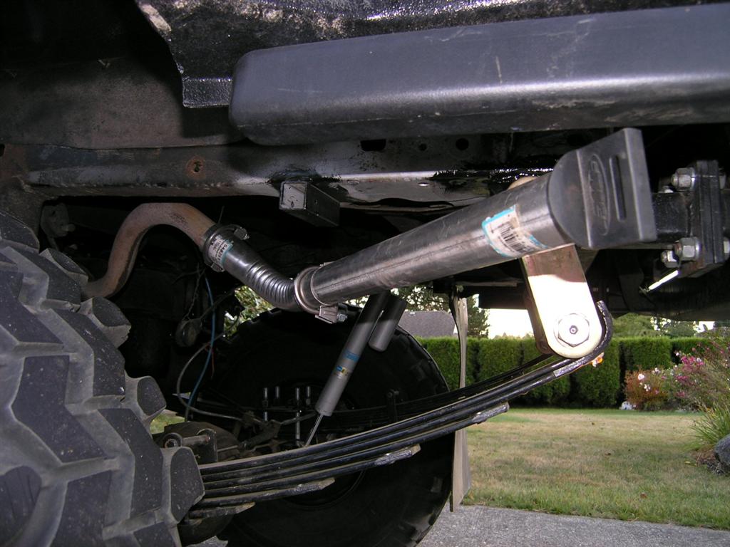

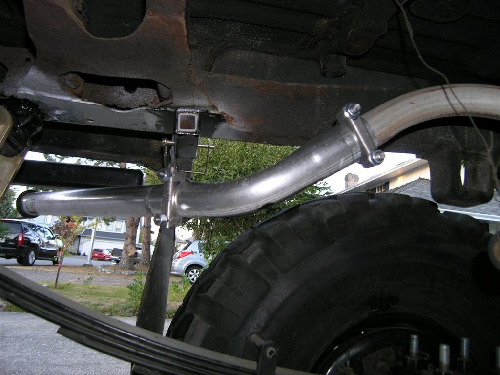

I had cut off the stock tailpipe to clear the relocated TG shackle and wanted to fix it. I picked up a universal 45 deg. elbow and pipe from Canadian Tire and extended the pipe, keeping it as high as possible.

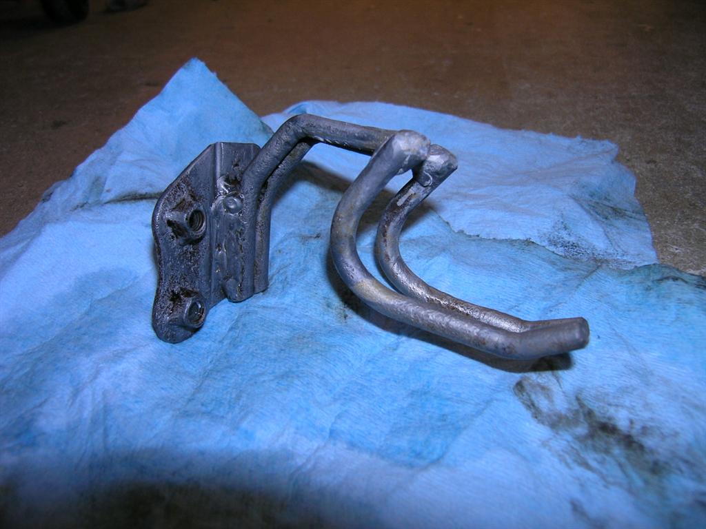

I wanted to keep it as close to stock as possible so I cut, shortened, flipped and re-welded the stock hanger to keep the rubber hanger. Here it is after using POR 15 Metal Prep.
And finished
Helps with the clearance and is still legal.
I still need to extend the parking brake cable supports so the cable doesn't drag on the spring pack and the shock boot. Will post a picture with the 10" shocks. I switched from 5150s to 5100s to save a bit of space. Will go back to the 12" later.
