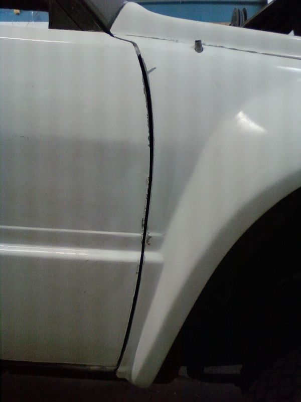

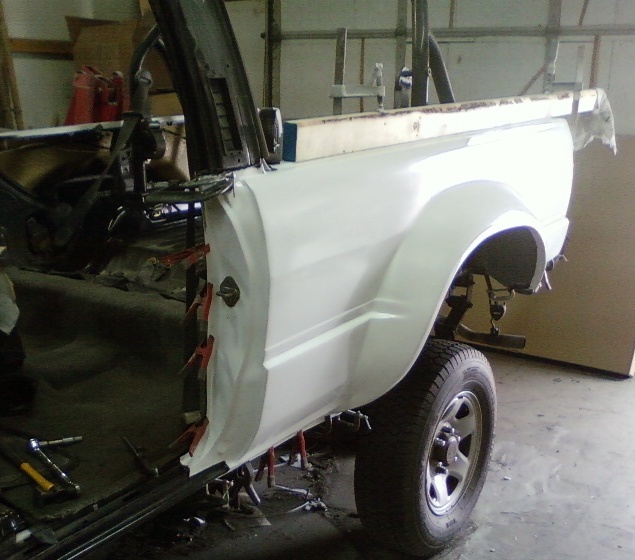

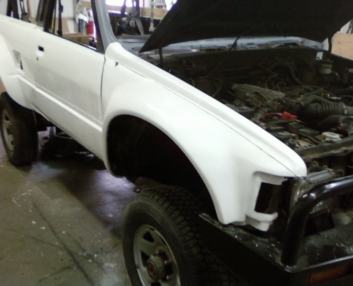

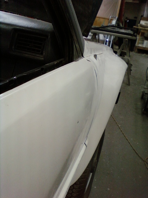

More progress: Got the body panels bonded to both sides. Body lines look great!
Driver's side:
Passenger side:
Should be ready for paint soon.

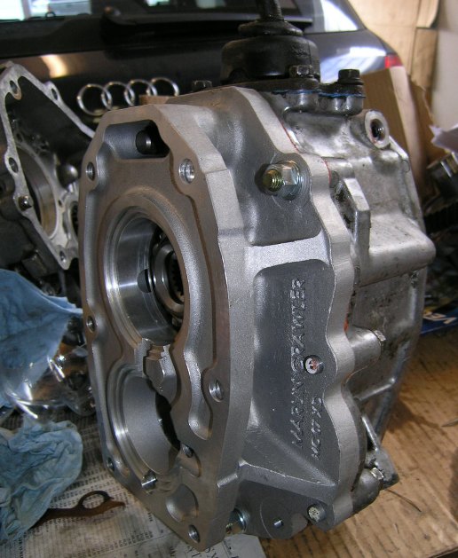

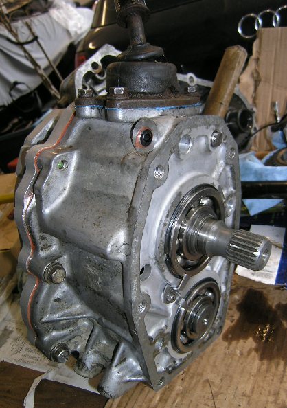

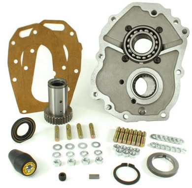

Did some shopping today... Marlin Crawler has a sale on their MC07-XD dual case adapters until Friday, so I ordered one. Should have it in a week or so.
Thought about going with 4.70:1 gears and 23-spline input to the rear shaft but I think it would be a bit much and the gears are back ordered until July so I went with the 21-spline input.
Time to clean up my spare transfer case for surgery.

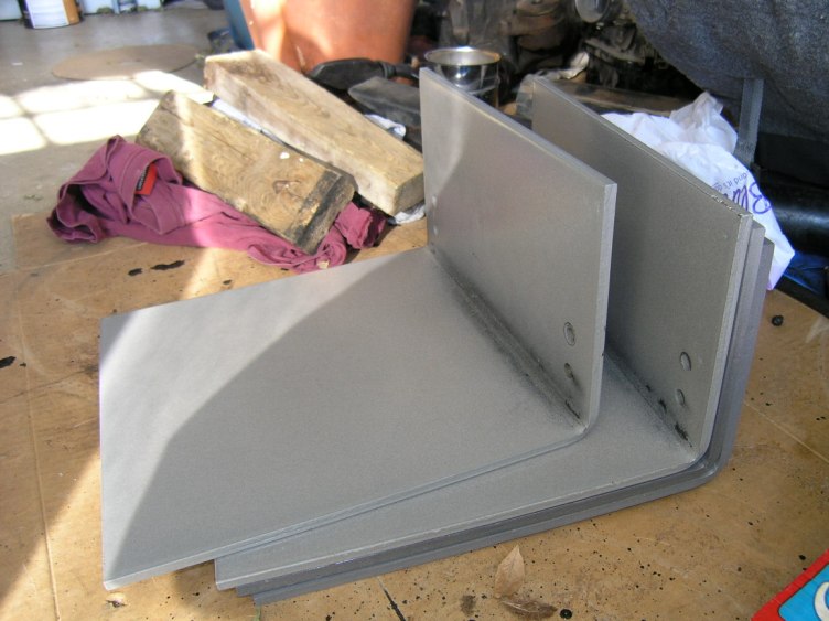

Picked up some free steel from work today. The pieces are 1/4" thick and about 12" x 19" without the bend. Going to cut these up to make bolt-on brackets for my sliders, four per side.

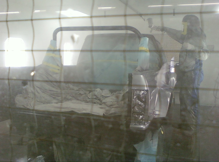

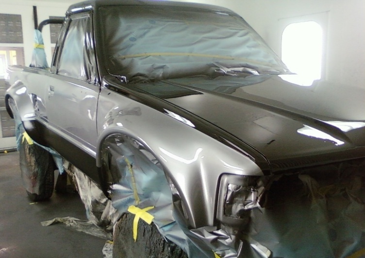

The truck got the clear put on today.
And just sprayed
I'm getting excited to get it back...

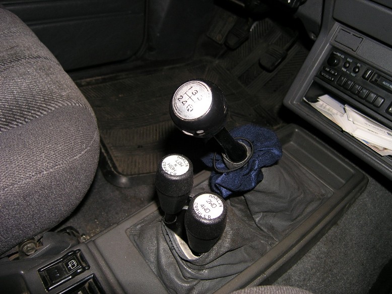

Got my MC crawl box built this weekend. Need to figure out what to do with the centre console and heater next since the box moves the twin-stick back about 6.5" and I don't want to lose the heater or the rear window / wiper switches.
Rear view:
Front view:
Current:
I might just extend the console by about 4" and let the relocated twin stick eat into the plastic a bit. Will see.

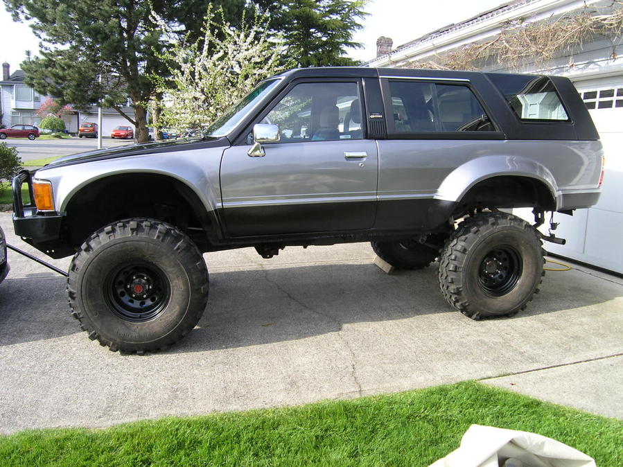

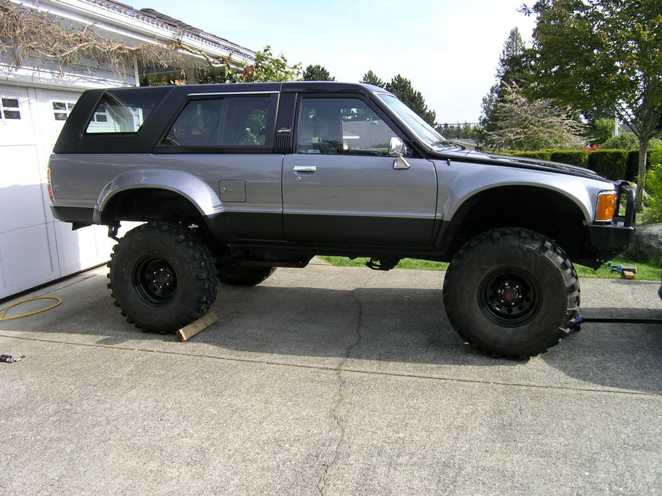

Body done!
Finally got the truck home and the tires on. Looks awesome!

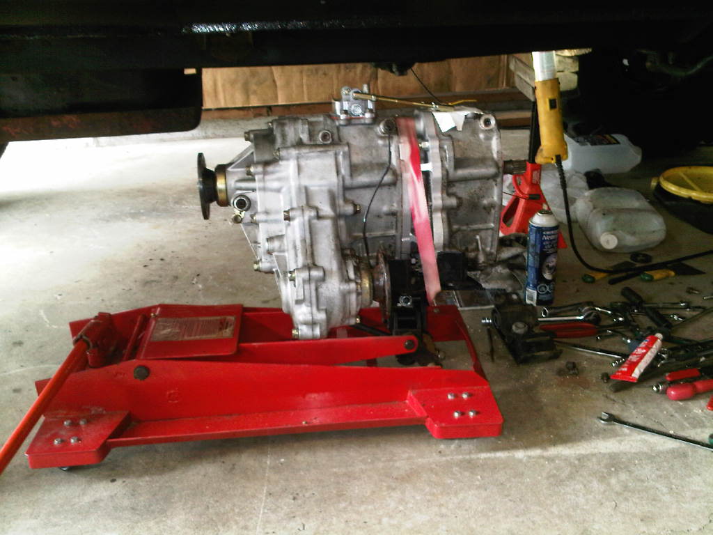

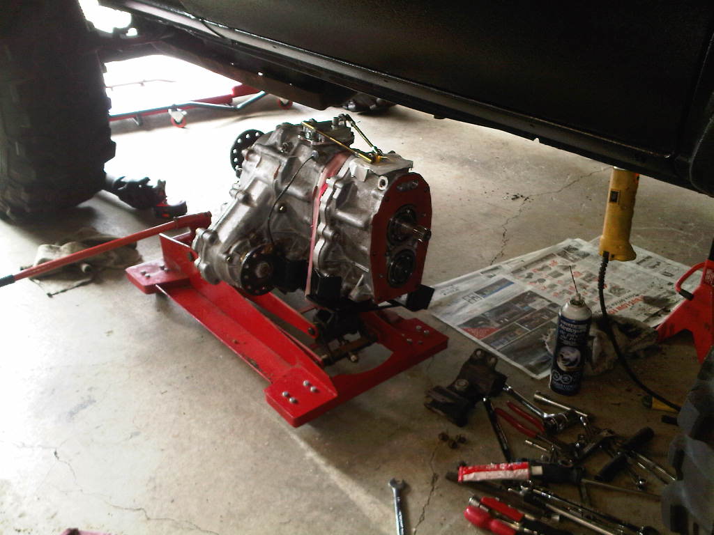

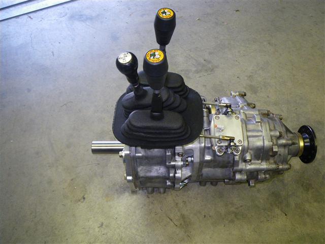

Got my dual cases in on the long weekend and my $20 spare driveshaft fit right in! I had to drop the 6 degree wedges out of the back since I usually run a double cardan rear shaft but I may leave them out if the u-joint shaft runs smoothly. Just getting my shifters fugured out since I want to keep the console as close to stock as possible.
Borrowed a tranny jack which helped a lot.

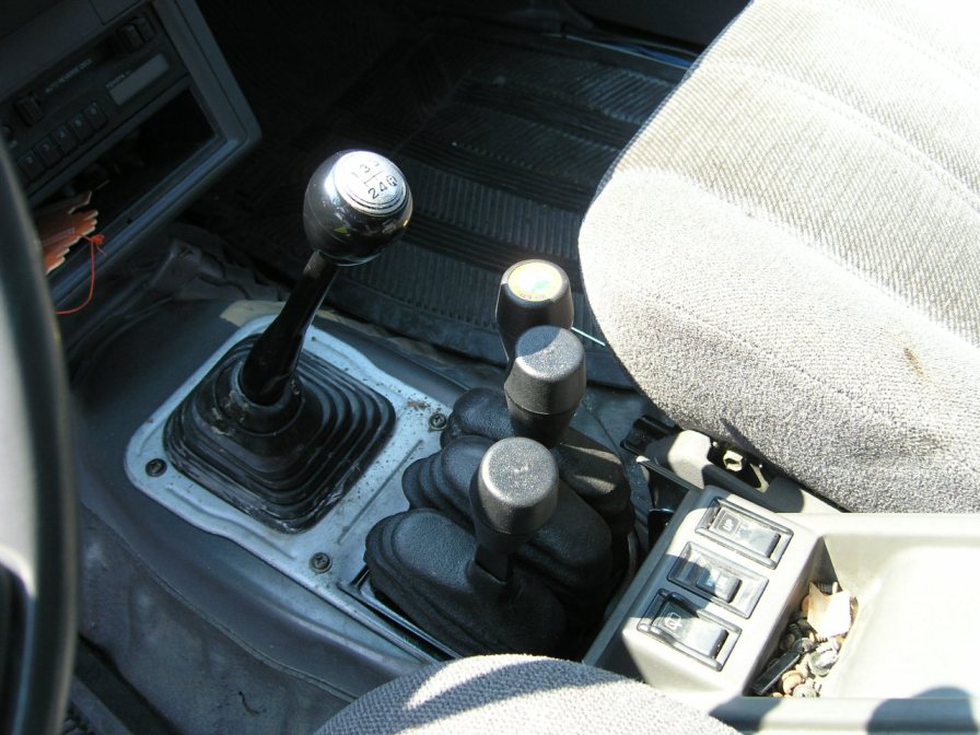

Shifters:
Need to figure out how to get my console back in there to keep it looking stock (ish).
