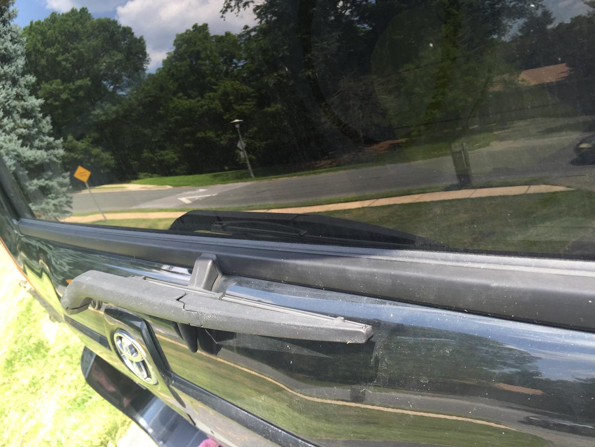

Hi everyone. I been lurking on this site for the past year or so. Really haven't contributed much b/c i am still learning. I own a 2004 4runner ltd and the clip I am looking for is the clip that joins the two pieces of weather stripping for the rear lift gate. Here is a picture. If someone can help me it would be appreciated.

I think it comes with the upper part of the weatherstrip and not a seperate piece. This is a one piece strip that goes up one side, over the top and down the other side. The part number for the upper weatherstrip is 68275-35020. You can get it for $82 at toyotapartsoutlet.com Double check that part number though.
Southernbike is correct. Check out this link 2004 Toyota 4Runner - Toyota Parts Barn (click engine type, then select body hardware, then select view all diagrams. near the bottom is the rear lift gate window diagram)
It looks like the clip you are looking for probably comes with either the upper half (part 2 on diagram) or the lower half (part 3 on diagram). You can also try looking around this site to see if you can locate the clip https://www.clipsandfasteners.com/Toyota_Lexus_Clips_And_Fasteners_s/13.htm

thanks everyone for the reply. looked at that clips and fasterners site but couldnt find it. (cant really justify $82 on a clip when i dont need the whole weather stripping). tried looking a wreck in local area, but couldnt find one.
Those two clip-looking things are on the lower piece (part is around $20) not on the upper part. They aren't really clips, they're actually molded into that bottom-of-window "belt w/strip" thing, to join it to the $90 "run channel" (the rubber part that surrounds the top and side of window). It's part #3 here 2003 TOYOTA 4RUNNER Parts - ToyotaPartSales.com . It takes all of 15 seconds to replace... roll window down, get inside hatch and close door... pop old one off with screwdriver, press new one on.

I have clips
Just replace my rear weather strip (Lower). I have the clips. Let me know if you still need it.

This is correct. I just replaced mine. It's part of the lower belt piece. Easy part to replace.
