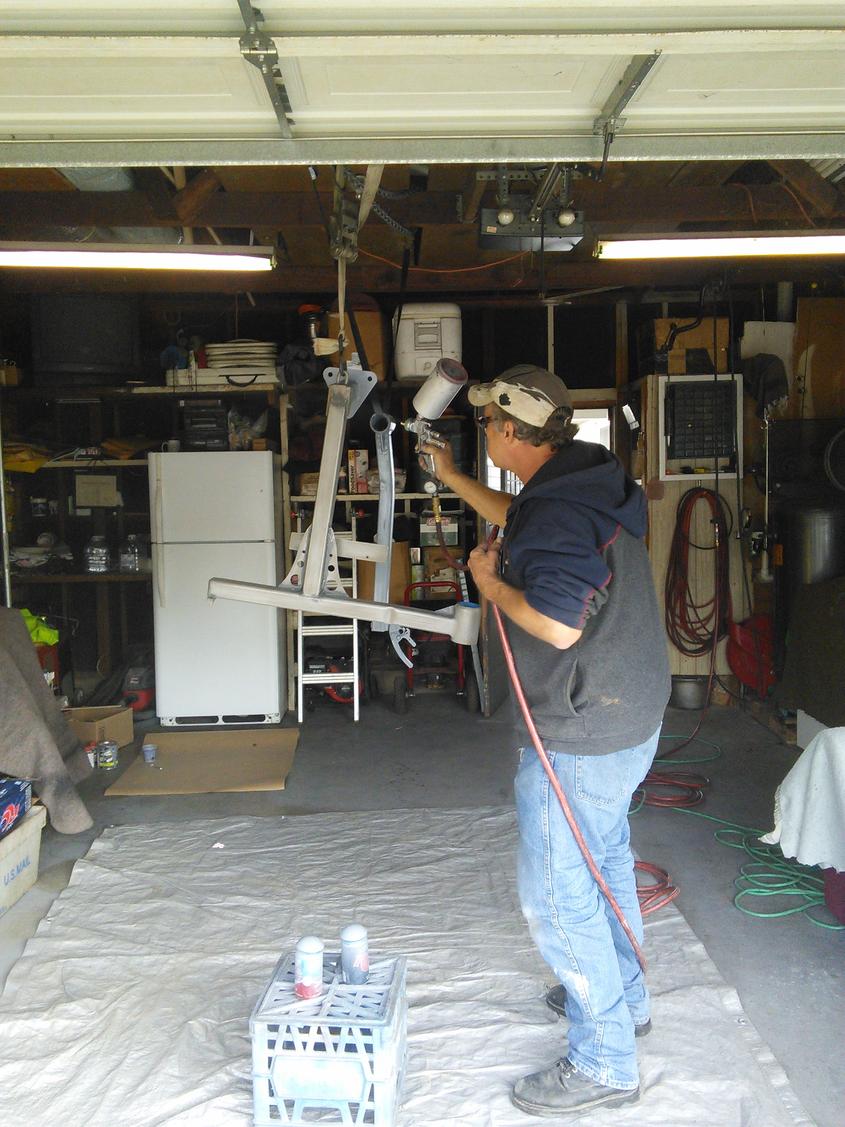

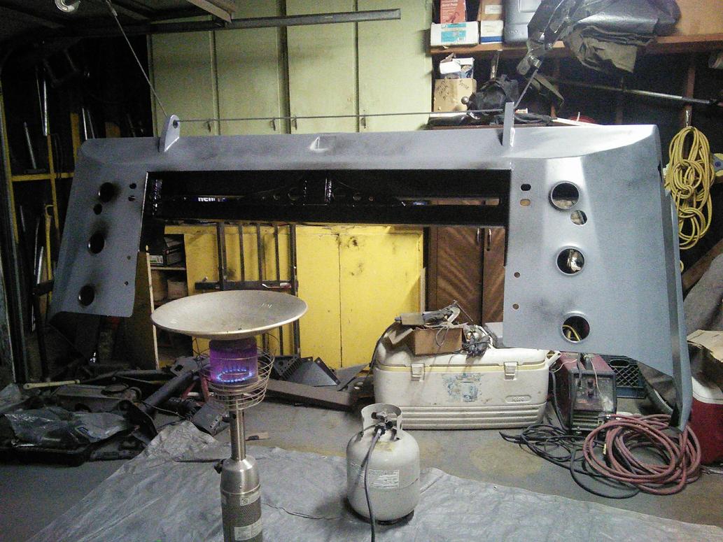

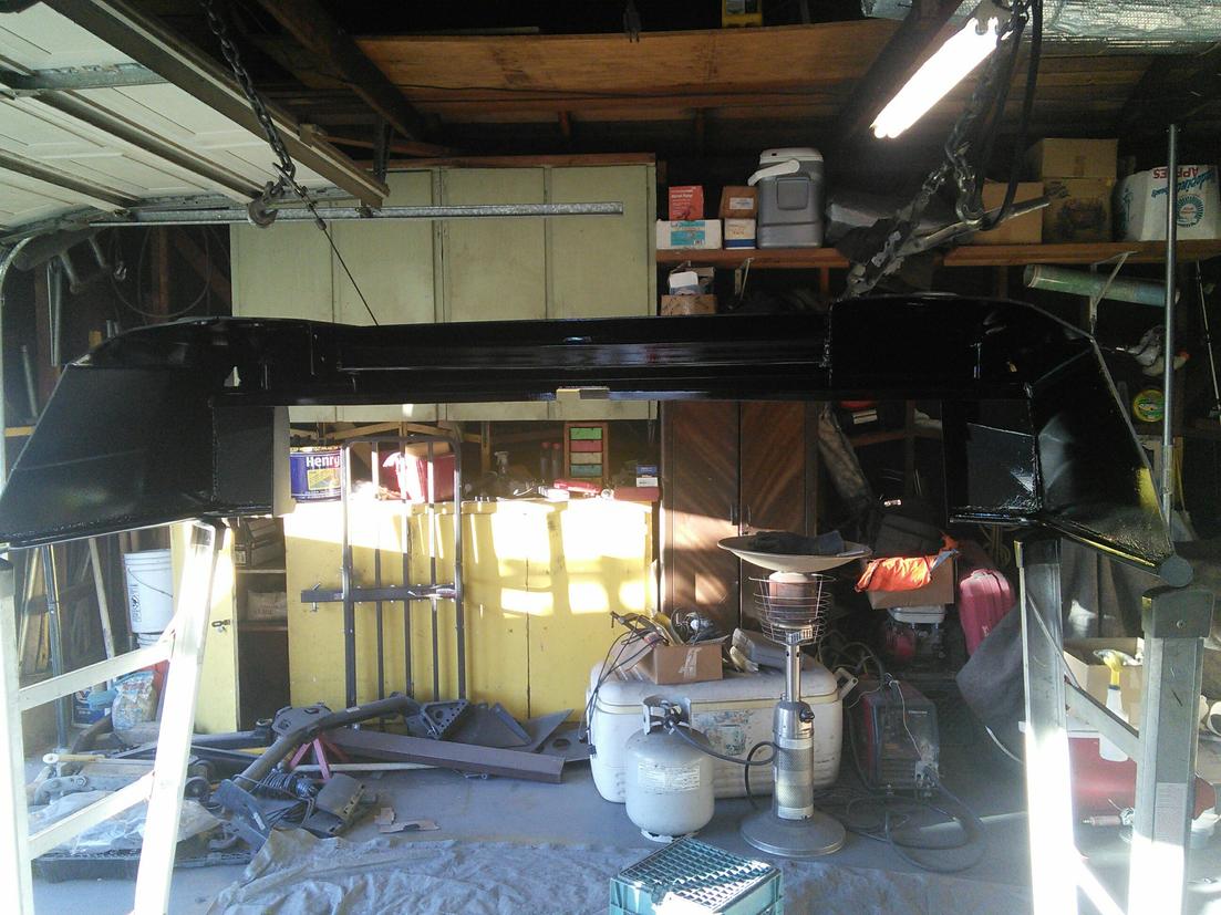

OK, some more teasing for you. All primered and just painted the inside. Going to shot the out side tomorrow. Still working on the swing arms and attachments that I'm adding.

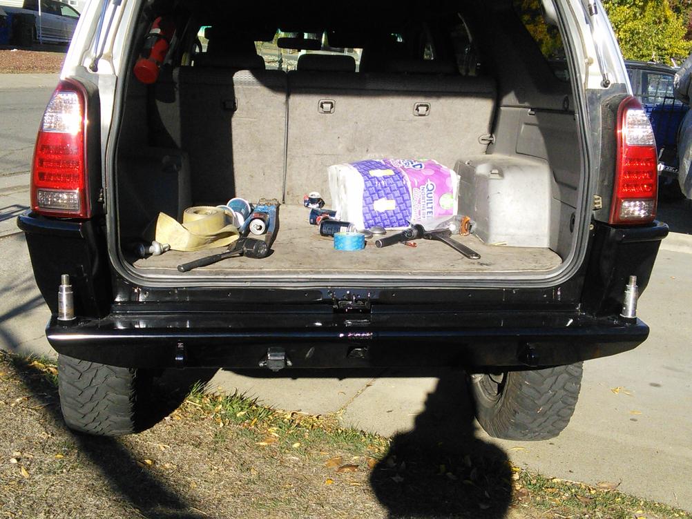

Wow:wow: man that looks great! Really good work :thumb: I'm jonesing even more now!!! I also just picked up my Welder yesterday so i'm just going to take this a sign that it's meant to be haha :pray2:

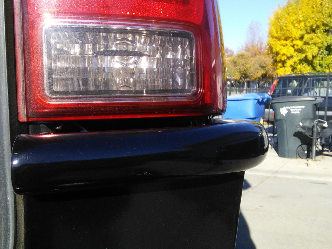

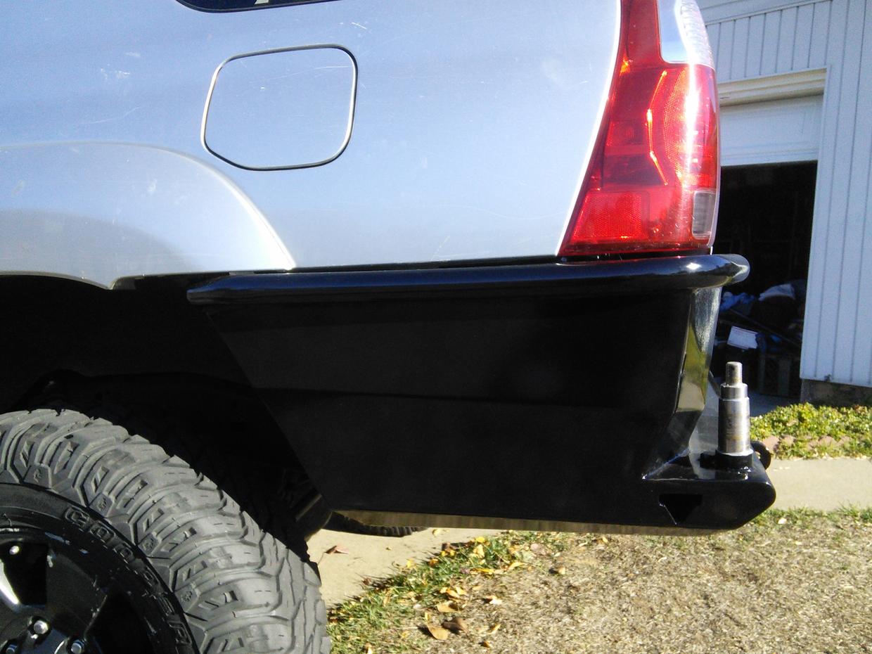

Thanks, much appreciated. Took awhile putting them extra touches to it, not only welded, but built the welds up to be able to grind them down on the edges to make it look like a molded 1 piece. Do need to do a write up on this incase anyone else decides to do one of these LABS bumper.
Sorry I gave you the Jonesing, LOL. Good you picked up the welder, it comes in handy for a lot of things. Cutting up what you have and modifying what you have already comes to mind.

Yeah it really came out great! I can only imagine the detail and time it takes to weld something like that, It really does look all like one piece. Can't wait to see the write up and your tire carrier all finished and mounted up.

My buddy taking care of business on the swing arms.

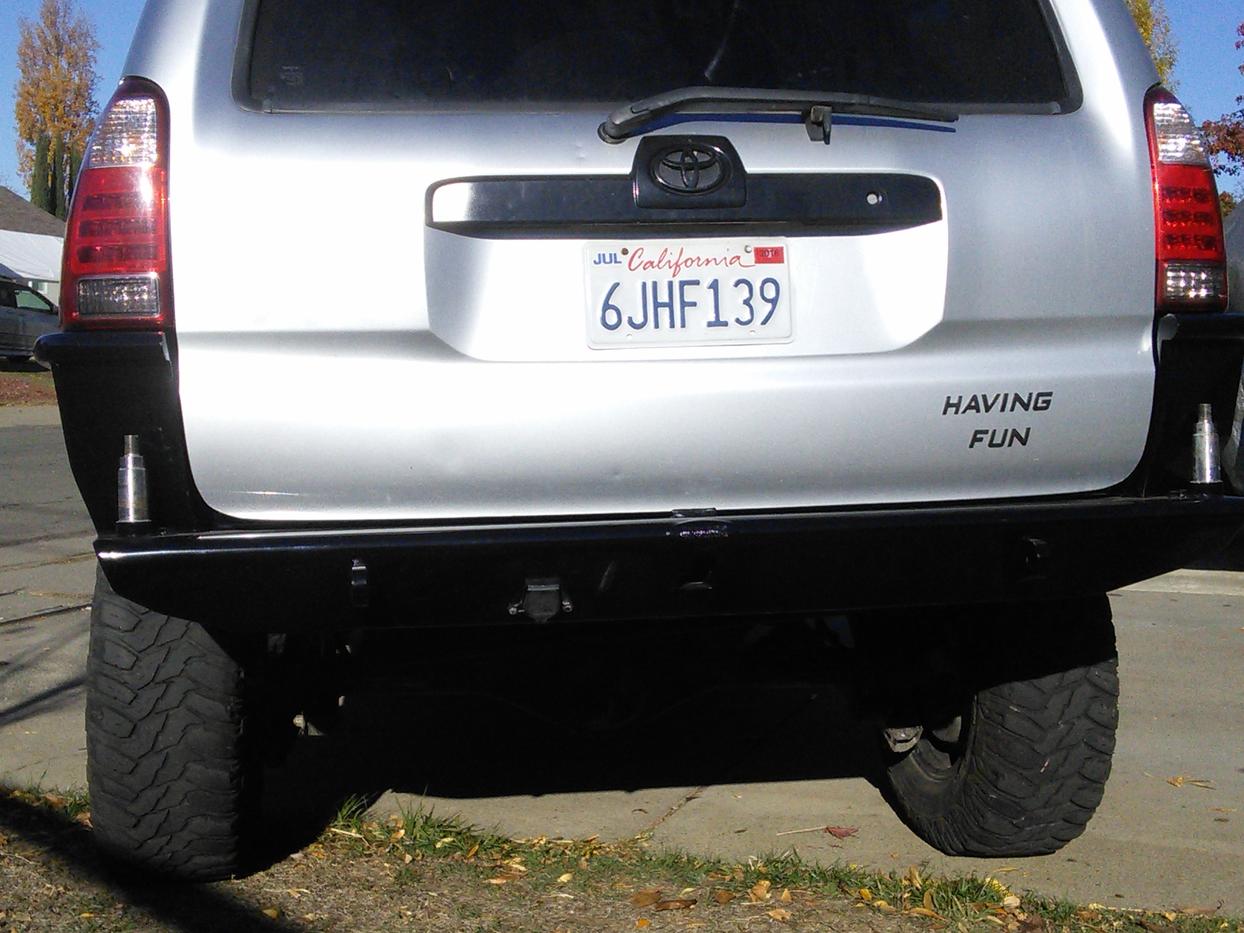

Any updates? I'm very interested in one of these bumpers. I really like the solid sides you had them make. Much better than the version on the first photo.
Thanks for posting pics. Definitely interested in a write up or general suggestions.
I spoke to one of the guys at Labs and he said the tire care flexes a lot. He thinks the flex comes from twisting in the swing out. Any ideas how to keep that from happening? Did you battle it on yours some how?
I suggested that he sleeve the square tube with round tube and plug weld it.

As far as your ?, I have only done some clearance flexing at a loading ramp to see how much larger tires I can do and how much cutting off the wheel well area I might have to do and basically snow runs, no 6+ rated trails yet.

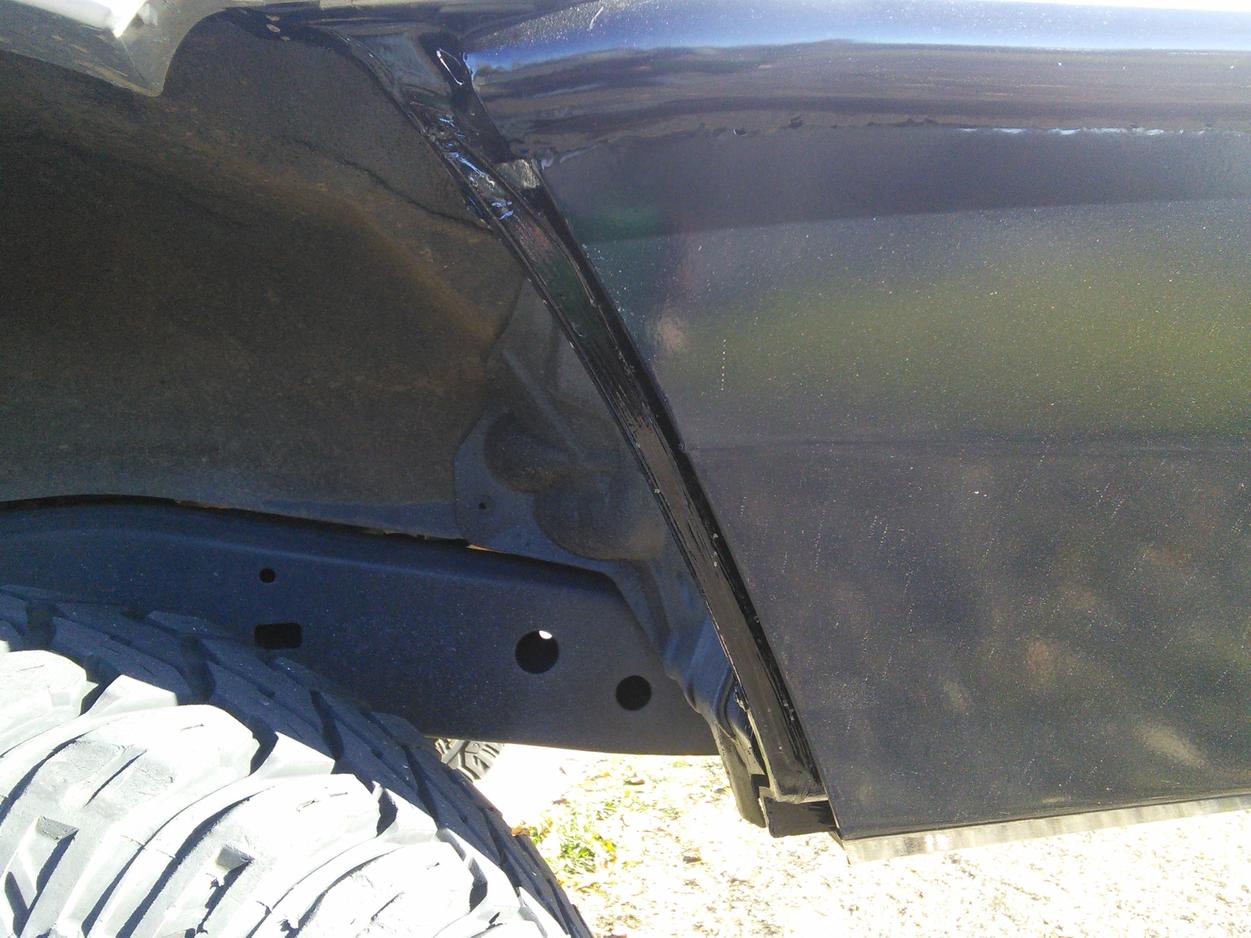

I do believe I have a picture as to where I add a gusset from the arm to the spindle housing due to I was doing preventive measures.
I made a comment as to the position of the stop position that should take care of the bunny hop that has happen to me once due to flex. Another thing I will have to address and build up a bead to over come, so there probably is a little flex issue as above statement of mine.
Side impacts are the only issue so far as I have no side/wheel well supports that Darklight I do believe posted also.
Any ? you have go ahead and hit me up and if you need other photos.

Theres the link. Thanks for the info. Have you finished the bumper?
