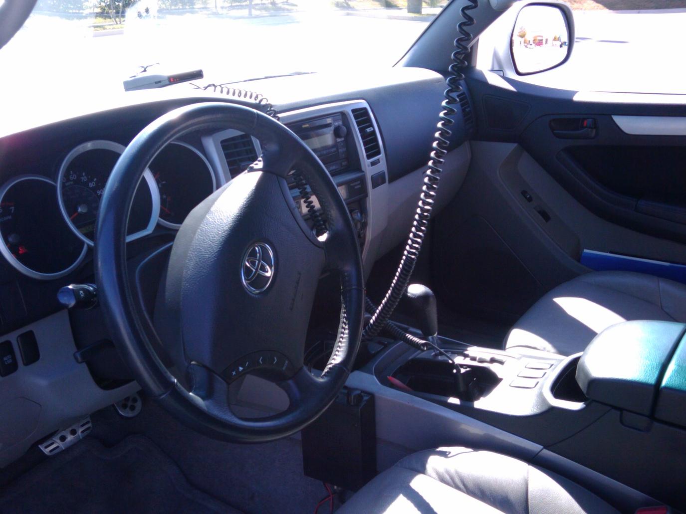

Sold it because it didn't get used, but I had a cobra 75 wx st remote mounted under the center console with the plug in the cubby under the consoler lid release lever. Had a 5' whip mounted to the hatch with a comet rs-720 lip mount. I used a K40 cable with removable tip, passed through the drain hole in the bottom of the liftgate.
Here's a pic of the antenna mount, it's the only pic I have of any of the setup.

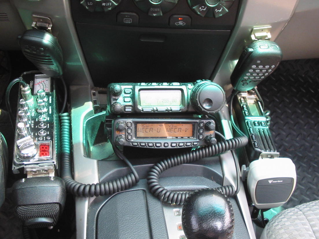

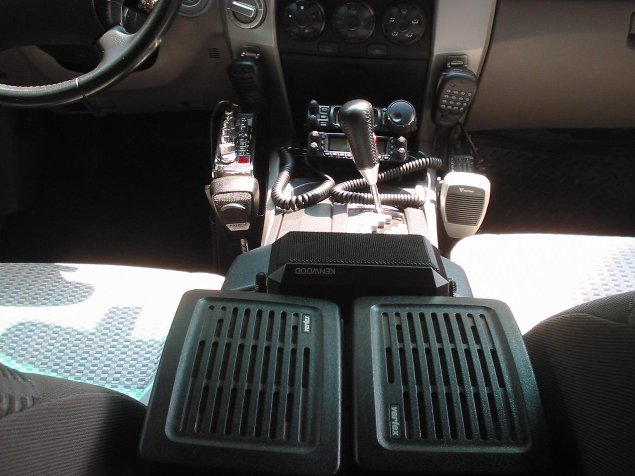

Here's my setup:
Radios (L to R) are:
CB - Galaxy 979
HF - Yaesu FT-857D (top)
2m/70cm - Yaesu FT-8800 (bottom)
GMRS - Vertex Standard VX-3200 (I change this out for a Kenwood TK-762G when I need MURS capability)

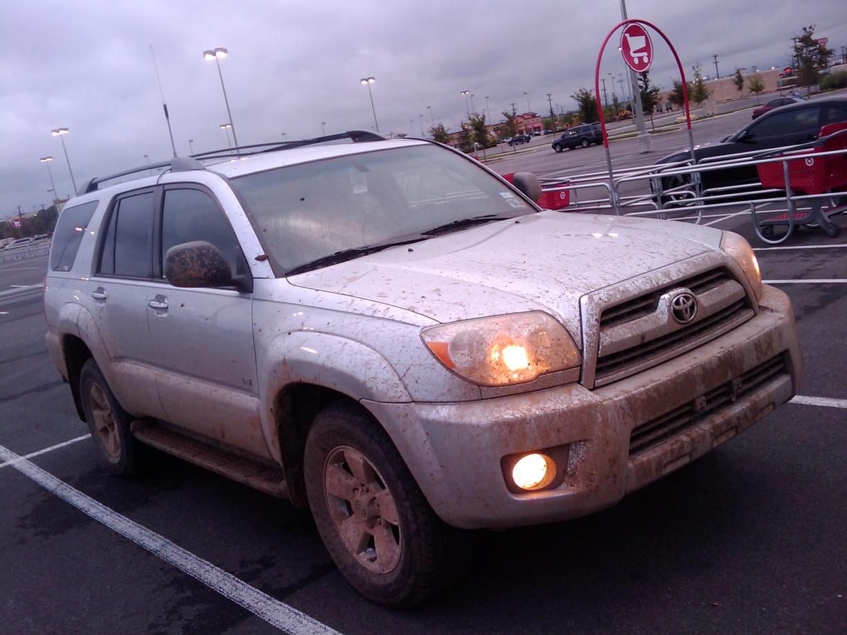

The antennas on the rear view are:
HF/6m (6m to 40m) - Yaesu ATAS 120a mounted to the L rear lamp guard
2m/70cm - Laird/Antenex dual band (140/440) permanently mounted
80m - hamstick mounted to R rear lamp guard (i do not drive around with this mounted but put it on today for the pic)
I hate..Hate..HATE using mag a mag mount for the GMRS/MURS antenna, but between the roof rack and moon roof, there was no more real estate to drill a hole. I looked closely at the the clearance of the moon roof and sheet metal of the roof when the it was open....but read some other posts here and decided against chancing it.
I know the mounting of the ATAS, hamstick, and CB sntennas are not optimal, but you have to consider other aspects as well - like overall size of the whip. I could put the ATAS on the roof somehow, but I did not want the $400 antenna wacking every remotely low hanging branch around here. I have worked Europe, Canada, and the Caribbean easily (from NY) and I like being able to look at it autotune from my rearview mirror.

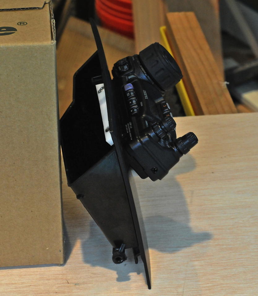

I "sacrificed" that greyish/silver piece of plastic that is the outside of the console sides. I totally cut off the support at the front to feed wires to the control heads that sit on a fab'd bracket in the cup holder dish.
For the radios on the side, I drilled holes on the driver side, but use heavy duty double sided 3M tape to hold the radio on the pasenger side. I don't always keep a GMRS or MURS on board so that space totally cleans up. The Vertex Standard and Kenwood are rather small and not too heavy, so 2 strips of tape on the mounting bracket keeps them highty tighty.
I also used that tape to mount the speakers to the center compartment between the seats, as well as the mic brackets.

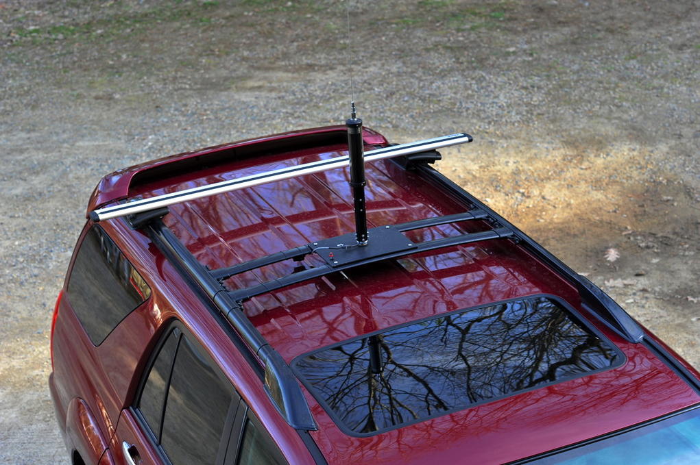

I put the antenna in the center of the roof using the OEM roof racks. Just unscrew it to remove it when not needed/using. Pictured is a short wave radio antenna but it could just as easily be a Firestick for the CB.
The faceplate for the Yeasu is mounted in the center cubby door and the radio itself is mounted up in the passenger footwell, up out of harm's way.
