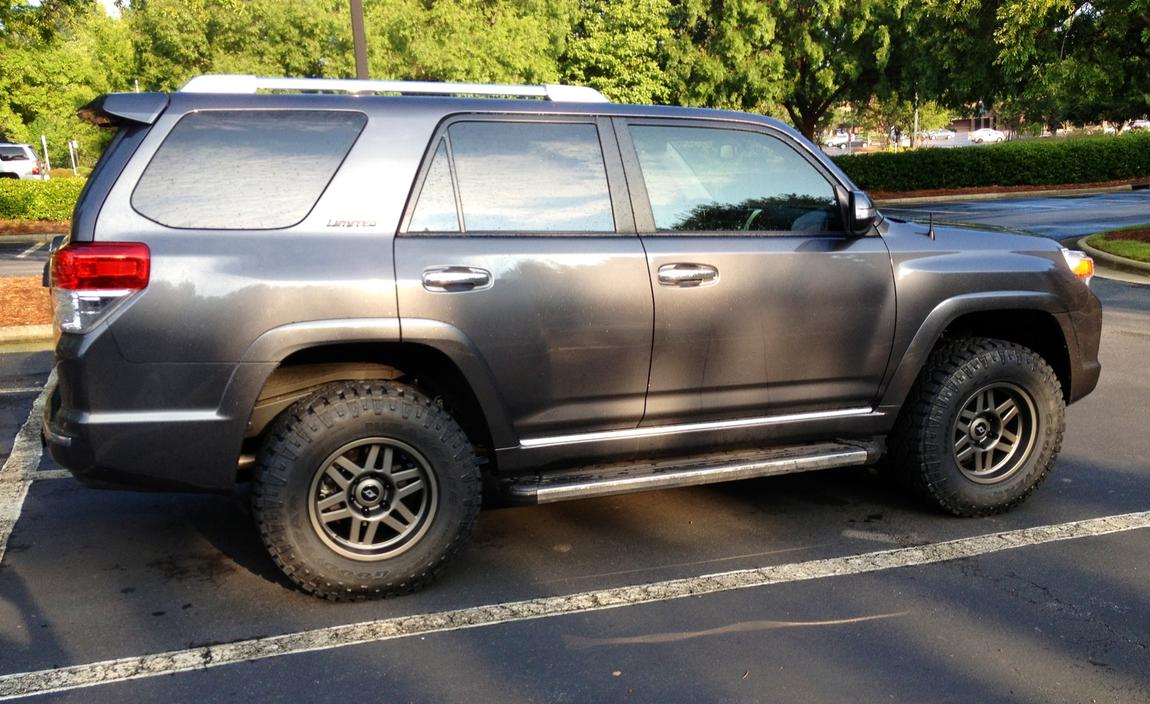

285/70/17 with Ultra Bolts on Bilstein 5100/5160's
IMG_0532_zps36733ca7.jpg~original
What wheels? I love those.
Thanks -- those are actually the Pro Comp 7069 I mentioned above... more specifically these 17x9s:
http://www.summitracing.com/parts/pcw-7069-7983
Note that I did have to get shank style lug nuts with a cone seat (sort of like a shank lug nut and a tuner lug had a baby). If you use just a tuner lug there you don't have a safe amount of threads on the 5th gen wheel studs with these wheels... the shank style gives you an additional 1/4" or so of threads to mate to.
