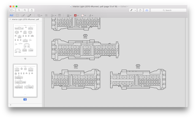

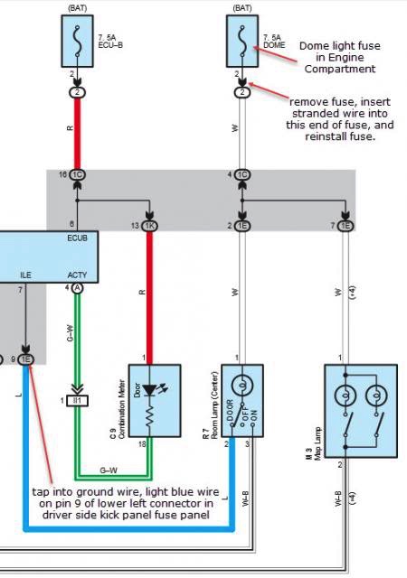

To trigger the LED with the open door command the tie is to the dome circuit ground switch. So the negative wire from the LED strip gets tied into the ground wire of the dome light. I've already switched out the dome light to a LED so the amp draw is reduced. I found the illumination diagram for the T4R.
Can anyone tell me the easiest place to tie in to the dome ground wire? It looks to be 2D pin 33 on the connector. I've pulled out the driver's side A pillar as an option but everything in there seems very tight to work with...

On my 09 Tacoma I tied into a blue wire in the driver side front pillar which was negative. Positive went right to power. The wires are very tight. No slack whatsoever. Don't know if our runners have same wiring color. There were two blue wires if I remember right it was light blue I tapped into,other one was darker blue.
Thanks for the info. Do your lights come on with door open chime/dome light and fade out?
Yes they did. I don't have truck anymore. Got the directions on Tacoma World forum. I had those lights that shined the Toyota emblem on the ground when you opened the doors. Got them off eBay.

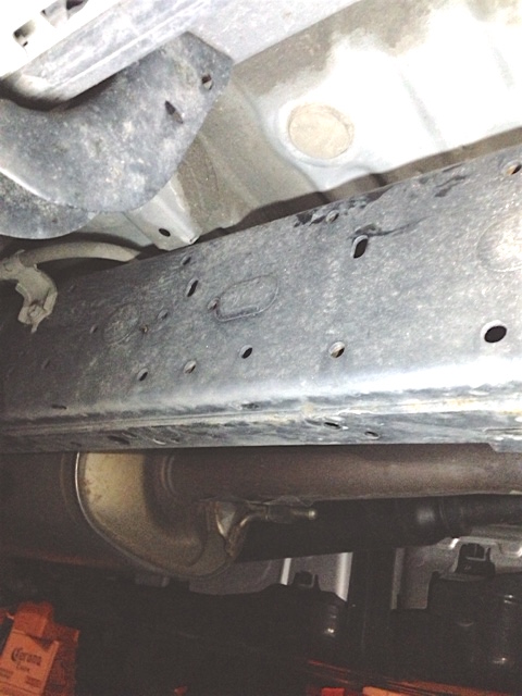

Well I found an access point for cabling on the passenger side. It goes straight into the cabin and comes up under the carpet. There are other rubber grommets below but this one is more direct.

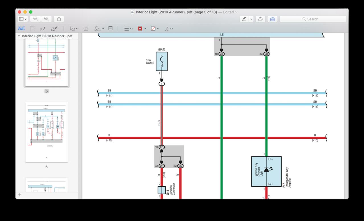

Getting the power from the dome light won't make it dim out. The ground wire does that somehow. The only problem with that setup is op want lights to come on when you open door and not have to turn on light switch. I have to look at mine and see what the wiring looks like in the pillar. I did this mod in my Tacoma.
I believe you're right. You have to tie to ground and that is what triggers the light. Others have stated that resistors maybe necessary ...
Page 5 of the T4R wiring diagram above has pin 2B wire 33 as -'ve from ECU to the ignition key cylinder light. I think that is where I need tie into to have fade work.
