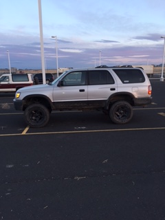

Not sure if this thread is allowed so if not I'm happy to remove it. I currently have 3" suspension lift and am running 265/75/16 Duratracs. I'm interested in adding a 1-2" body lift but I'm not sure it will look right with these tires. At this point I don't want to get any bigger tires so I am seeing if I should hold off on the body lift as well. Any input/pics are greatly appreciated.
This is how she sits now
Why do you want the body lift? IMO those tires will look out of place on your rig with that hight.
My 285/75/16 Toyos almost look out of place with a 3 inch suspension lift and a 2 inch body lift. A body lift would dwarf your tires

It would look ridiculous with that much body lift IMO, a 3" suspension lift alone makes 265s almost look too small.
A body lift will get you up there but it will still leave your rear axle the same height you are at now. I'm assuming your goal is to get your whole rig higher and not just the body. If this is true I would go with 255/85/16 tires. These give you a tad more height over the 285 and still provide decent mpgs. 255s are my next move.
Thanks for all the feedback guys. I figured it would look off and that's why I was asking. One of the biggest reasons I'd like to do a body lift is to correct the rake I have going on. The picture above doesn't really show it that well. I have OME 883s up front and Toytec Superflex with Bilsteins in the back.
I think that if your not liking the rake you have then maybe add some trim packers or put some bags in the rear springs. It looks like you have a reverse rake, (tail sagging)? But like you said it's hard to tell.

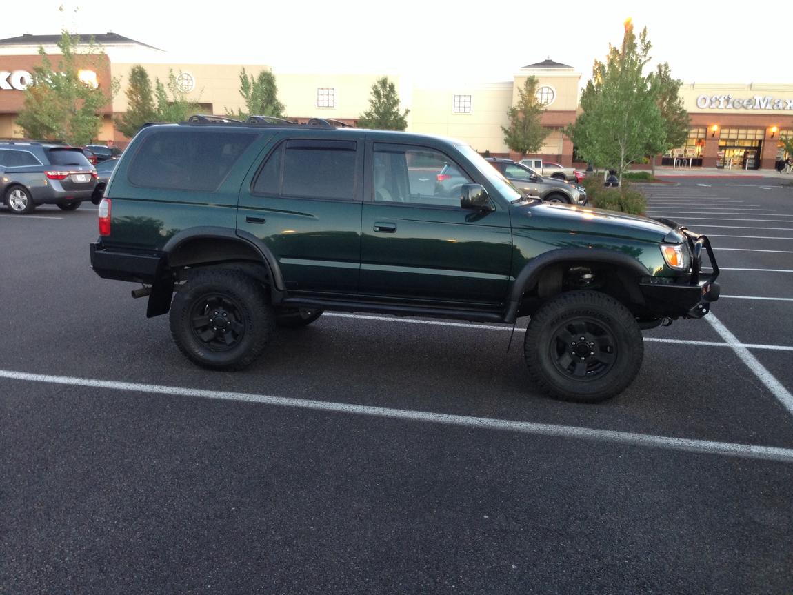

Here is mine with 3" + 1" BL on 265/75's. I do sometimes long for 285's but I also do enjoy the drivability of the 265's, I don't have the gear hunting issues some do. People have mentioned i "need" bigger tires but I stand by my decision. Only time will tell what size are up next install. It could go either way.
