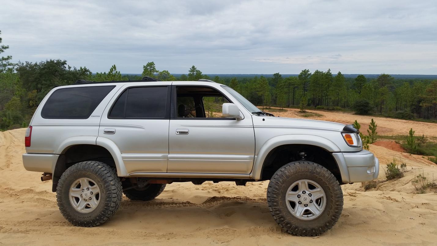

there are a lot of options out there. i researched a lot before i did mine, and glad now i spent the time. i ended up going with the ultimate coilovers up front from toytech for 3" in the front and 7 3/4 wrap LC coils with the bilstein long travel 5125 shocks in the rear for about 5". front diff drop, extended rear brake line, and 1.25" wheel spacers. it clears 285/75-16 duratracs with no rub. its close, but it clears. you dont want to go more than 3" in the front to avoid any extra stress on the cv's. its bad enough even with the diff drop. it sits just how i wanted it, and the ride is excellent, much better than stock. i would recommend this setup to anybody. i also recommend getting tires from discount tire direct. i got a great price, and we had a little problem with road force numbers. they sent me a couple of replacements for free to make sure i had a really good set for my runner. they were great to deal with.

this is my 2000 t4r. sorry it took me so long to reply. hope this gives an idea. i got all my stuff from toytec except the rear coils. they are from the junkyard, but the toytec superflex coils should be almost the same as far as lift.
