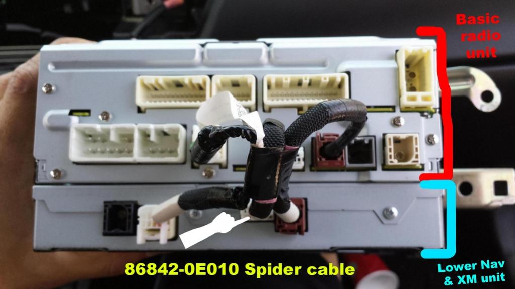

Solution: I read someone fixed it by removing the fuse for the radio and turning on the 4runner, then turning off and replacing fuse, that didn't work. What did work was i found what connector connects XM to the car, and then i wiggled it and pushed in to seat the connection. Turned on the car on in my garage and immediately the XM icon was back. I found a page about how to remove XM radio icon, and basically did the reverse of that LOL. I wouldn't be surprised if the cable runs behind the air or something like that. The dealer assured me the head unit is absolutely not removed when replacing the passenger airbag.

Credit for the image goes to this dude:
Is there a hack to REMOVE SiriusXM as a source? | Toyota RAV4 Forums

I did not have this issue on my 2015 4Runner, but on my 2017 Tundra I did. I installed the Rago dash plate, which involved taking the radio out of it's place for a few minutes. When it went back in, the XM icon was gone. I had not unplugged any of the connectors, so I was a little confused on what could have happened. I took the head unit back out twice just to check connections, pulled the fuse, and even called XM and spoke to their ridiculous "advanced support team". In the end, all I did was pull the HU back out a third time and reseat the antenna connection on the XM part(the bottom) and then while the radio was still hanging in my hand I turned the truck on and there it was back again. I wiggled that connection and it went away. I wiggled it once again and it came back, so I carefully put the radio back in place and so far it's still on.
