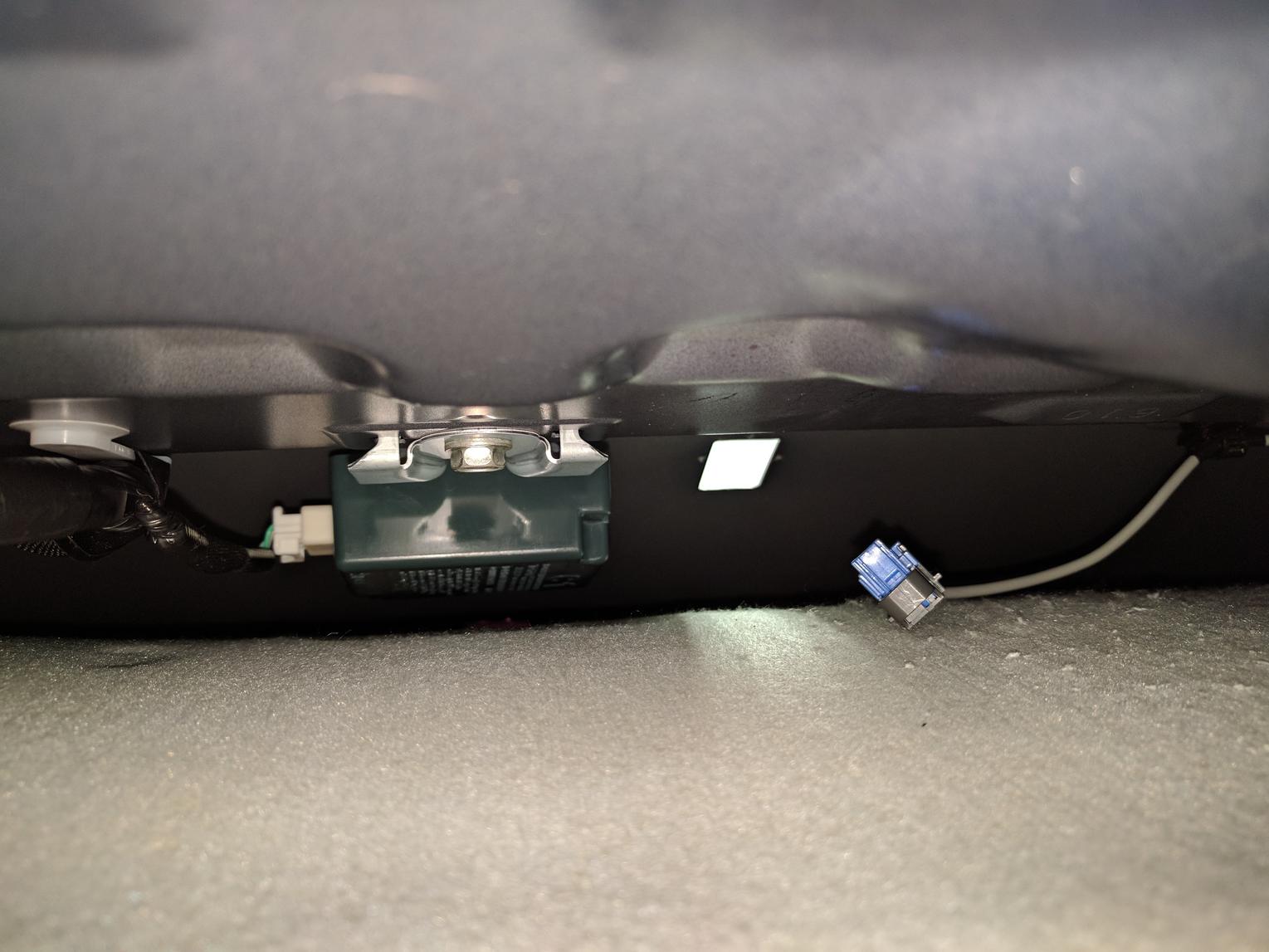

I'm adding a bunch of pictures for anyone like me who could have used some more help visualizing this process. I used needlenose pliers to remove the headliner clips. Then I popped open the passenger side rear pillar cover. I didn't need the driver side. This provided just enough room to slide my hands up into the cavity above the headliner to reach the antenna bolt and connector clip. Thankfully my wife was willing to help and her smaller hands were much more adept at this than mine.
I'm also including a couple pictures of the antenna disassembled. Once I saw how short the actual antenna is, I started thinking about just modifying this for use. The trick is to waterproof it ...
269789d1506897239-low-profile-xm-shark-fin-antenna-swap-xm_antenna_removed_internal.jpg
What is that green box?!
