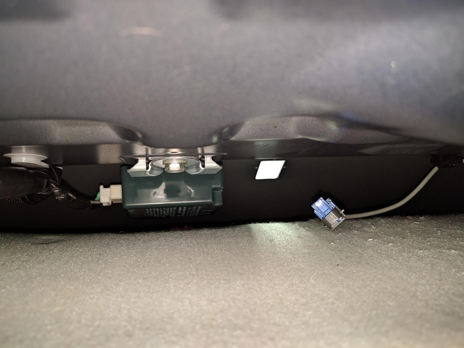

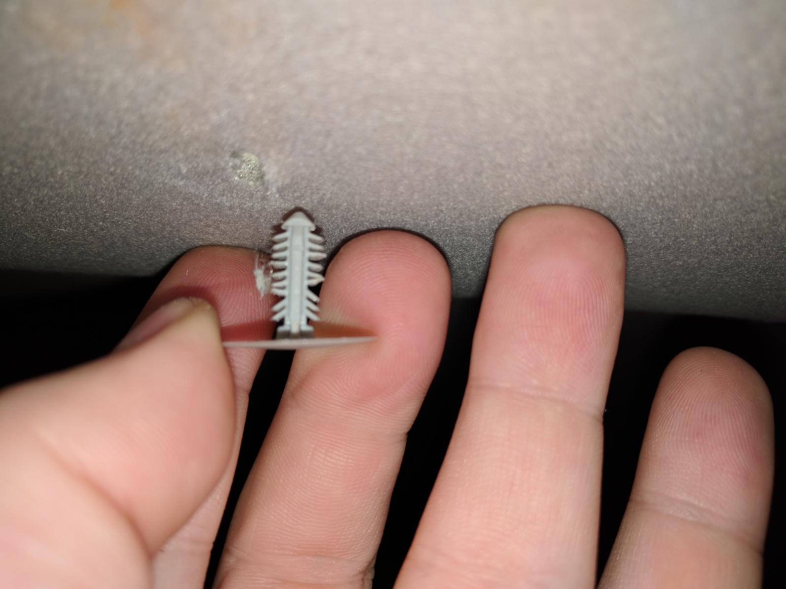

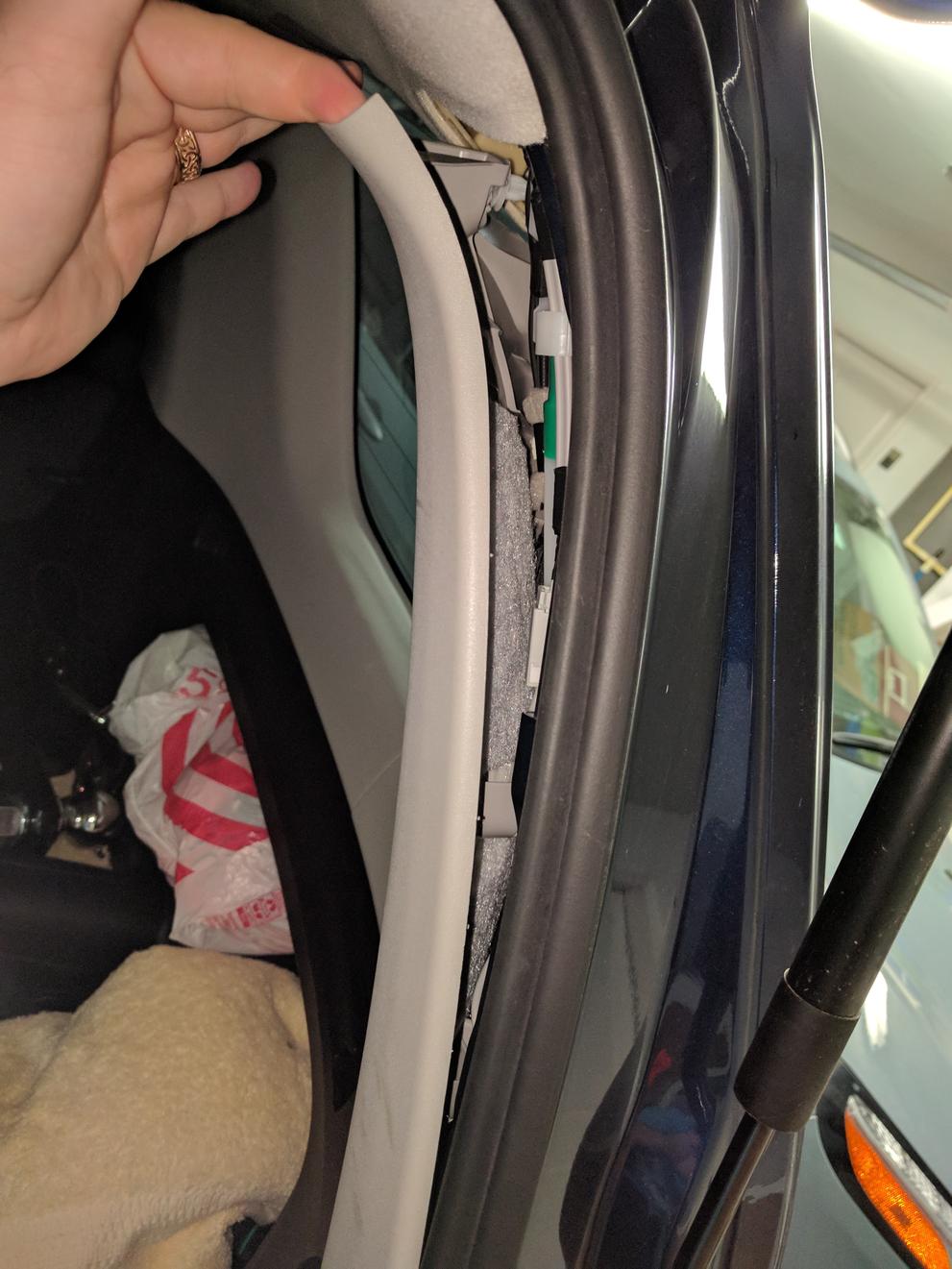

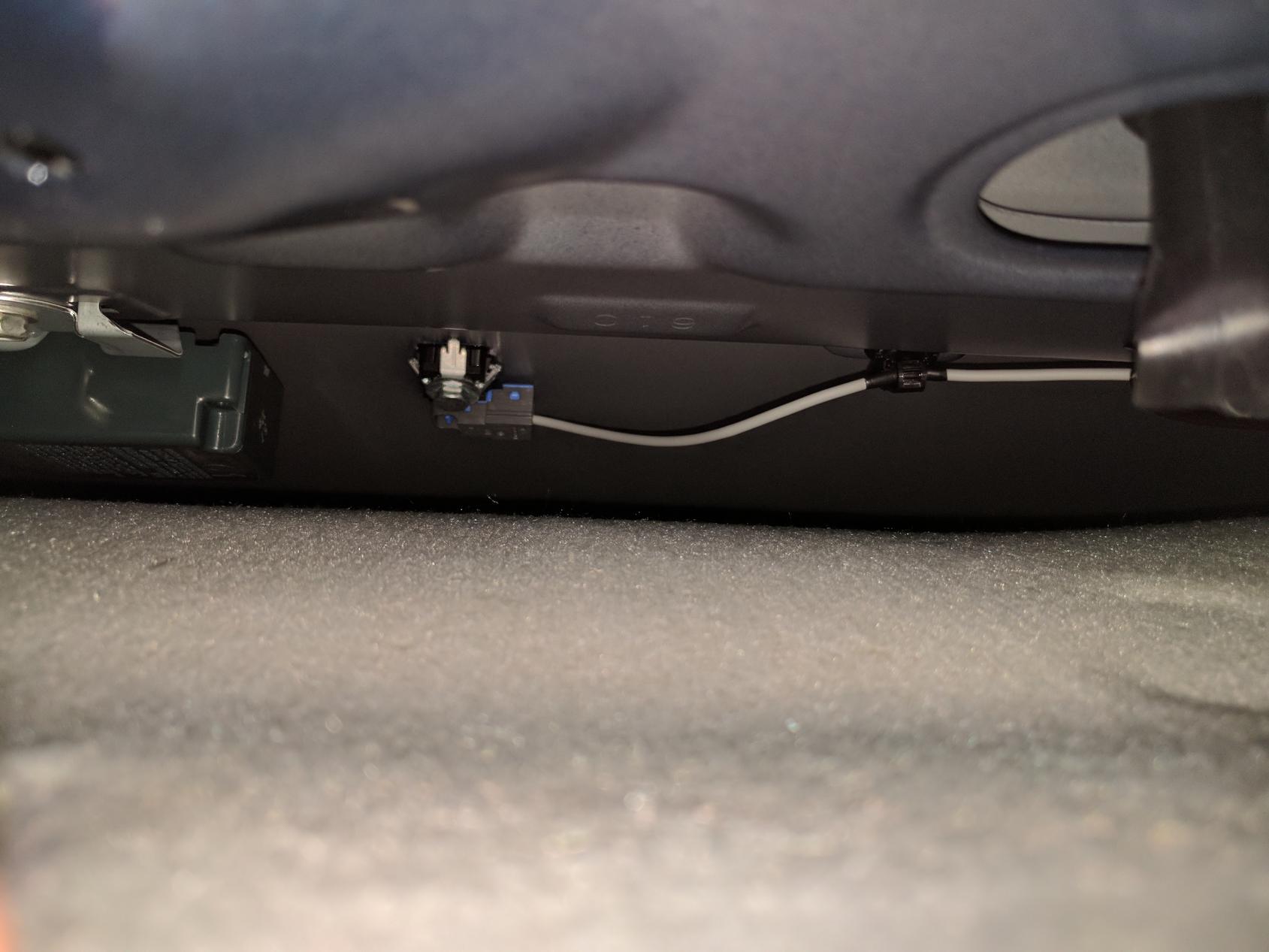

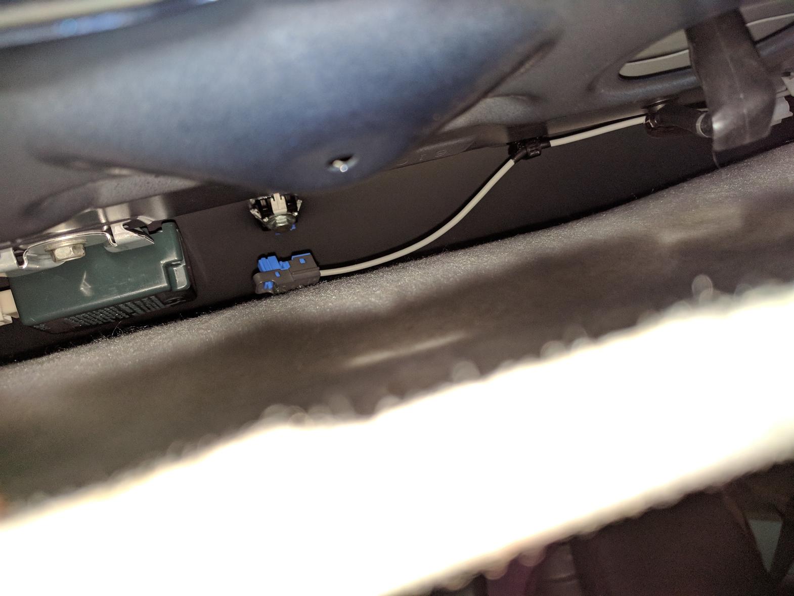

I'm adding a bunch of pictures for anyone like me who could have used some more help visualizing this process. I used needlenose pliers to remove the headliner clips. Then I popped open the passenger side rear pillar cover. I didn't need the driver side. This provided just enough room to slide my hands up into the cavity above the headliner to reach the antenna bolt and connector clip. Thankfully my wife was willing to help and her smaller hands were much more adept at this than mine.

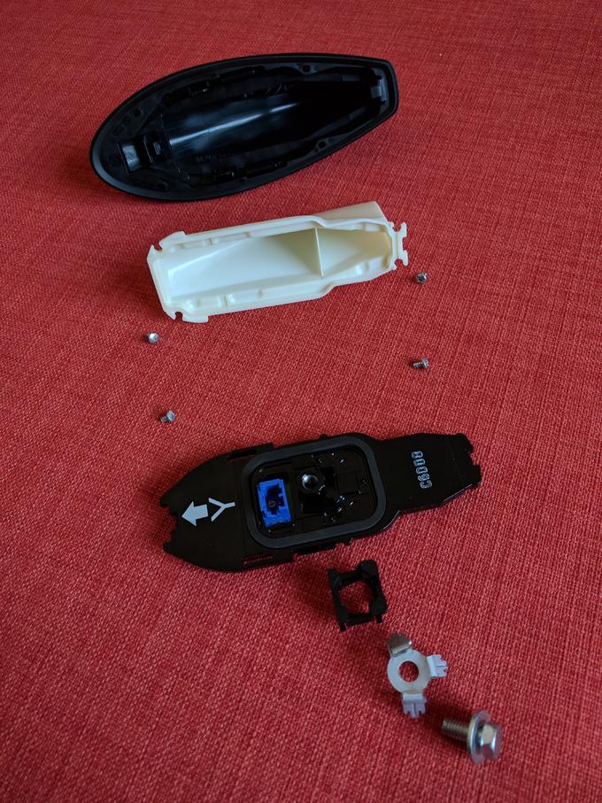

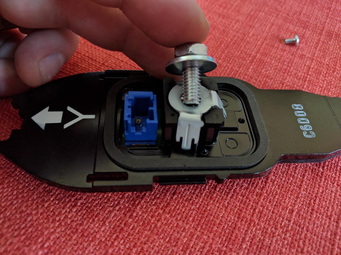

I'm also including a couple pictures of the antenna disassembled. Once I saw how short the actual antenna is, I started thinking about just modifying this for use. The trick is to waterproof it ...

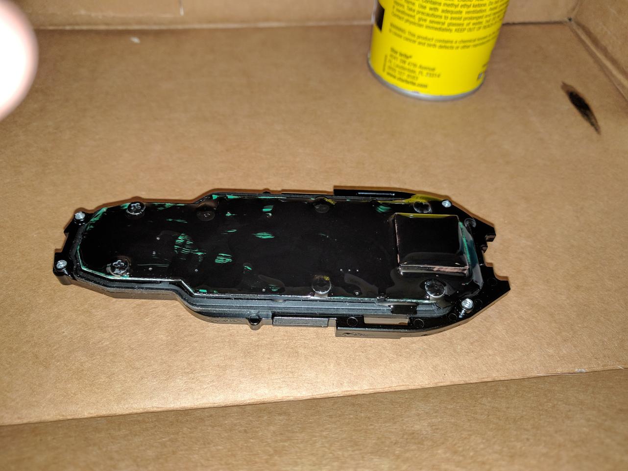

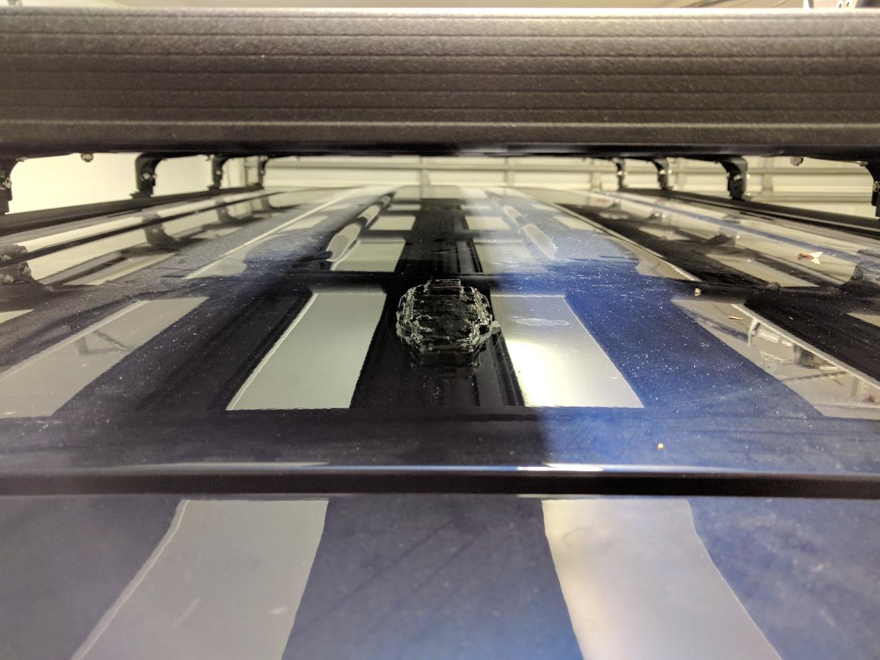

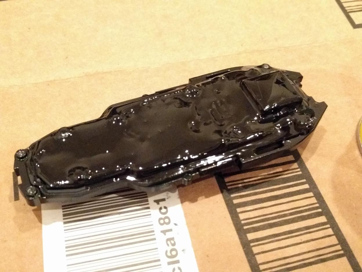

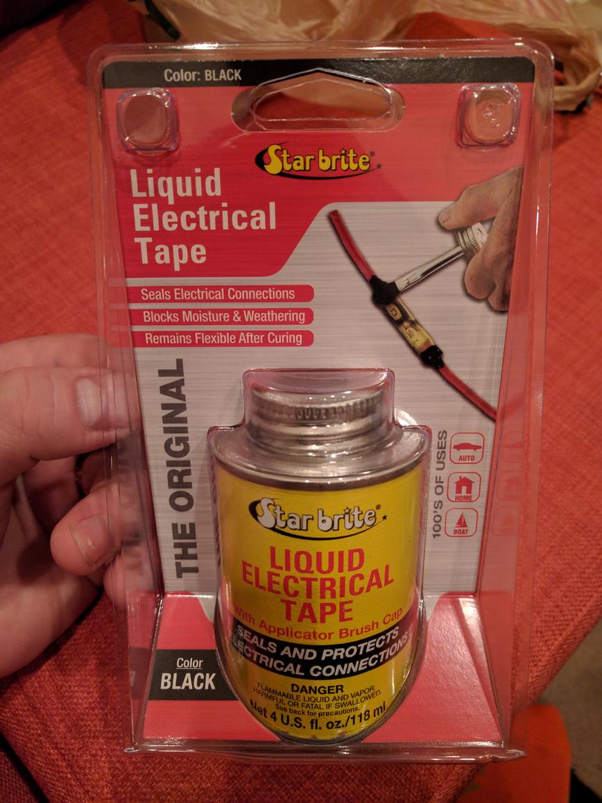

We found some liquid electrical tape at the hardware store and figured it might just work. The back of the container warned that it has ingredients, "known to the state of California to cause cancer and birth defects or other reproduction harm." It's a good thing I'm in Texas! So I started applying layers upon layers and eventually it started looking pretty good. The next morning I ran it under the faucet and I didn't see any water get into the opening underneath. So I used a little silicone and we bolted it back on. I've still got about 3" of clearance between it and the bottom of my new k9 rack, so I'm hoping this will work out.
Thanks for updating this. I hope the liquid tape works, in my experience it peels off fairly easily and I'm not sure what kind of thermic properties it has. I do know that for waterproofing electronics something called potting compound is typically used. In this case the electronics are probably the less of a worry, I'd be more concerned about UV and heat damage from the sun. Let us know how it goes.
The liquid tape is definitely delicate, but I don't anticipate it getting touched often. I wasn't considering UV fatigue. Thanks for the tip on the potting compound. I was thinking of buying some Sugru, but I got impatient and wanted to get it done this weekend. I'll definitely have to keep an eye on the liquid tape. I'm not so concerned about the XM working as I am the waterproofing of that hole. We left a small diaper in the headliner gap just under the antenna, so that should turn from yellow to green if it gets any moisture :D

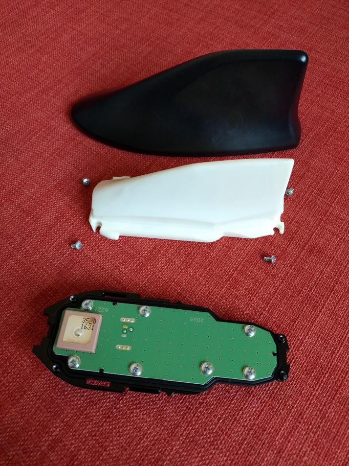

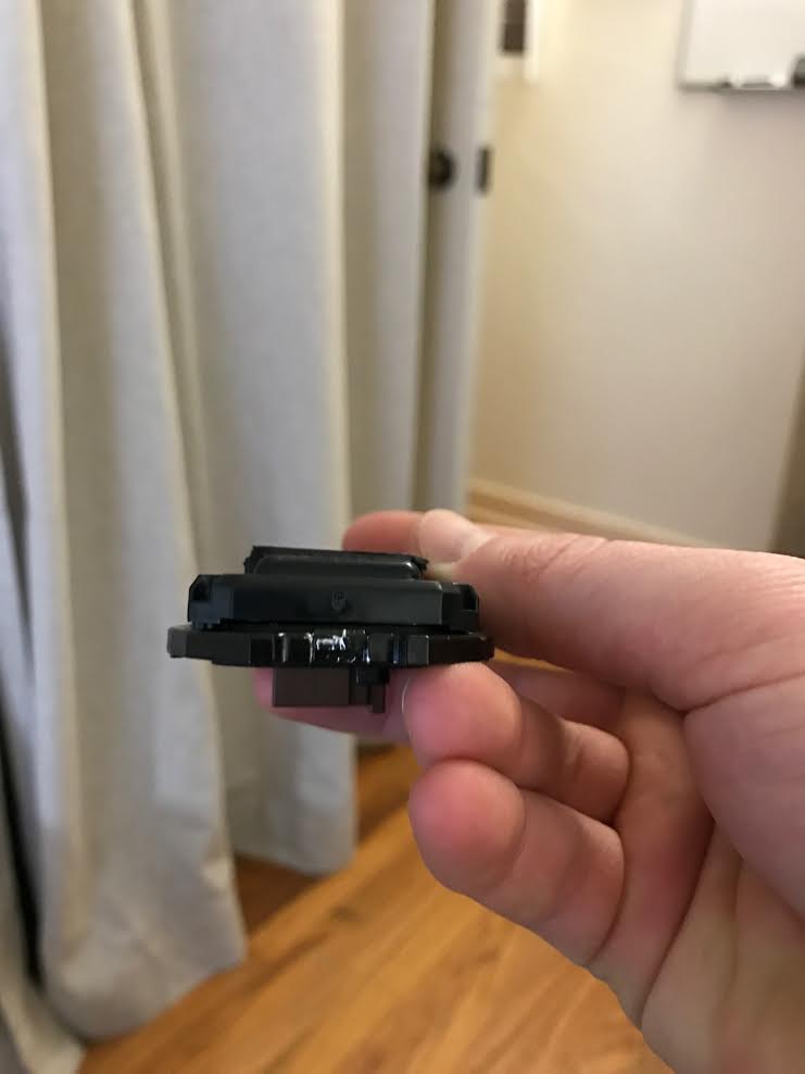

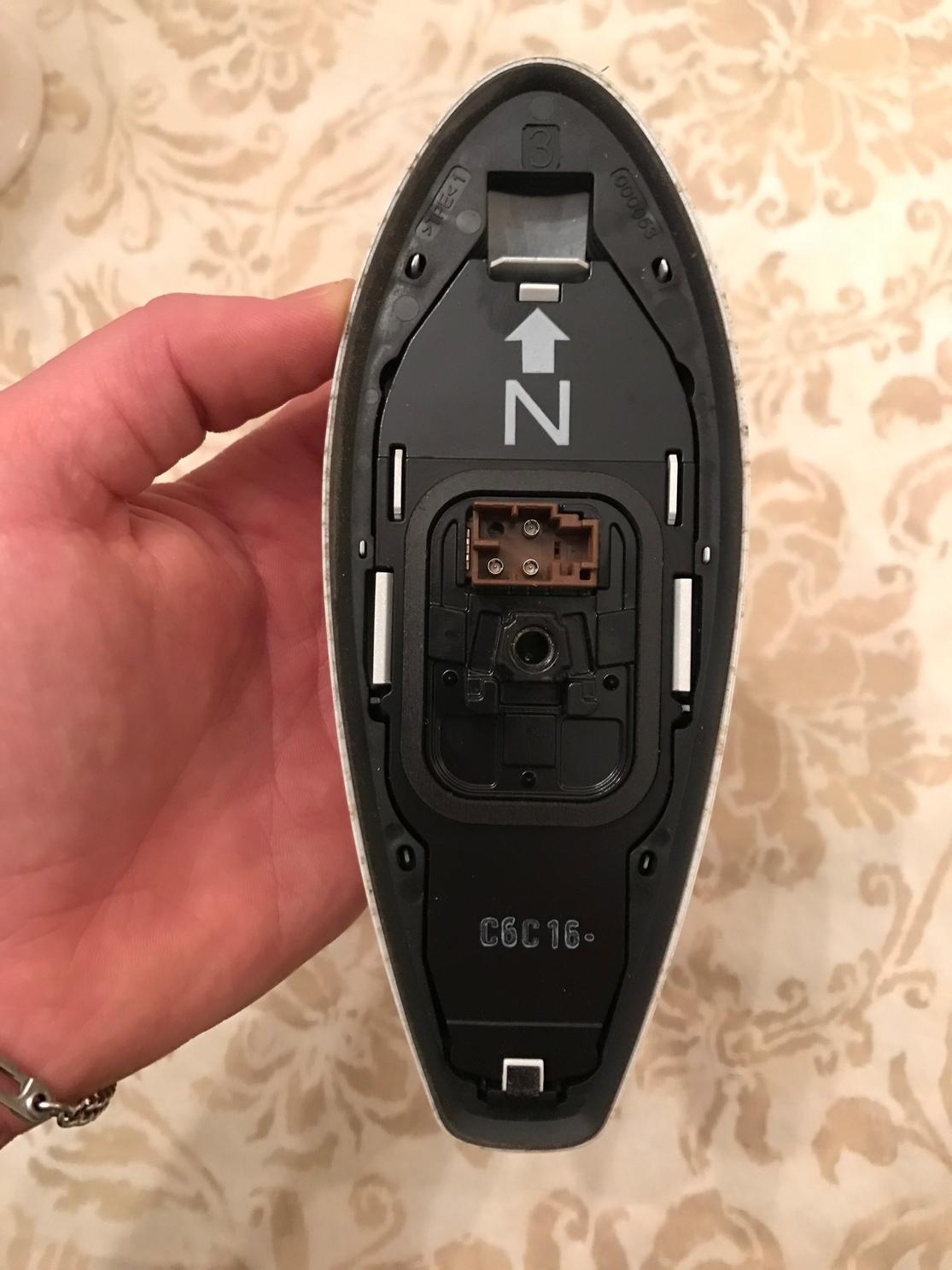

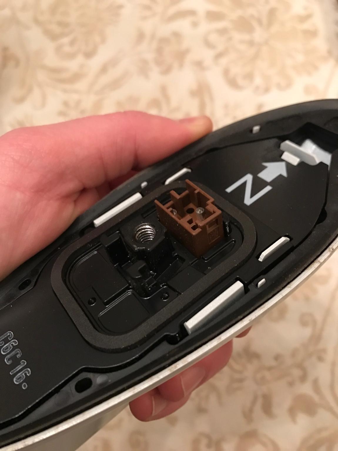

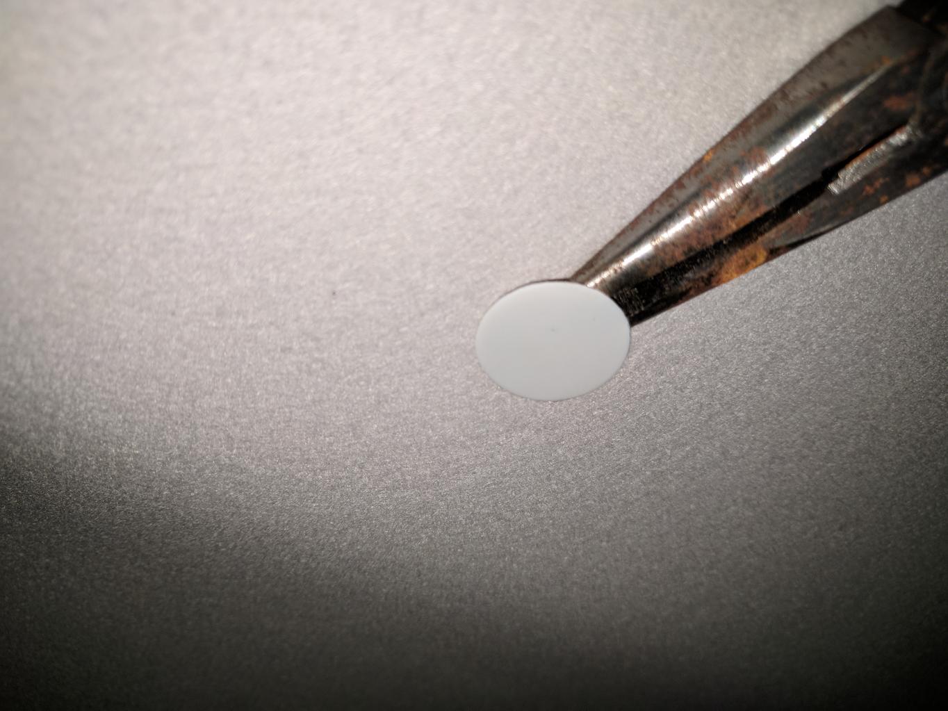

Anyways, this is off my 2016 Limited. It appears different, or maybe I'm missing something, but how do I get this black plate off to access the screw head so I can disassemble this thing? My intentions were to chop the fin flat for clearance.
It looks like there's 3x pressure clips, one on each side and a third up front, but it doesn't seem to be loosening. Thought I'd check here before I break any clips off. Thanks.
Cancel that, got it popped off with a pair of pliers.

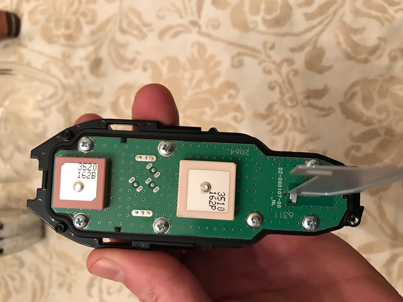

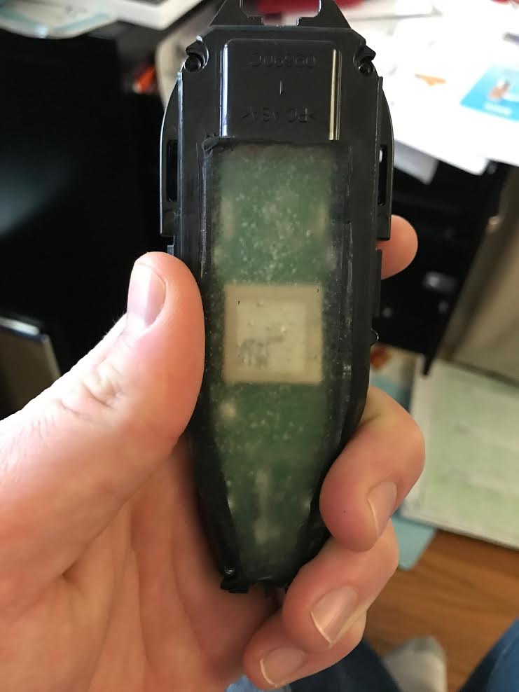

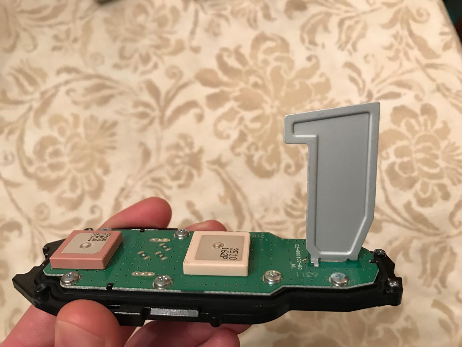

There are several versions of the sharkfin antenna's guts actually. Mine had two "chip" style receivers, as well as a flat metal blade-type antenna that fit up inside the sharkfin part of the plastic housing. I've now seen two others that had no metal blade, and one only had a single chip for XM only.
Here's the guts from mine, note the flat blade antenna:
So, after a bit of research, IIRC, the pink colored chip is the Sirius/XM receiver's antenna, the grey is for GPS, and the flat blade is for FM Diversity which allows the stereo to cut to a smaller, ultra-low gain antenna when local stations are being overloaded from being to close to them. Interesting note, in Honolulu where I had my car audio shop decades ago, I used to install two antennas on customer vehicles when I carried a specific model of Clarion stereo. It had two antenna ports, one for "DX" one for "LOCAL", and it would automatically switch to the shorter antenna when one was in town. Worked okay for its time, but new stereos work much better than the old units like this!
Okay, FM 101 class is done, I'll shut the hell up now!!!
So, if one were not terribly concerned with FM reception, would it be necessarily bad to simply cut and bend, or remove entirely, the diversity antenna? From my understanding of radio antenna's the wavelength likely won't match anymore, but my primary objective here is to clear a low profile rack, so I'm willing to sacrifice this diversity antenna. Old post I know, just thought I'd ask your thoughts.
Weird! That metal "1" antenna plate is what I would have expected to see under the shark fin when I disassembled mine. But mine didn't have that part. I wonder why some have it and some don't. I also just noticed that mine only has one square chip and yours has two. My GPS must be located somewhere else. I thought I read somewhere that it is located in the dash. You'd think all 2016's would be the same. Granted you have a Limited and I have a TEP, but aren't our stereo system "upgrades" the same? So odd ...
Also odd - per the first post in this thread, "For 2014+ 5th gens, the shark fin antenna no longer contains the GPS chip or the diversity antenna".
I don't think I can answer your question as to whether you can just cut that thing off. If you're daring, you could release those 7 screws to remove the circuit board and see how the antenna is attached on the other side. It might be possible to non-destructively remove it to test the impact of its removal. The main thing I'd be concerned about in your case is messing up the GPS antenna function. Of course ... you can always buy another shark fin if it all goes to hell.

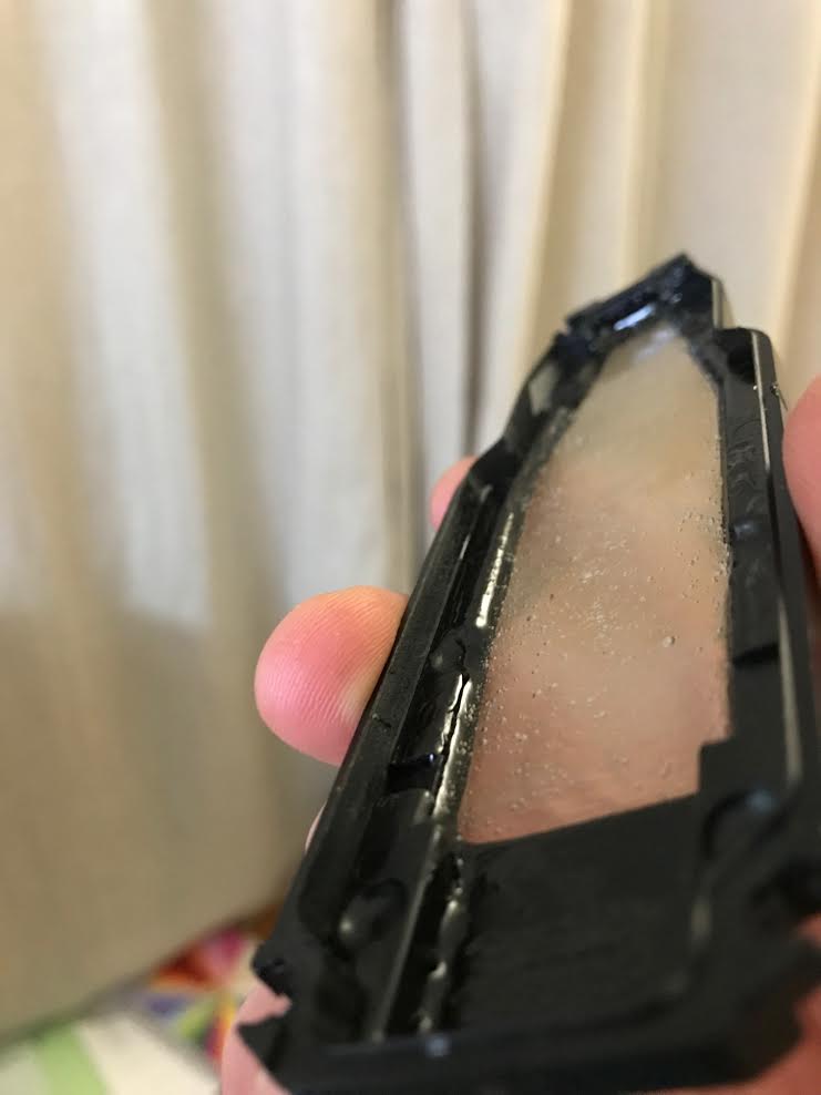

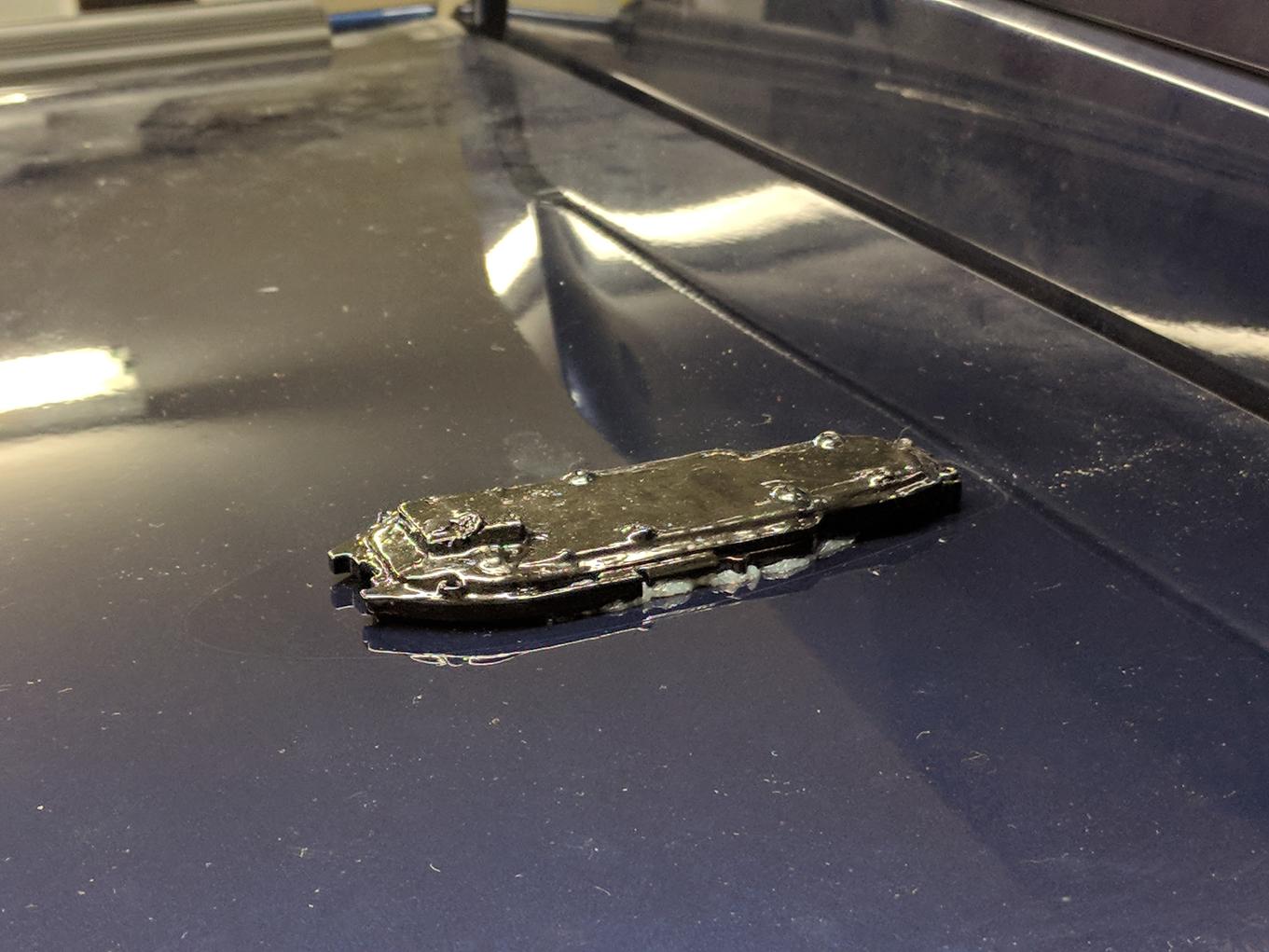

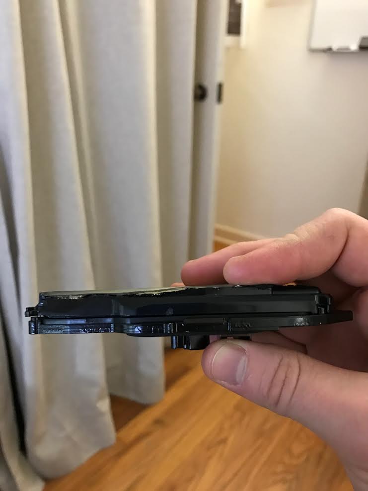

To follow up, I decided to scrap the outer fin altogether. I'm confident that with a bead a silicone sealing the two halves of the actual antenna together, as well as a bead on the mounting surface of the roof, that the electronics will be safe and overall leak-free.
I took a dremel to the inner fin, sanded the surface flat, and filled it in with plastic epoxy. The material sets in just a few minutes so you can test-fit for clearance with the electronics in the antenna as well. Overall I'm happy with how this turned out, it's very low profile and should allow me to fit a table underneath my rack with shorter feet. The whole objective here was to avoid having a roof rack that sits high on the roof, while maintaining the under-rack table slide. It would certainly look cleaner if I didn't clearance it as much and epoxied the outer shark fin cover, but in my particular case every mm of clearance helps. Hasn't been easy but it'll be nice when it's done.
