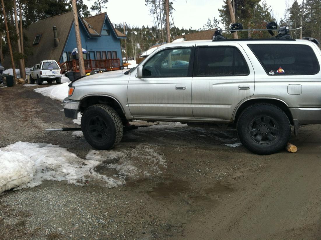

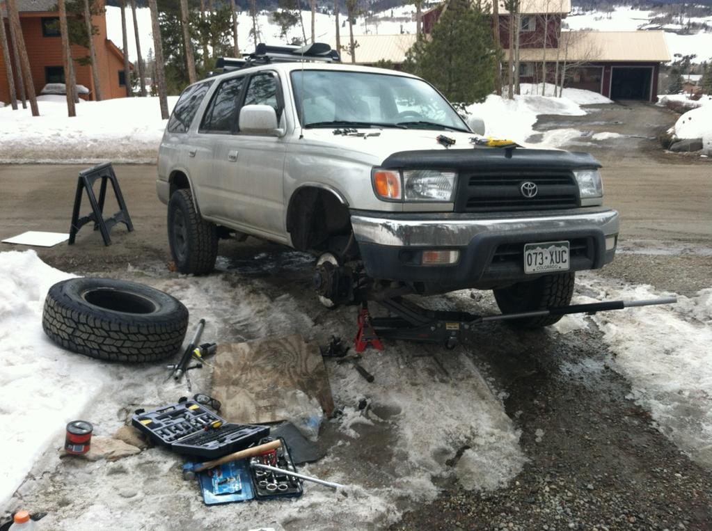

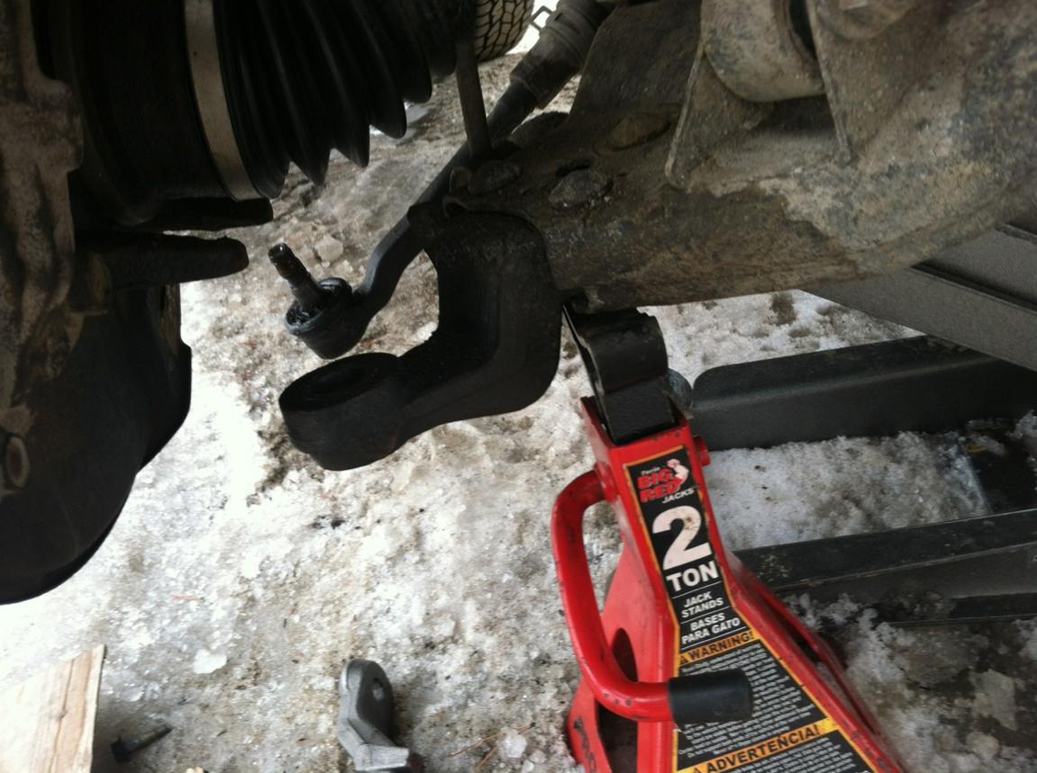

So yesterday as I was pulling into my driveway my lower ball joint came apart. Luckily I was going extremely slow due to the huge ice bump at the front of my driveway and didn't do any other damage. Unfortunately my front suspension is extremely flexed and I can't move the vehicle. I have the old ball joint pulled off but I can't get the ball joint to drop into the control arm due to the flex of the suspension. In the first and second picture you can see the uneven ground it is sitting on, in the 3rd picture you can see how far off it is from lining up. I have tried jacking it all different ways and have spent all day trying to get the stupid thing to line up to no avail. Does anyone have a good idea to fix this other than calling a mechanic?

Let air out of tires to level out truck?
unbolt the spring/shock, attach to LCA and drive on bumpstop to level ground?
Try getting the jack under the frame or front crossmember so you are not lifting on the control arm so that you can manipulate those parts to put it back together. Also make sure the cv axle is pushed in all the way as it has a tendency to stretch outward, especially if it has lots of miles and wear. Last try putting LBJ into LCA first and then pushing the knuckle onto it if you can't get it in with it attached to the knuckle first. I found that I had to lift the knuckle and UCA upward to get mine to go high enough to pivot back into the LCA.
Use a ratchet strap.
Go through the UCA, and around the LCA. Then tighten it down. Move the spindle as it lowers to line up the parts.

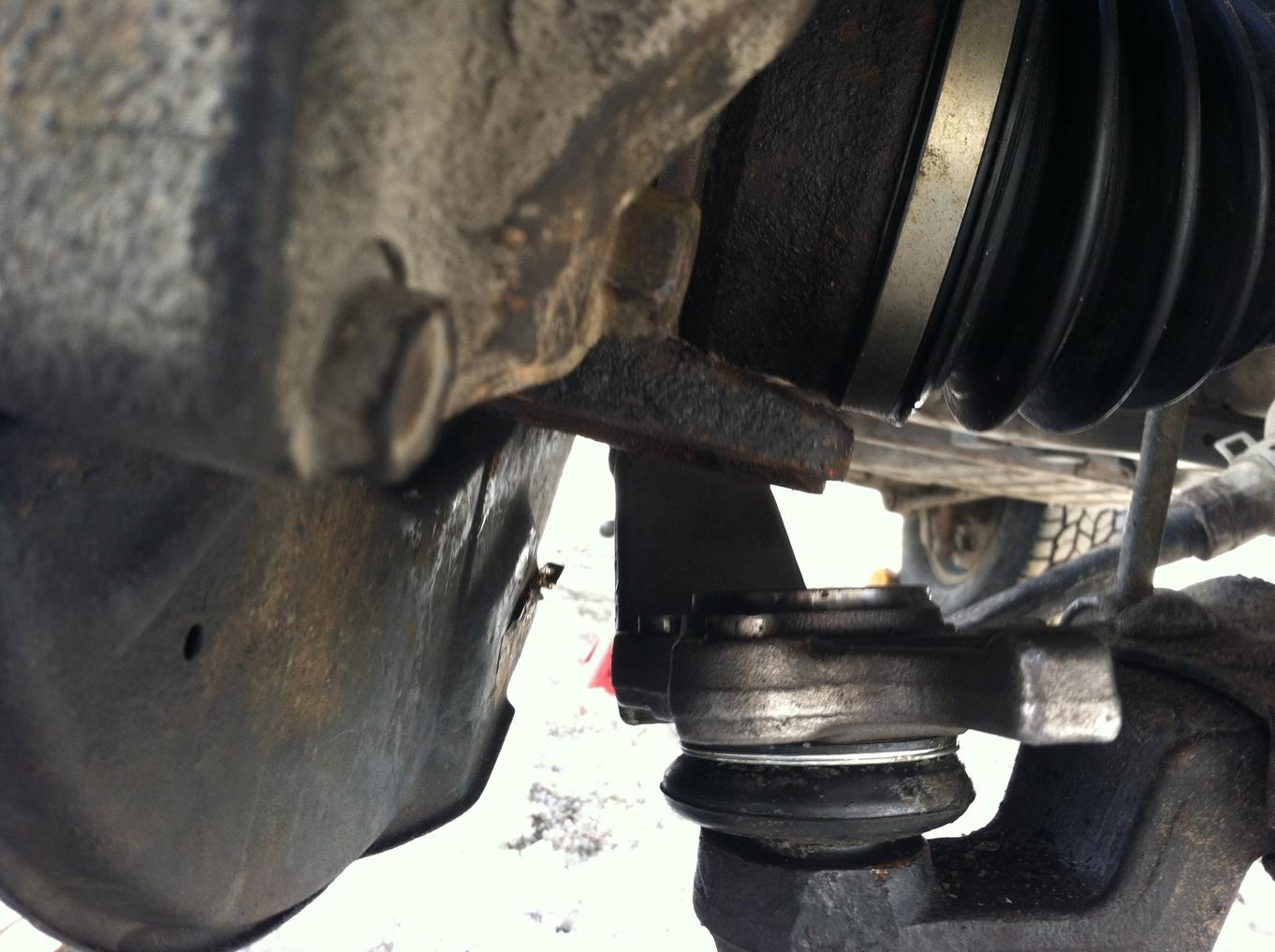

Now I have it jacked up on jackstand on the frame eliminating any suspension flex. Unfortunately, it's still about 2" off. The rotor piece is out too far. CV axle bent? Look at the angle of the rotor compared to the ball joint piece I need to bolt on.
no no no your doing it wrong.
take the ball joint off the lower a arm.
then attach it to the spindle with the 4 bolts.
then with your jack, place it under the a arm and jack it up then align the ball joint stud into hole and then screw on the castle nut.

You're fighting against two issues getting it on there. The cv axle has to be moved and compressed a little to get it into the right angle and the rubber bushings on the upper control arms resist lifting the knuckle/spindle into place. The lower control arm is somewhat limited in movement due to the strut, so you have to focus on lifting and pushing in with the knuckle/spindle.
You can always loosen the bolt on the upper control arm bushings too if you need more movement.
