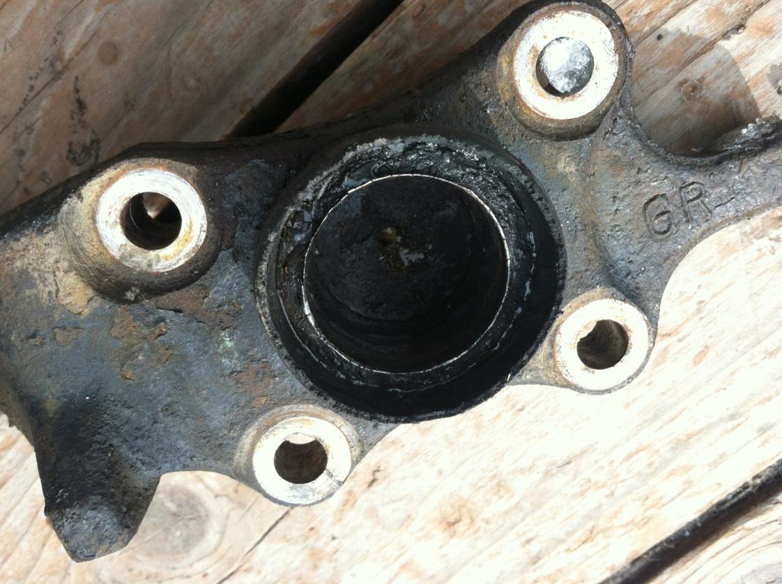

Do you have any pics of how the ball joint failed? Just curious.
Basically the ball pulled out of the socket leaving the ball attached to the lower control arm and the socket attached to the knuckle/rotor/hub.
