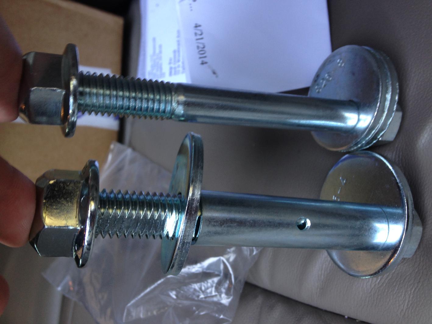

I found the cam kit which would work but it's def a different design from OEM and I couldn't find the greasable version.
P/N: MOOG-K100128
k100128 (2)
k200772 (2)
k200773 (2)

Replaced the lower ball joints and couldnt get any of the cam bolts out and the sleeves were rusted in there too. I didn't order the kit so I had to put it back together without replacing the bushings. I understand that the bolts and sleeves are part of the (k100128) kit but are the front and back of the LCA the same? Could I use those bolts and sleeves for both? Just want to get this right so I don't have to deal with it again as it's most likely my issue.
the front bolts are the only ones with sleeves....
the rears are just the bolt
they are diff size dia. bolts......
one moog kit does on side so you need to cam bolt kits and new moog bushings
Okay so the moog kit includes the front bolts and sleeves and the rear bolts? Just making sure.
Yes one kit per lca
Just make sure u get the proper bolts from them before you tear it apart
There was issues in the past where they sent out wrong kits
But that seems to be fixed now
