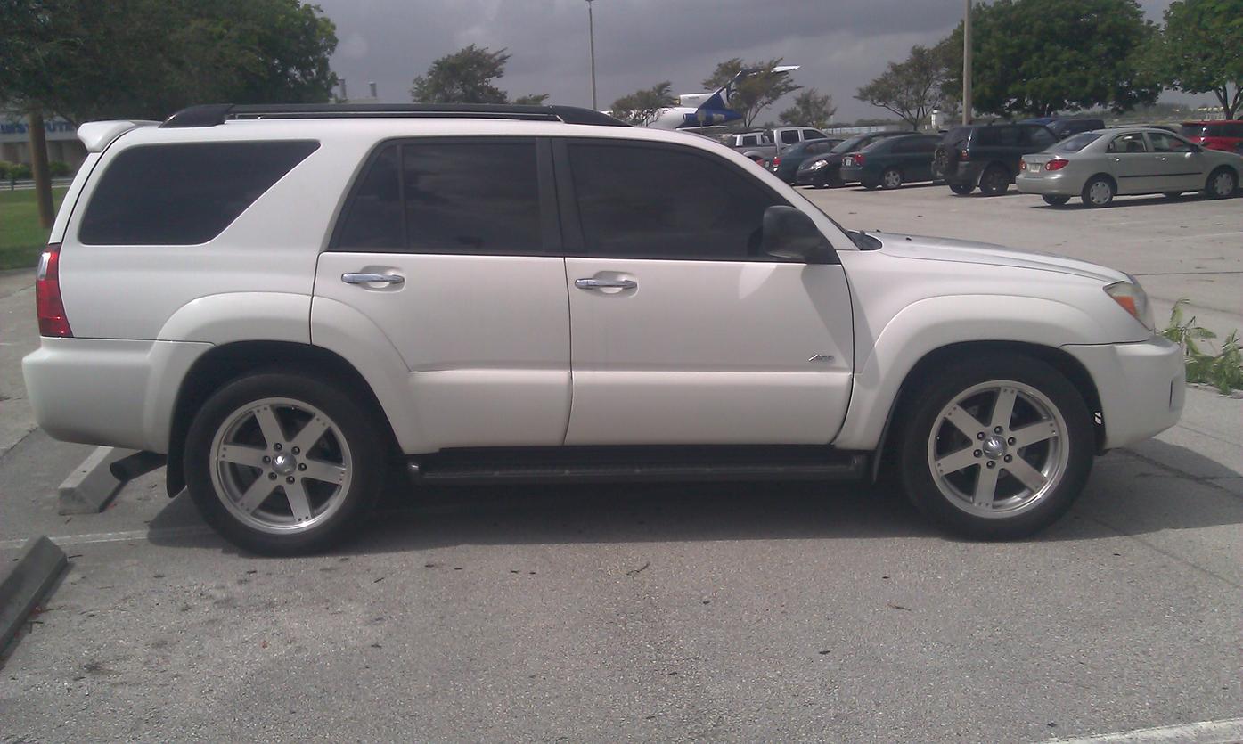

Let's see some pics with the bags and the front a half inch lower! Bags inflated and deflated, if you will :) Thanks! I'm excited to see what this looks like.

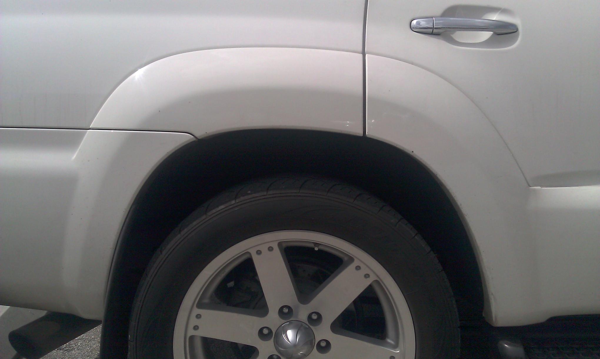

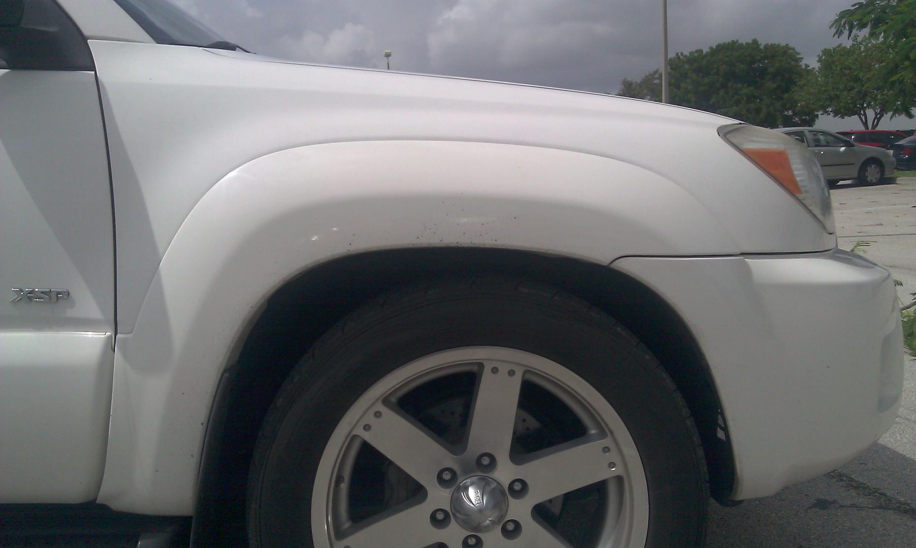

Here is a pic of the bags deflated...Hope u can tell. i dont have a compressor or air tank so i had to go by the gas station.

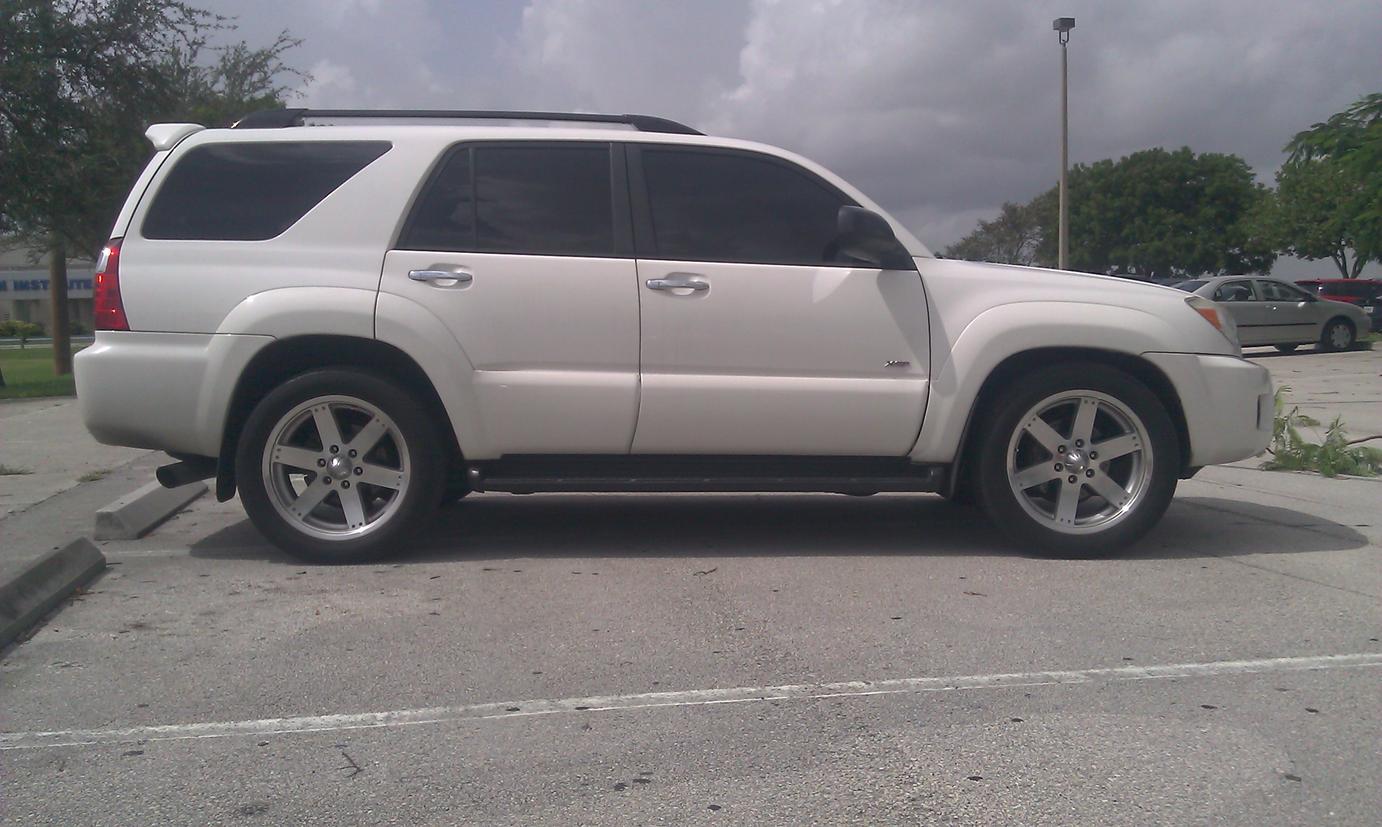

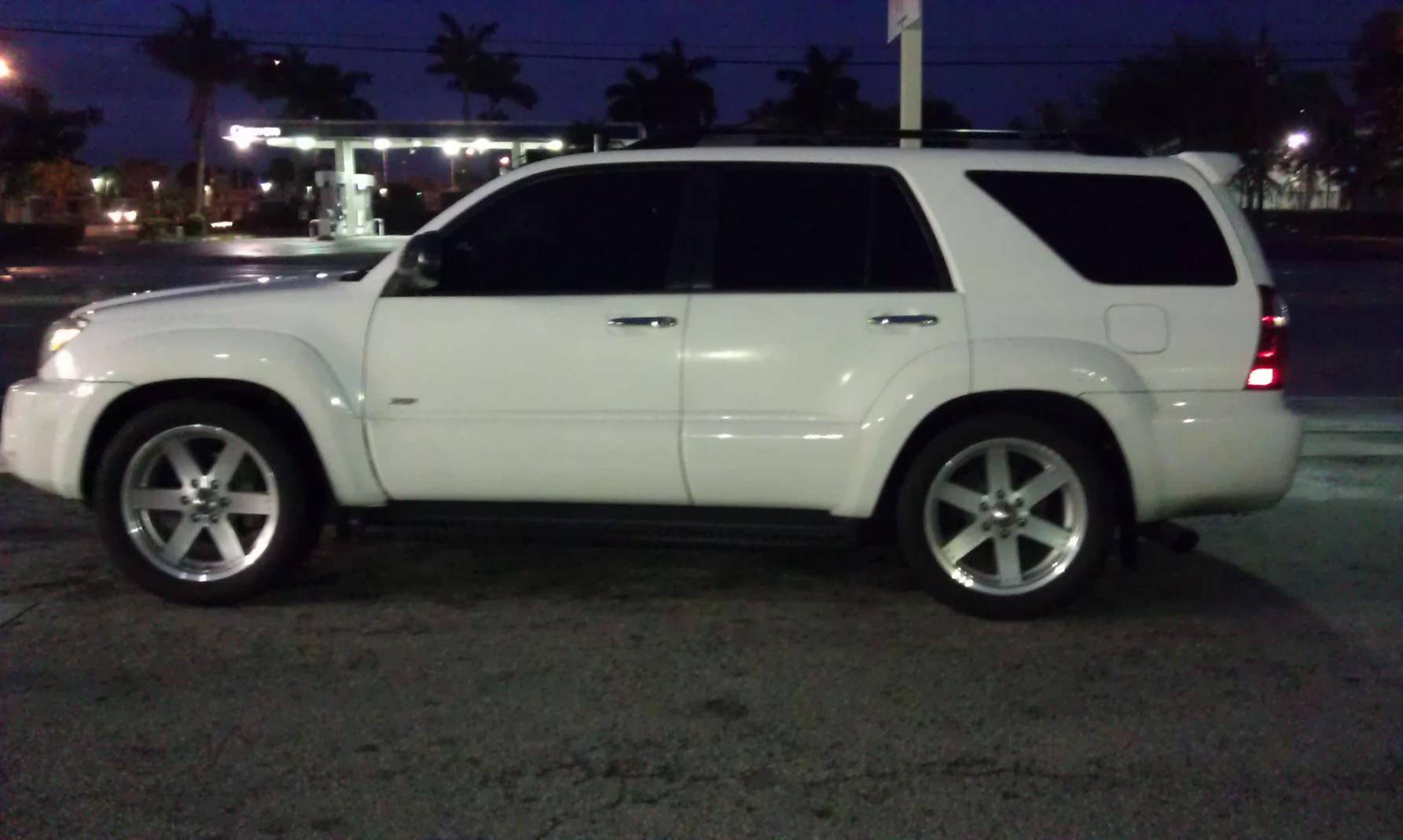

Sorry damn idk why they come out so large...lol..oh well closer detail. Also heres the stance. I run about 45Psi in the bags.

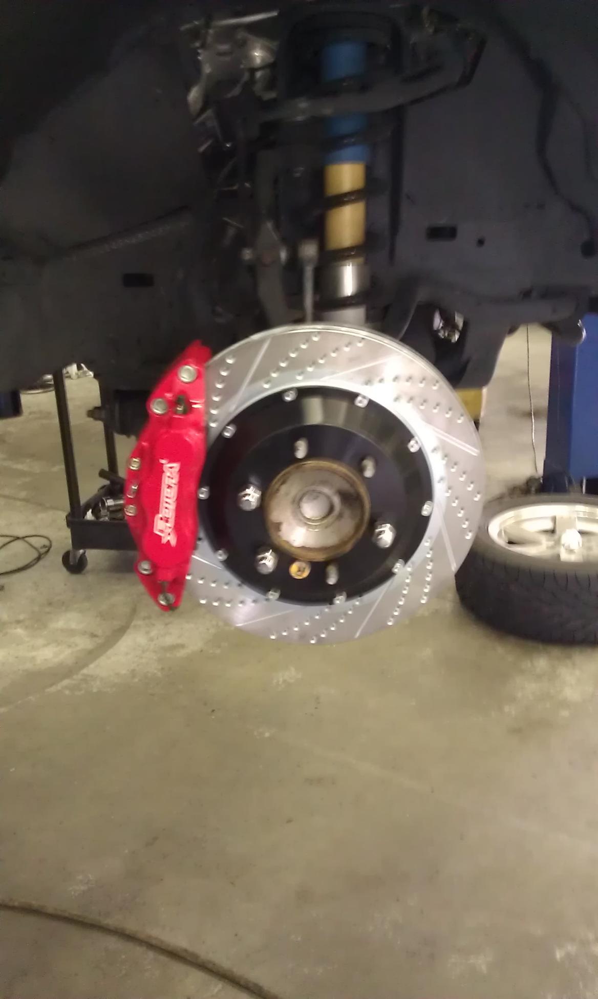

Next is to finish my relocation kit of the 02 sensors on my headers and i have a 355mm BBK from rotora in the works....Yay!!!!!! Cant wait. and heres a pic for fun..

Thank you...tell u what though there really isnt much room between the back of that truck and the top of the rear end...so its not so much of a slam but a nice drop ...nice thing is its adjustable.
I don't know if it was indicated, I didn't see it....if your 4Rrunner is a V6 or V8? I hope a V8, and being lowered you get to have a lower center of gravity and better handling and most of all you get to enjoy the torsen center diff in AWD mode .
