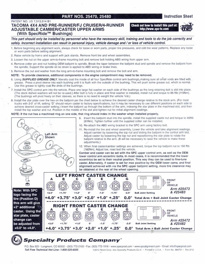

I'm at the auto shop now and looking up what settings everyone did for their UCA.
I'm searching now but if anyone knows or have some quick links to go to, I'd appreciate it. Always hard to find when you need it the most....
I'm looking for what settings people did for the front/rear caster
Thanks
^^^^ what he said. And if you need more info...
Kind of confusing, I had my LR's initial set to the "D" or +2 setting(per extensive research on the FJ forum and the other 4runner forum of those that did it before me) and then set the caster to 4.0+ on the alignment machine for the final caster settings.
Sorry Harper, I was typing my question as you posted. You kind of answered my question. If you had to set it up now, would you go with setting "A" or setting "D" then align it to +4 with the machine as you did?
oh,no problem ! I just hope I didn't screw up his install with my first post. I thought he had LR's already and looking for the best final caster setting.I would still go with "D" as it's been over 2 years and love my alignment/handling and didn't rub with 33's so it would be hard to improve IMO.
