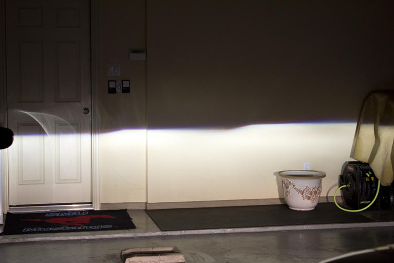

I did a quick alignment and am pleased with the results. I have to be off to a get-together here in a bit and ran out of time for fine-tuning; I plan on doing the final adjustments to the cut-off/beam pattern tomorrow evening.

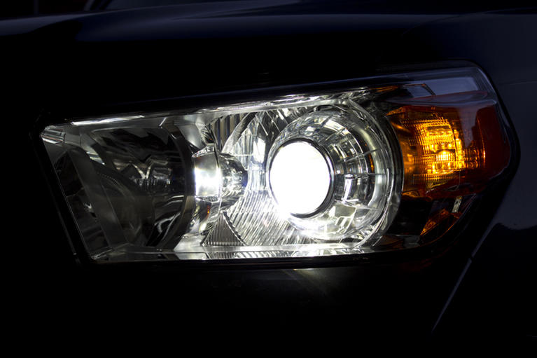

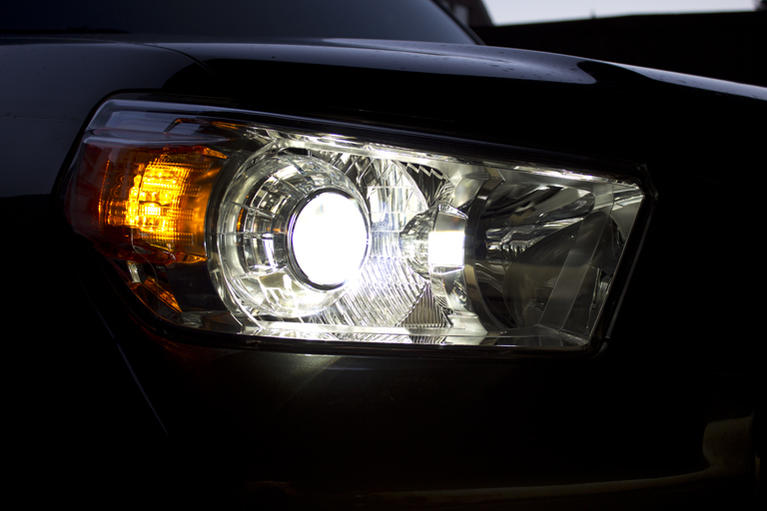

And before this thread gets too long, and before any of you post :worthless , here you go (pics taken with a Canon Eos Rebel T3i using an EFS 18-55mm lens):

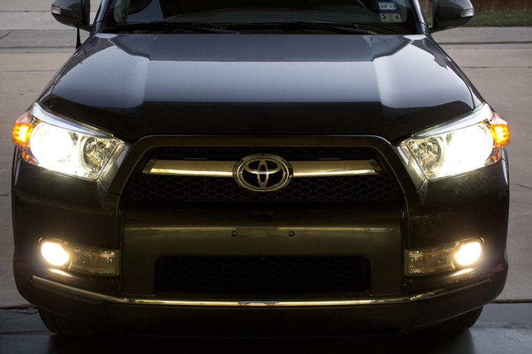

Looks very good. What color bulbs did you get? 4300k? They look to be the same color as the stock fogs. Did you change out the fogs to?
Thanks. The Osram Xenarc 66240 SVS bulbs are 4200k and actually look very pure white in person. The fog light bulbs in person are noticeably yellow-er. They are stock. I didn't change them.

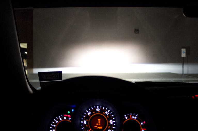

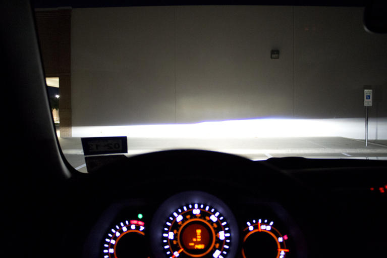

Looks good! Any other night shots of the output?
I'll take some more pics tonight.
