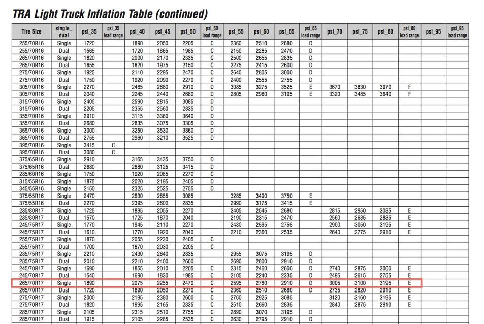

the 80 psi indicated is MAX pressure. you need to map the TRA load table to the equivalent load capacity when moving from a P to an E, which has been done and discussed thousands of times here and—in short—basically amounts to running your E-load tires at 44psi. so, no, not a safety issue at all. in fact it's exactly the right thing to do.
please read this for a more thorough explanation: http://www.toyota-4runner.org/engin...s/110299-lt-tires-need-more-air-pressure.html
and the load table for reference:
