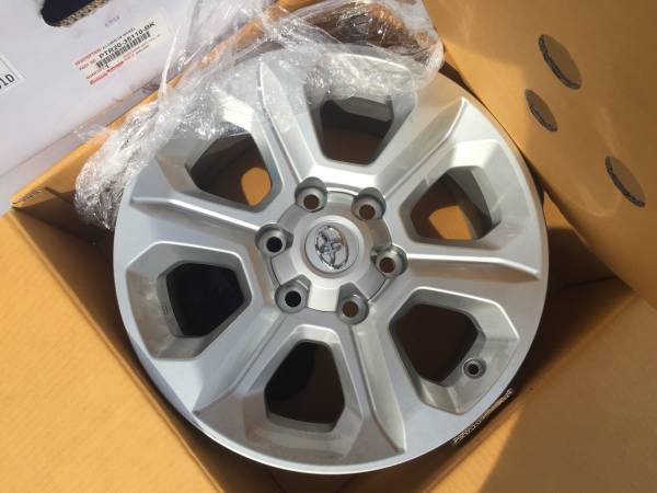

I just bought a set of 2019 or 2020 SR5 4Runner wheels to replace my 08’ wheels. I remember seeing something about changes with lug nuts. These are the only lug nuts that cross reference 08’ to 19’. Are these correct?

Also, has anyone seen decent pics of these wheels painted black? Debating on whether to waste the time or not

I have a set of those 2019/2020 rims for my ’04, and I was able to use the stock lug nuts. The only time I’ve had to buy new lug nuts was when I bought aftermarket rims that required conical/tapered lug nuts. The ’04 OEM flat lug nuts that I own have worked with both sets of 5th gen rims that I own. I have my original lug nuts on my 4Runner in the pic below.
I haven’t seen any pics of your SR5 rims painted black.
