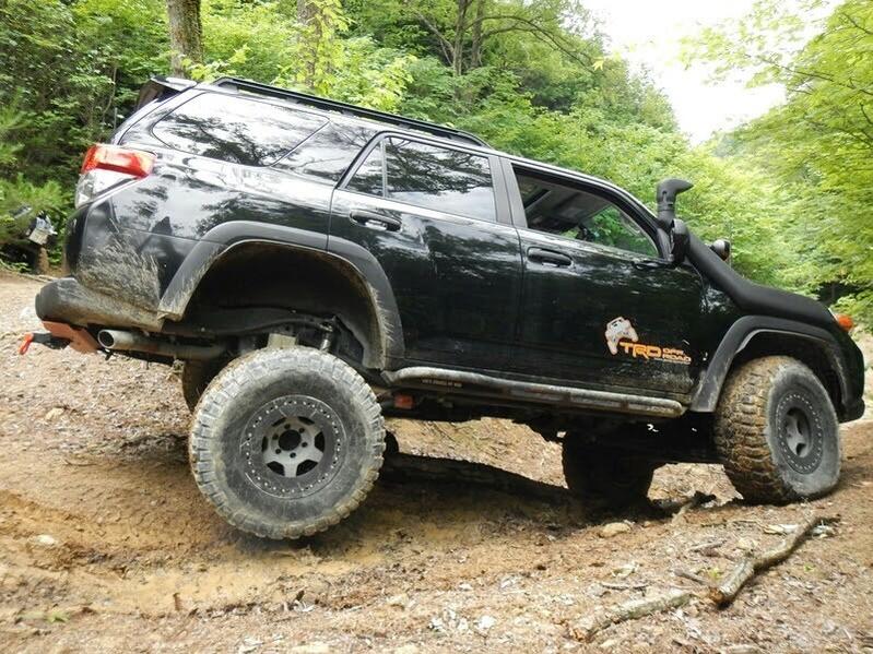

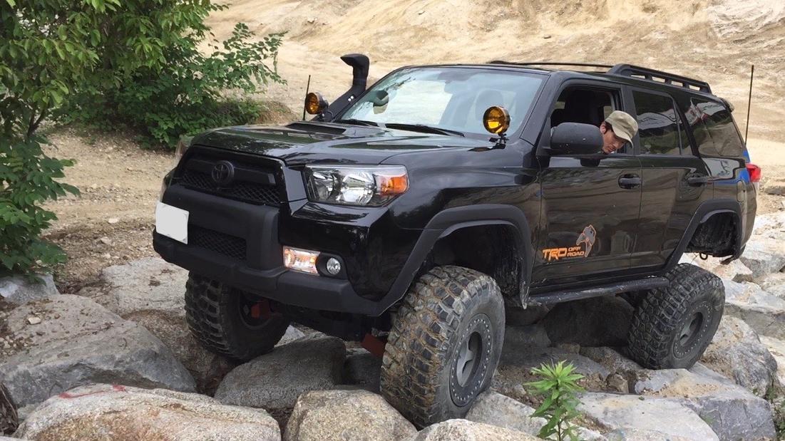

This is an impressive truck. The CV angles look very good. This is a good case for a drop bracket lift, done to accommodate large tires.

Yes. CV angle is good! ...So it is possible to further lift up.

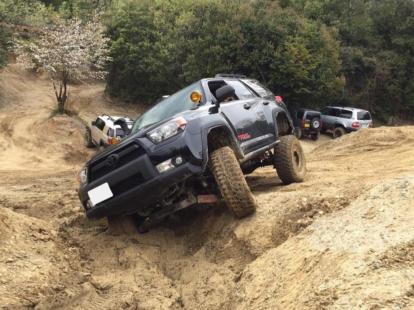

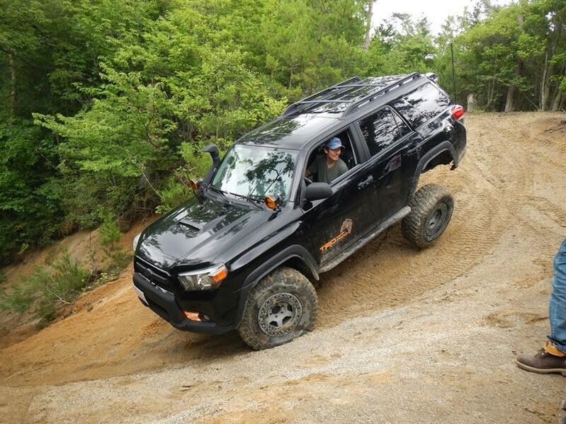

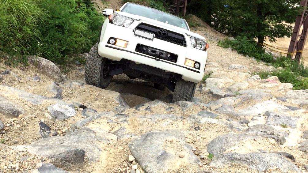

Sanage
We went to Sanage in last weekend.
Sanage is the most famous and most popular off spot in Japan.

Hi TheWraith, I'm sorry late reply.
I don't connect the rear swaybar. So frequently to roll. But I was accustomed to roll soon

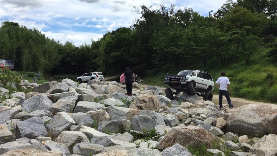

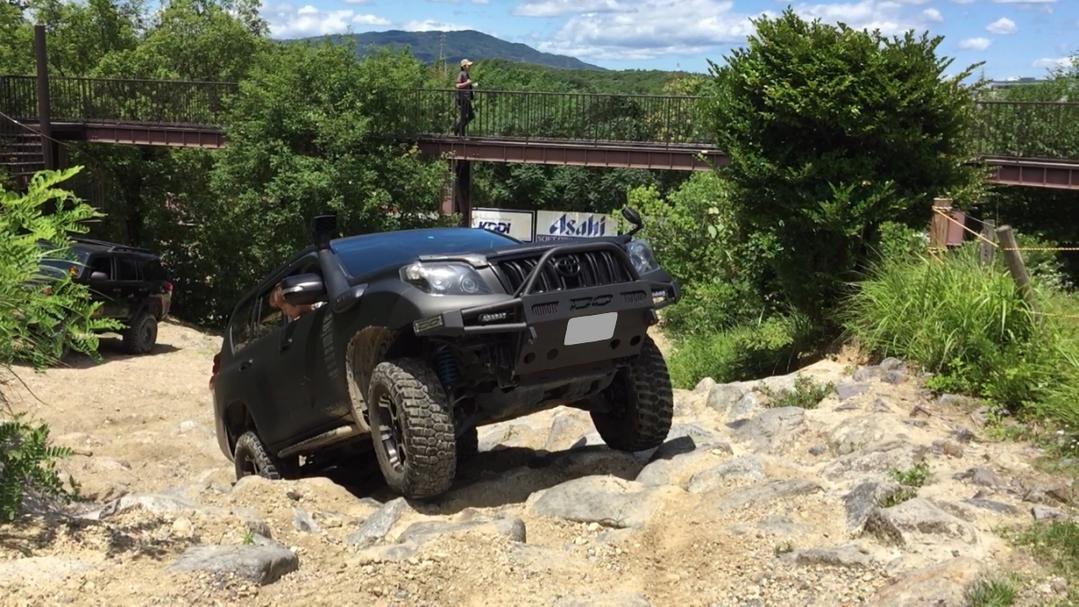

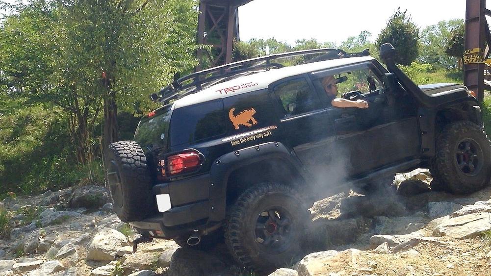

We went to Sanage again. 4runner,LC80,FJ,LC150PRADO

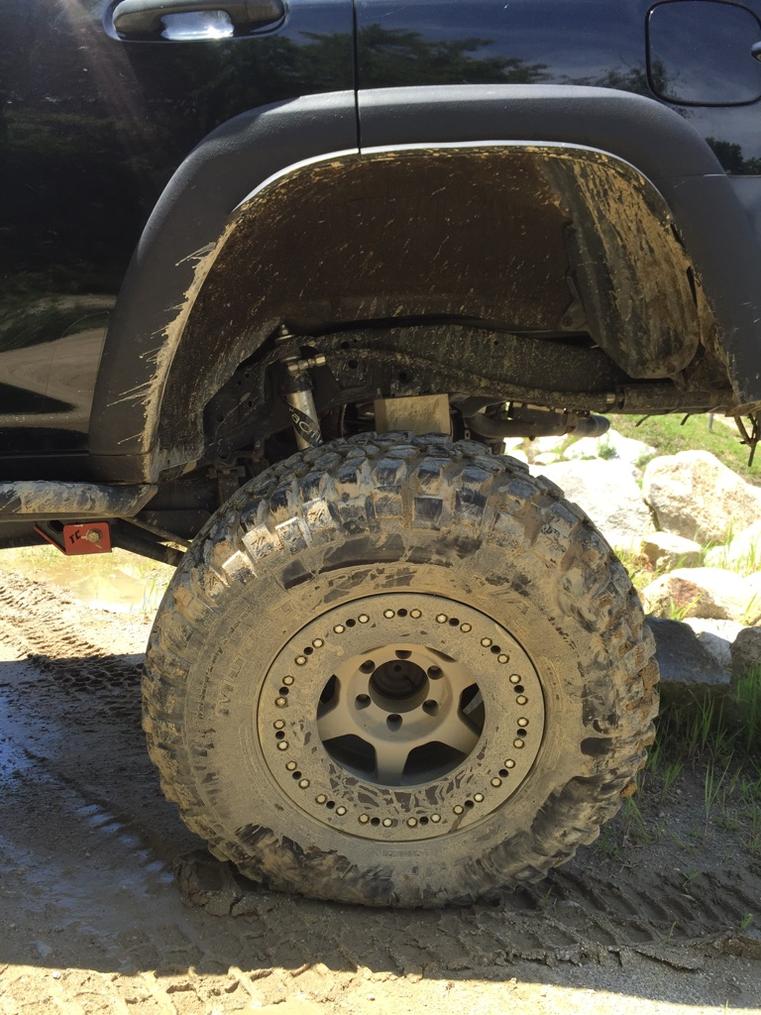

Front: 5.5"drop bracket and 1"radflo coilover and 0.5"spacer. Probably, 7" up in total.
Rear: 3" spring and 2" spacer. I haven't use the procomp's rear spring.

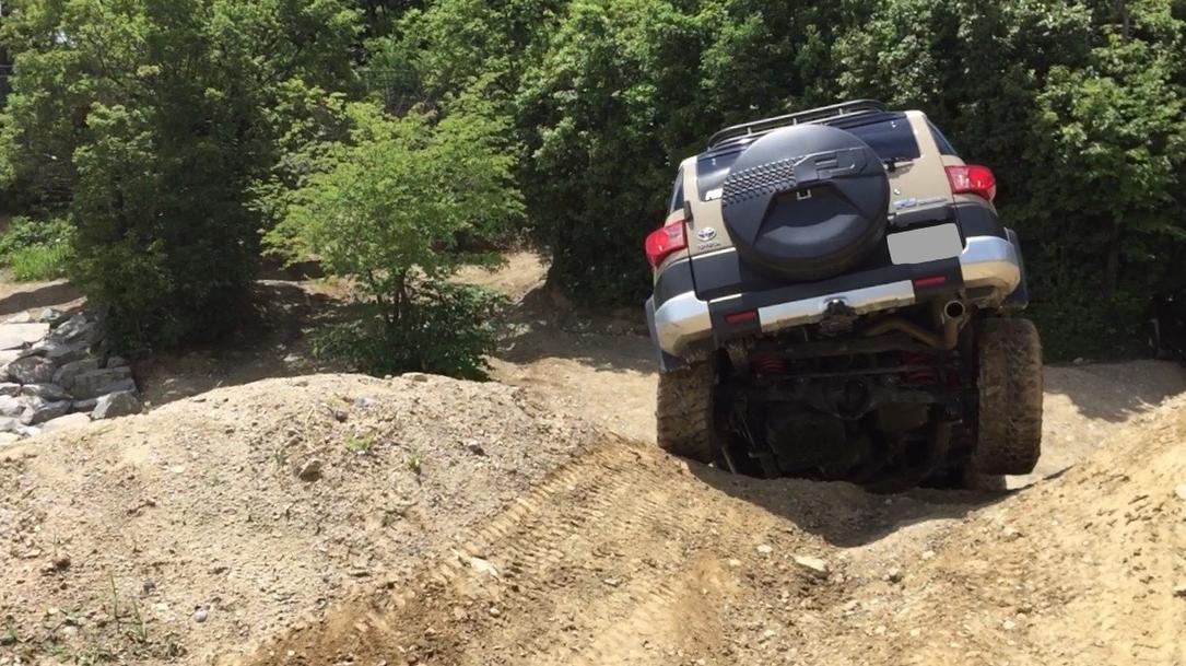

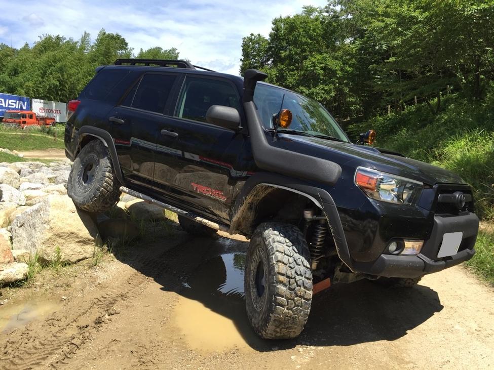

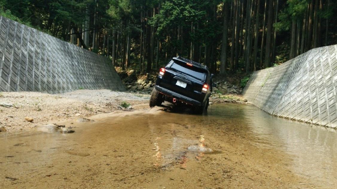

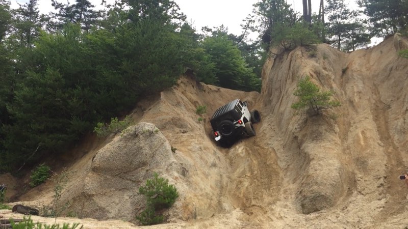

We went to the ”CYUBU” offroad place. It was very fun place. 4runner, JK, LC80, LC70, Safari, jimniy

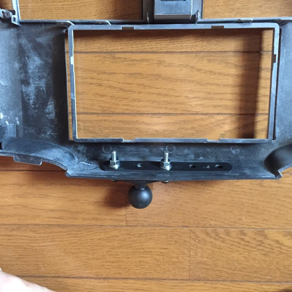

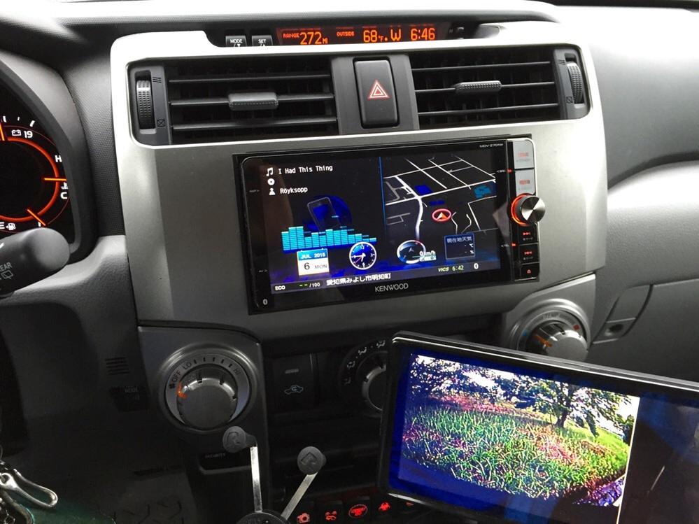

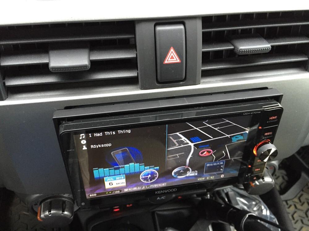

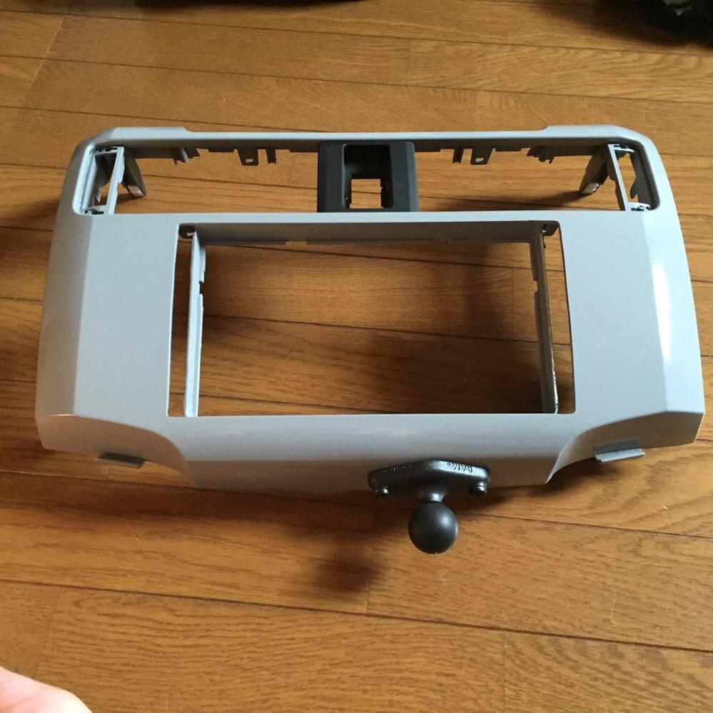

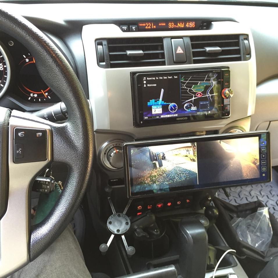

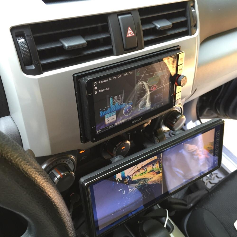

7" wide navi

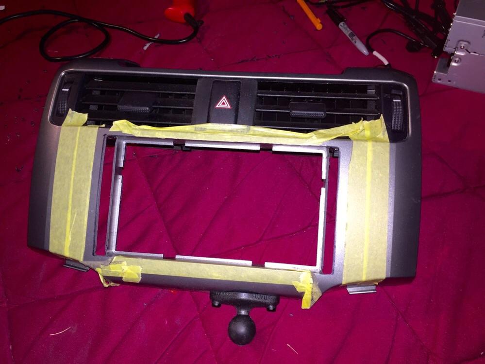

I have installed the KENWOOD's 7" wide navi. I scraped the panel, and was fixed with epoxy putty. This KENWOOD's navi move smoothly as smartphones.
