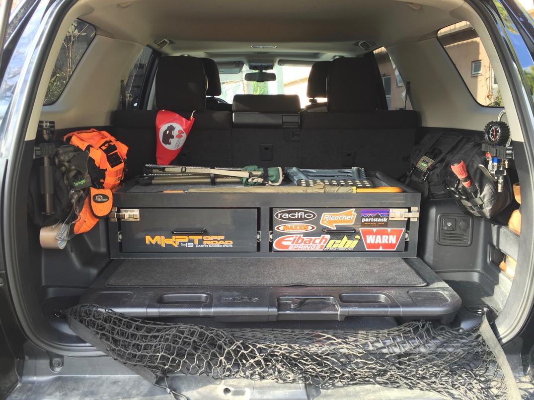

layout changed
I changed layout of cargo room. :high5:

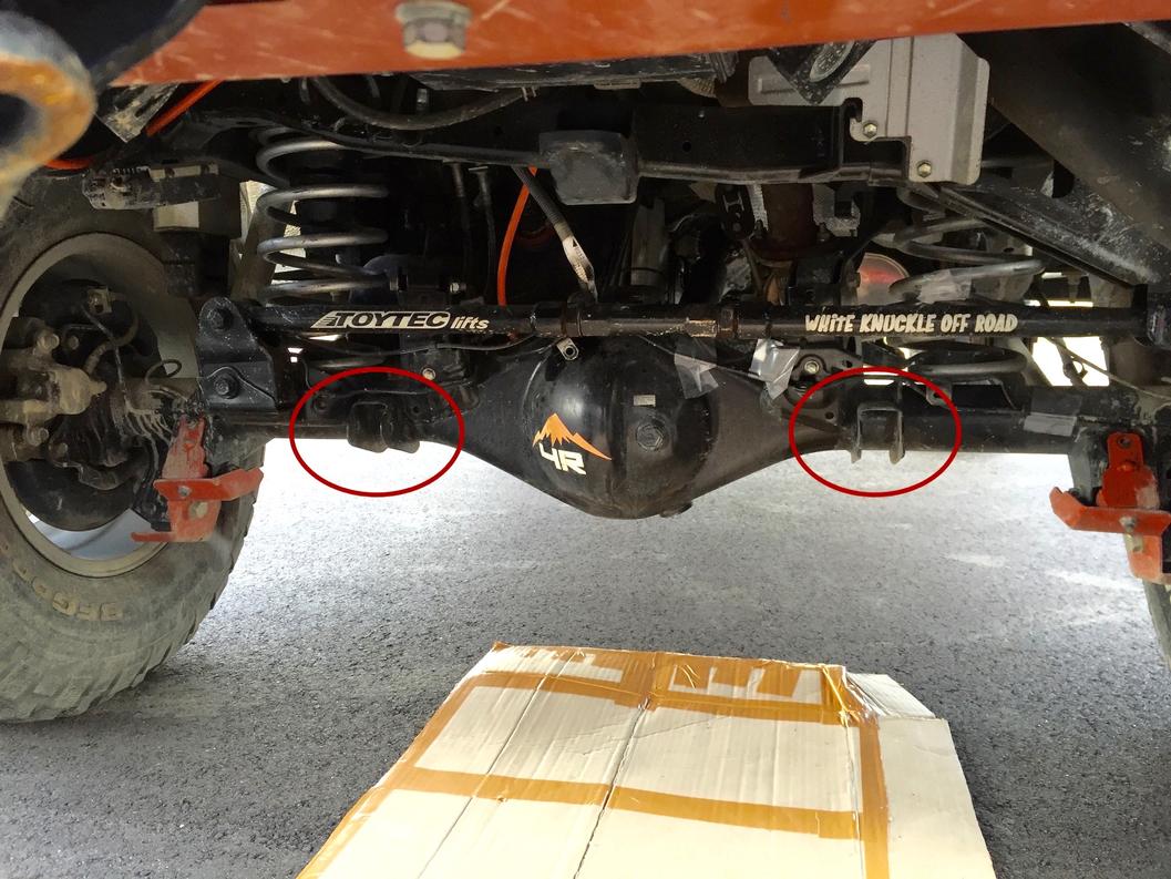

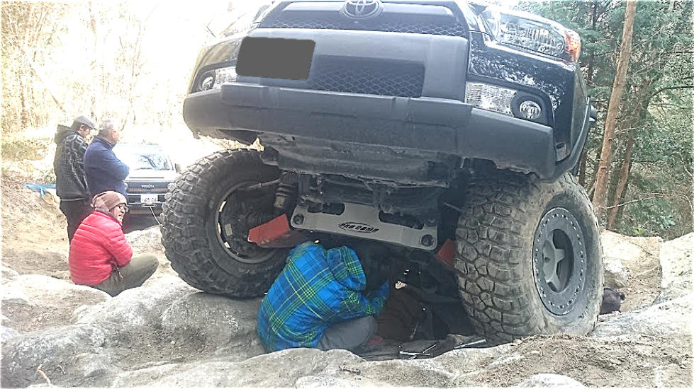

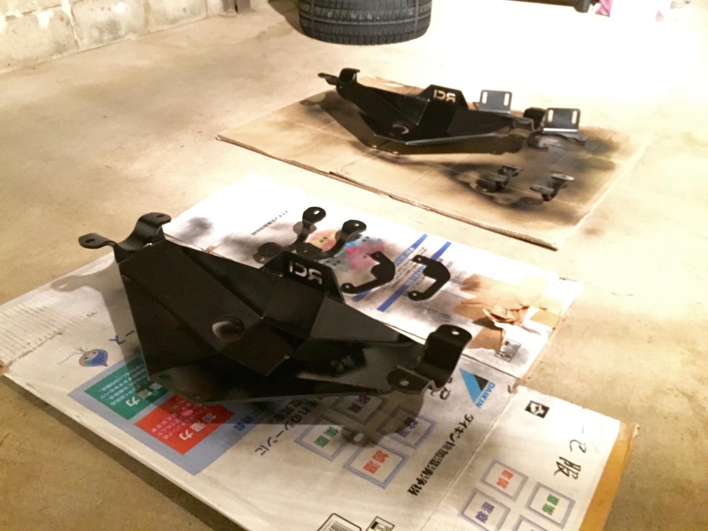

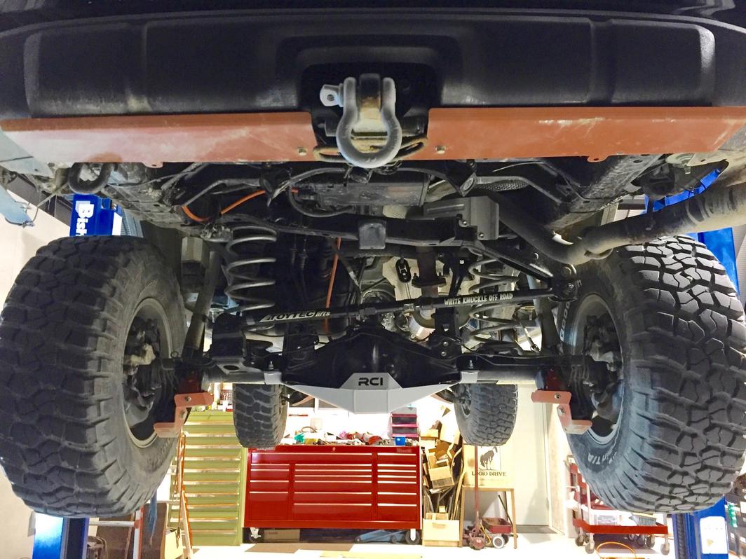

RCI diff skid
I installed the RCI didf skid. Removed by cutting the mount of KDSS.
I was hit in the rock several times, but the problem does not occurring.

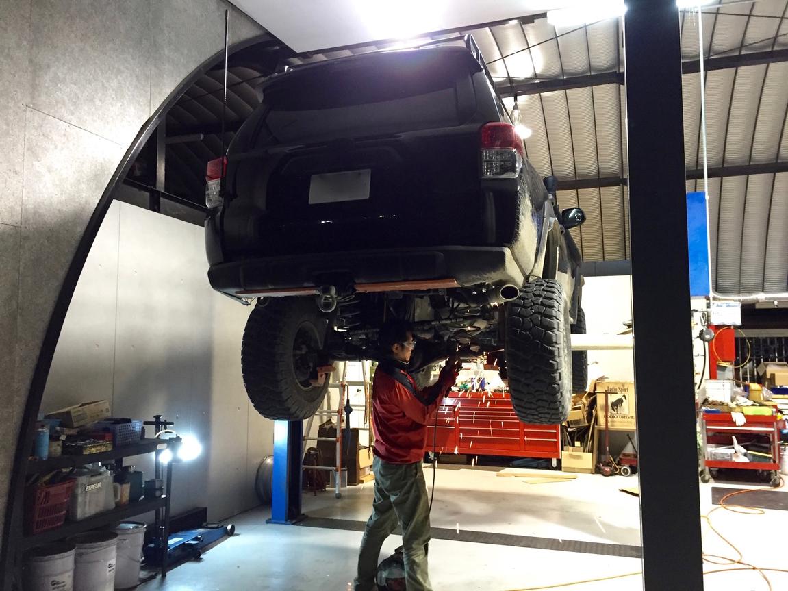

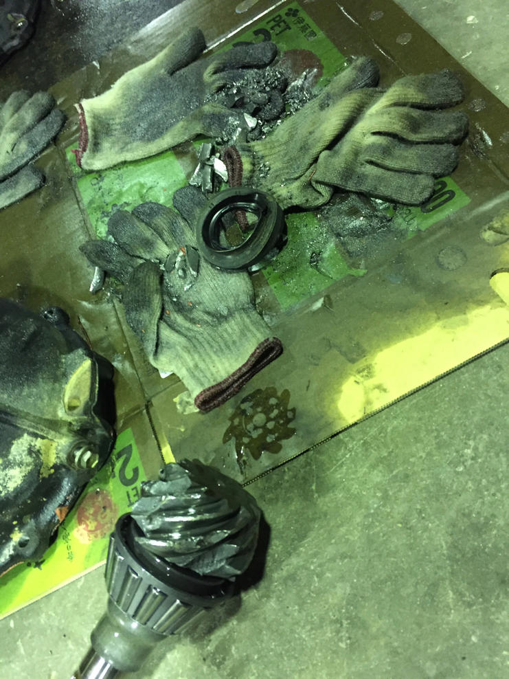

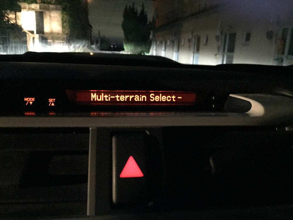

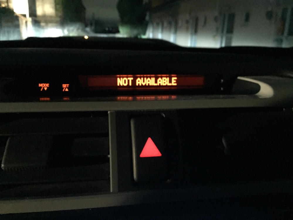

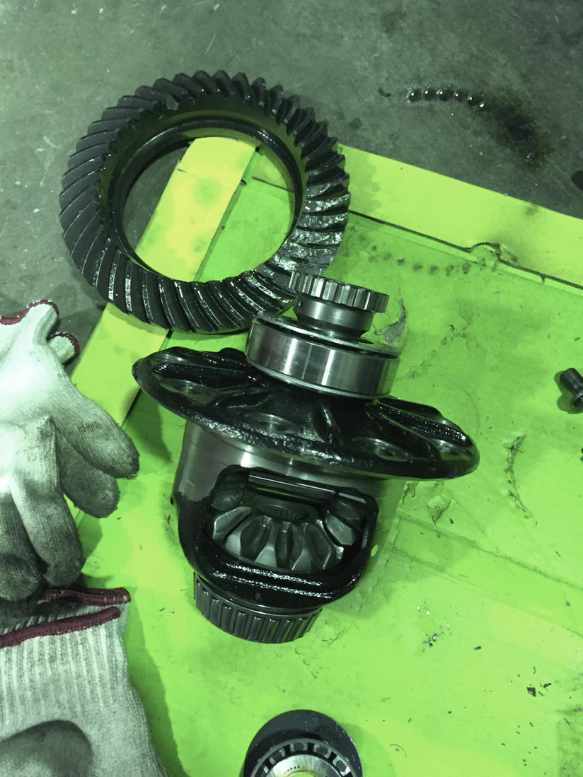

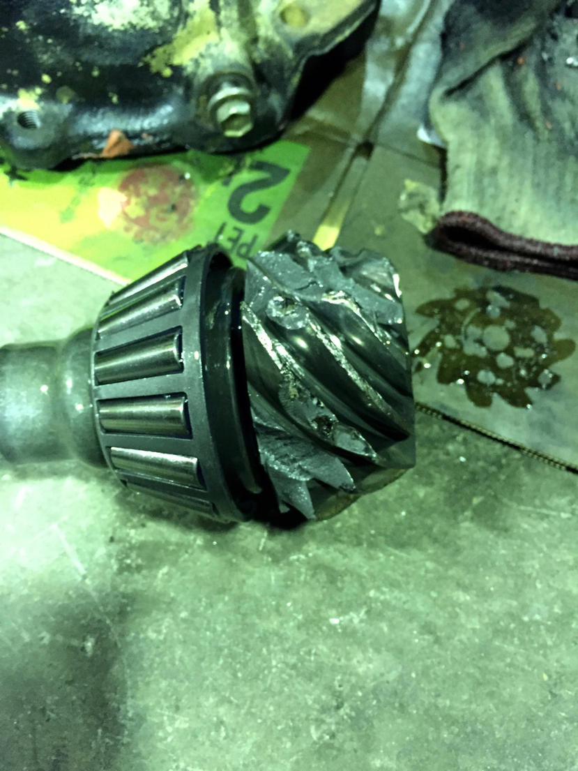

My 4runner had broke the front differential gear and multi-terrain system .

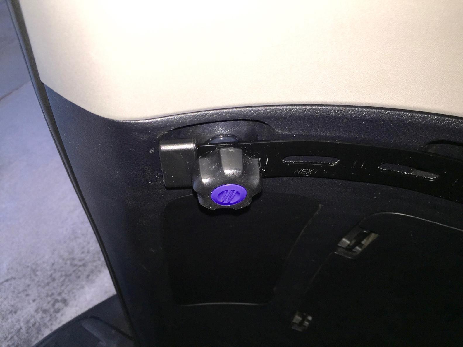

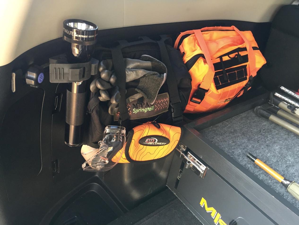

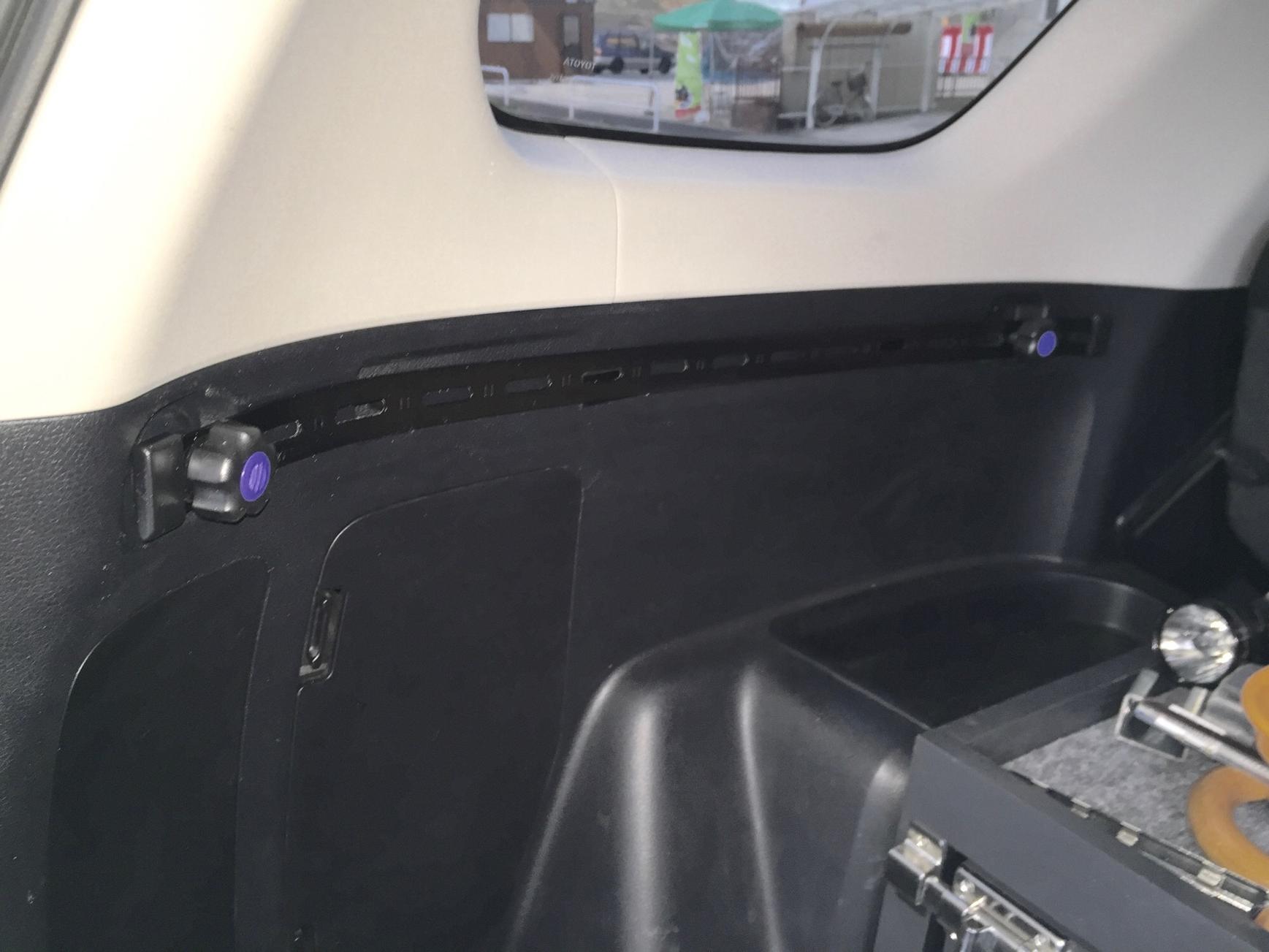

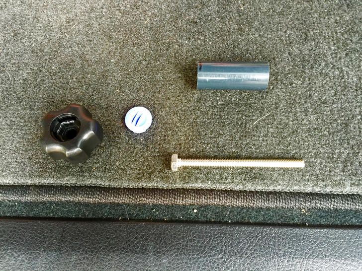

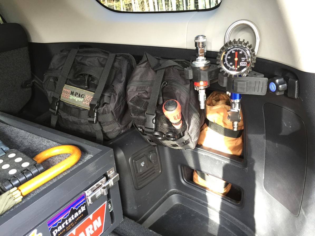

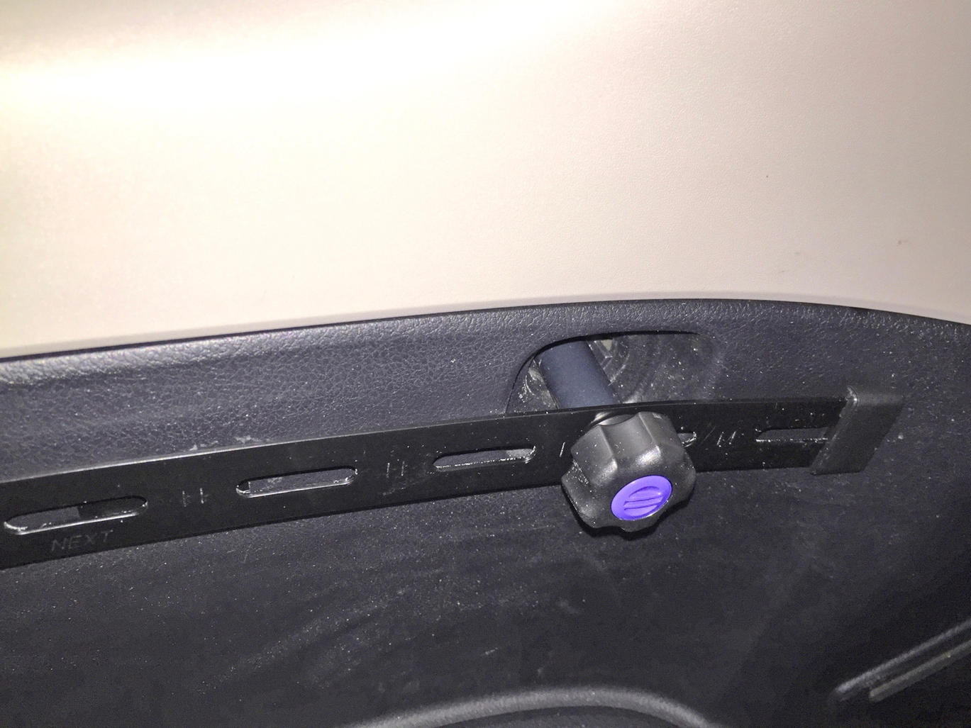

I want to know more about that interior setup!
I would love to get some drawers and storage solutions like you have-

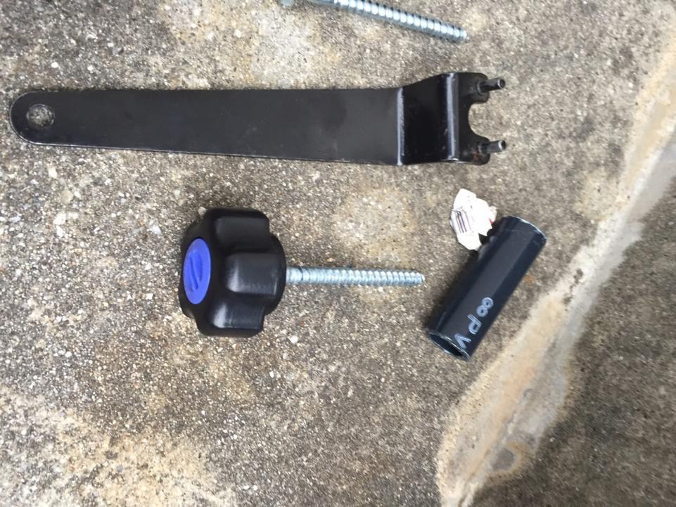

What did you use for the knobs and track for the rear trunk setup?
Details Bruh! I dig that

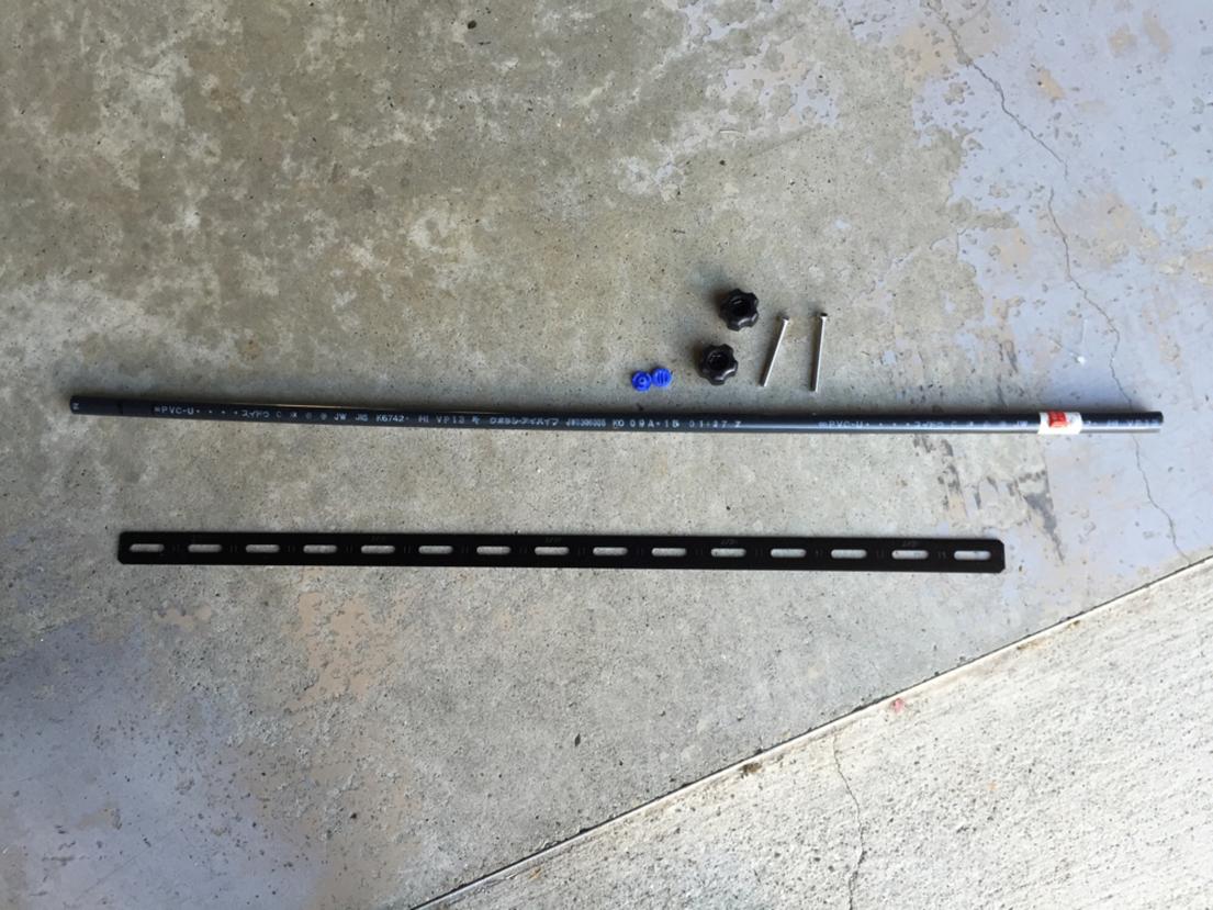

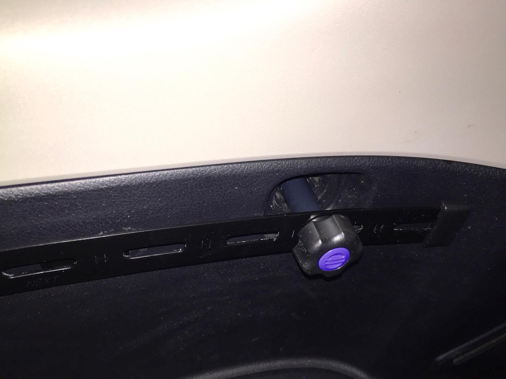

These are that I'm used for cargo room custom .
steal plate 700mm x 400mm x 2
hard pvc pipe 45mm x 15 mm x 4 .
knob nut x 4
M6 1.0pitch 65mm bolt x 4
Please adjust by bending the plates.

Front gear broken when I was running rock trail with friends. Perhaps, my car's gear had been exhaustion accumulated.:sad:
We're those the original gears from Toyota that came installed with your T4R or were they upgraded?
