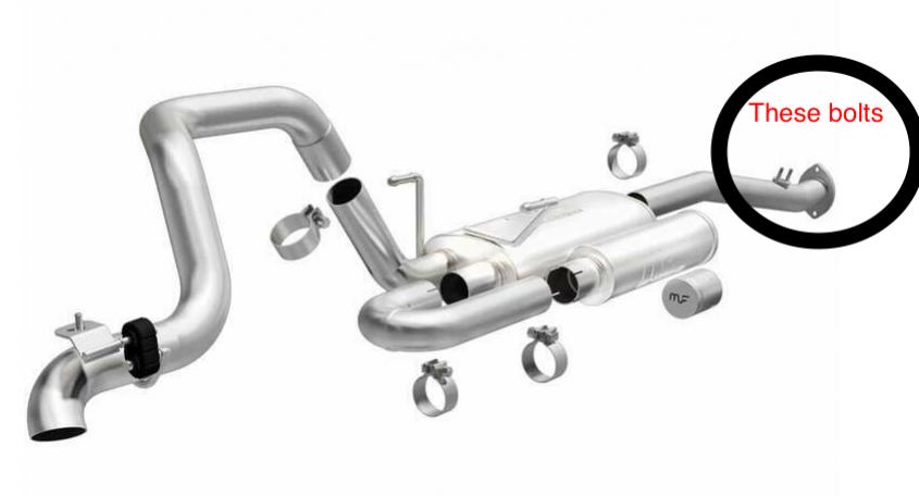

I do have a question: are they shipping with flange gaskets? I also assume we are to re-use the bolts? Reason I ask is that, although I have been blessed with a nearly rust-free example of a 4Runner, what little rust there is, every fvkin bit of it has congregated on the flange bolts. They are soaking in PB but wondering if they will come apart as designed or will i drill out and replace.....

they are shipping with a new gasket. no bolts except one for the new exhaust hanger.

Yes, there's a flange included for the cat end. The rest of the exhaust is clamped. The O2 sensor does not have a seal with this kit. No hardware outside of the rear mount for the frame.

My kit will arrive tomorrow. Yee HAW! These are the bolts I was wondering about. Hopefully PB will do its job.....
